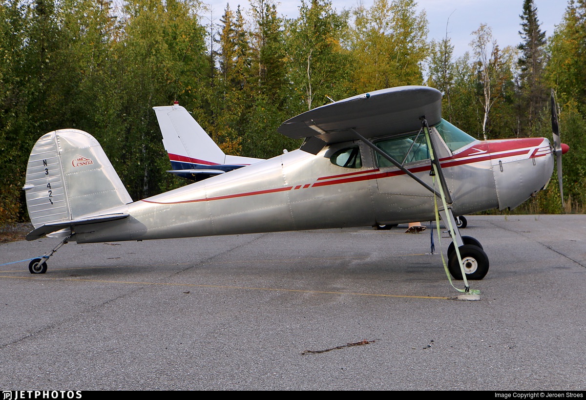

Are there any technical sheets / blueprints, etc that show the exact markings and placement? I did find an original pattern on one that was within 43 of the serial that must have been made within a few days of each other. My serial is 15064. Below is a pic of 15019.
I have also noticed that even with types made within the same batch, there seems to be slight variations on the striping. Did they have modest deviation on the assembly line in a run?
What I would like to find is some kind of technical print that shows the markings. Any help or suggestions is appreciated.

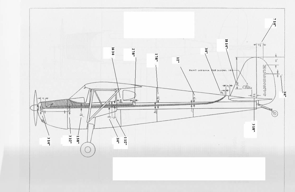

This used to be in the site library.
David Freeland - CFII

Thanks guys. This helps. I have decided to cover the wings with the Stewart's system. The diagram measurements can hopefully be adapted as well.

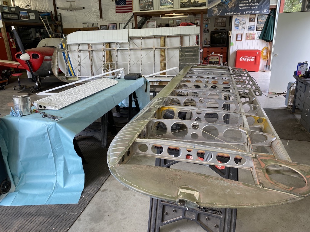

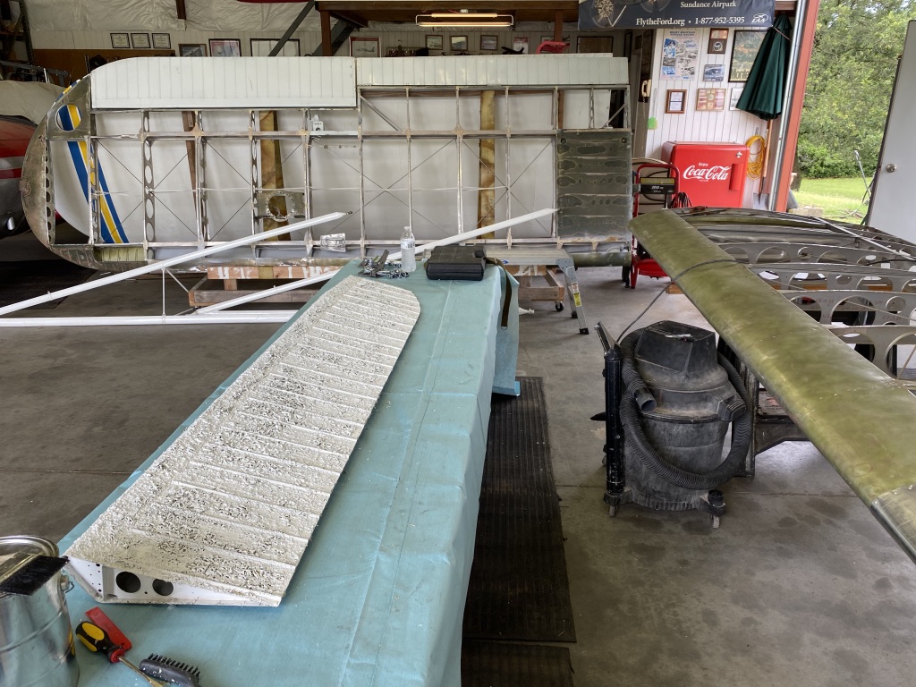

10 Jul 2020 - Back to the wings. While waiting for the Stewarts system stuff to arrive, time to do more mindless paint stripping. This time the ailerons. Those folds and rivets on the surfaces are not cooperating and it is slow go. While 95% comes off, that last 5% is no fun. But hey, there are only 2 and only 2 flaps. Should have them knocked out soon. Steve

I found that using a stiff plastic scrub brush and red scotch write pad get that last little bit of stubborn paint off.
Do it with the stripper still on and use it more ore less as a lube.
While the wing was opened up I took all of the cross brace wires out, cleaned off all corrosion, primed, painted and reinstalled.
I also replaced all corroded steel hardware.

8342 wrote: ↑Sat Jul 11, 2020 7:05 am I found that using a stiff plastic scrub brush and red scotch write pad get that last little bit of stubborn paint off.
That's pretty much what I have been doing. And as you can see from the tools on the bench in this pic, that your advice is spot on. The fuselage was alot more than this but the reinforcing ribs in the aileron surface, combined with the rivets, make for slow go.
I'll take a look at the bracing wires. Not a bad idea. I am guessing they would need a correct torque though? Or some sequence?
I also intend to add bracing cross tape. The donor wing in the background had it, but it may have been from a recover earlier. Both wings appear to have had the Stit's and Ceconite. Mine will now have the Stewart's and the Superflite 102 fabric.
I am also trying to find a Grimes swing down light for the left wing. Found a good one in Alaska but waited too long and it was gone. Was even converted to LED. Still looking while there is time. Steve

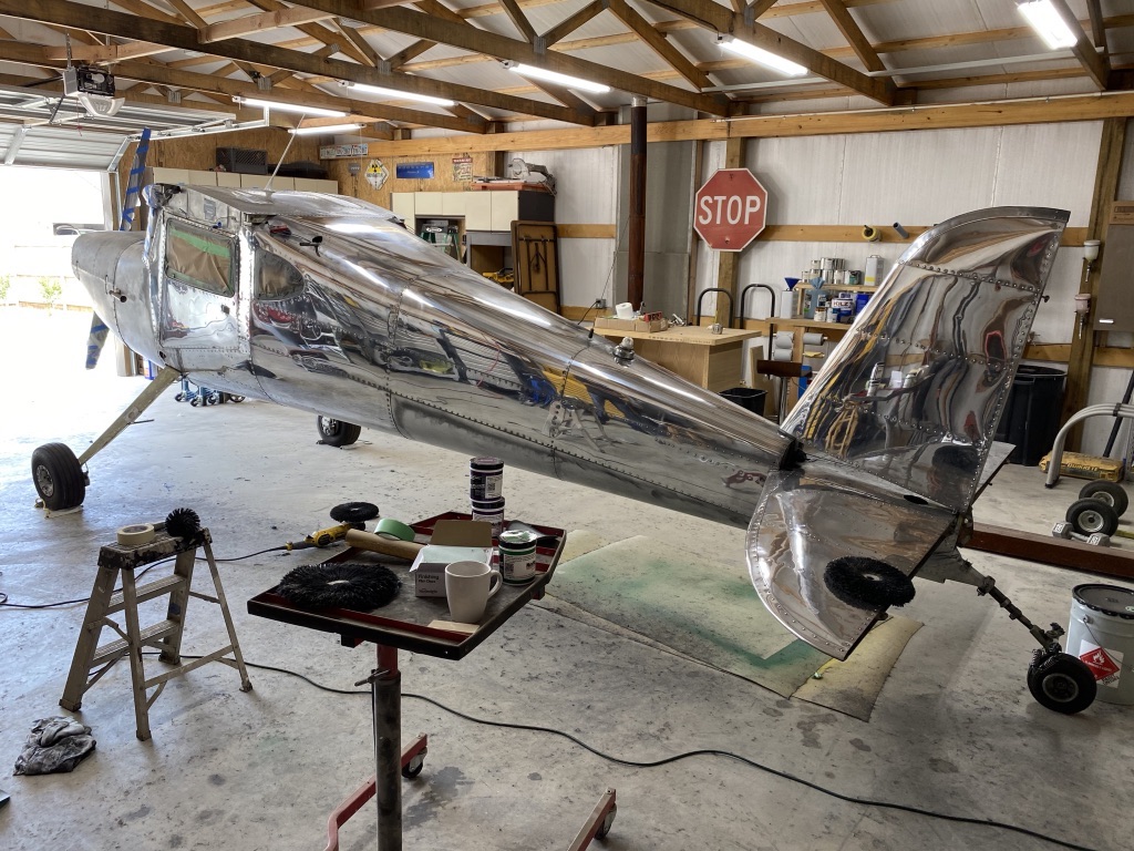

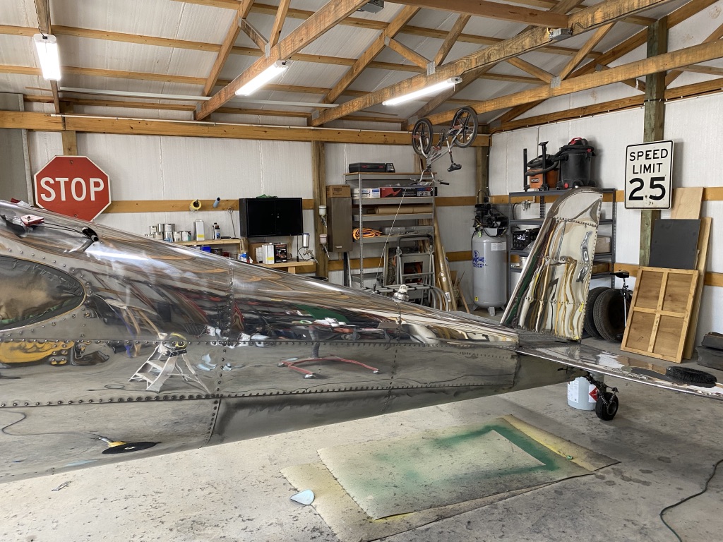

16 July 2020 - Fuselage work and buff out going well. Many thanks to Matt Nichols for this work. He offered and I gladly accepted and it allows me to work on the wings. I think I am going to like this look. Steve
