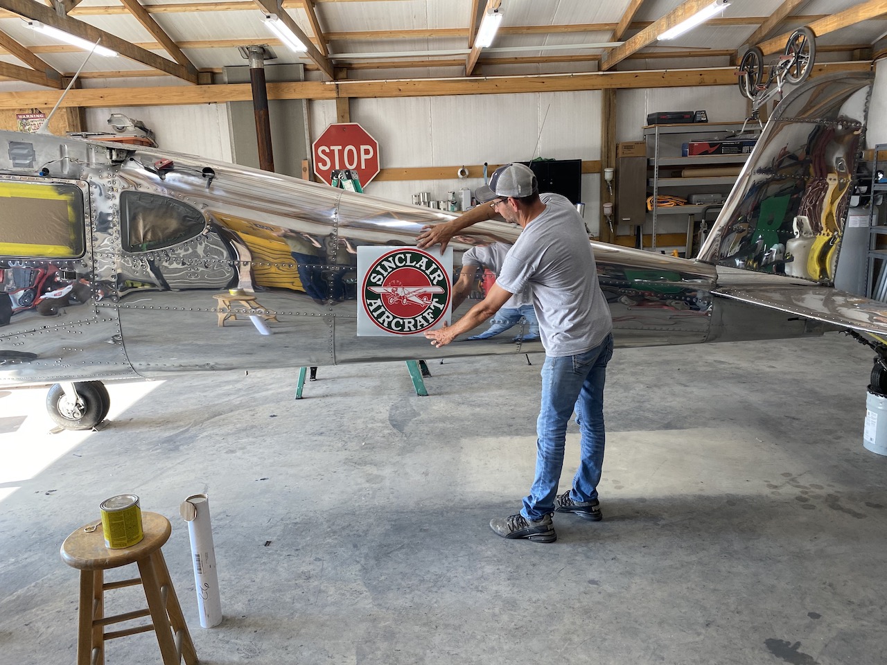

Time for an update.
25 Aug 2020 - Both sides of the fuselage are finished. Still a bit on the top that remains, although the cowl area will not be buffed as it will be painted in the factory red trim.

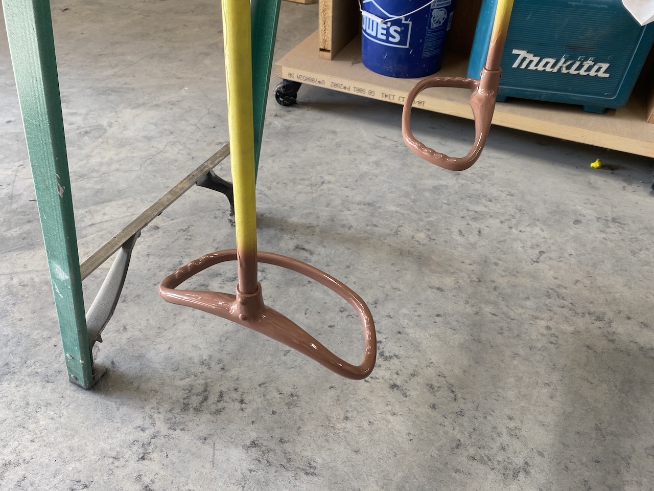

We received the custom 18" Sinclair decals. They look nice and are just the size we needed.
Matt also painted the yokes the 1940s color. This will match some of the instrument panel knobs as well.
More in next post...

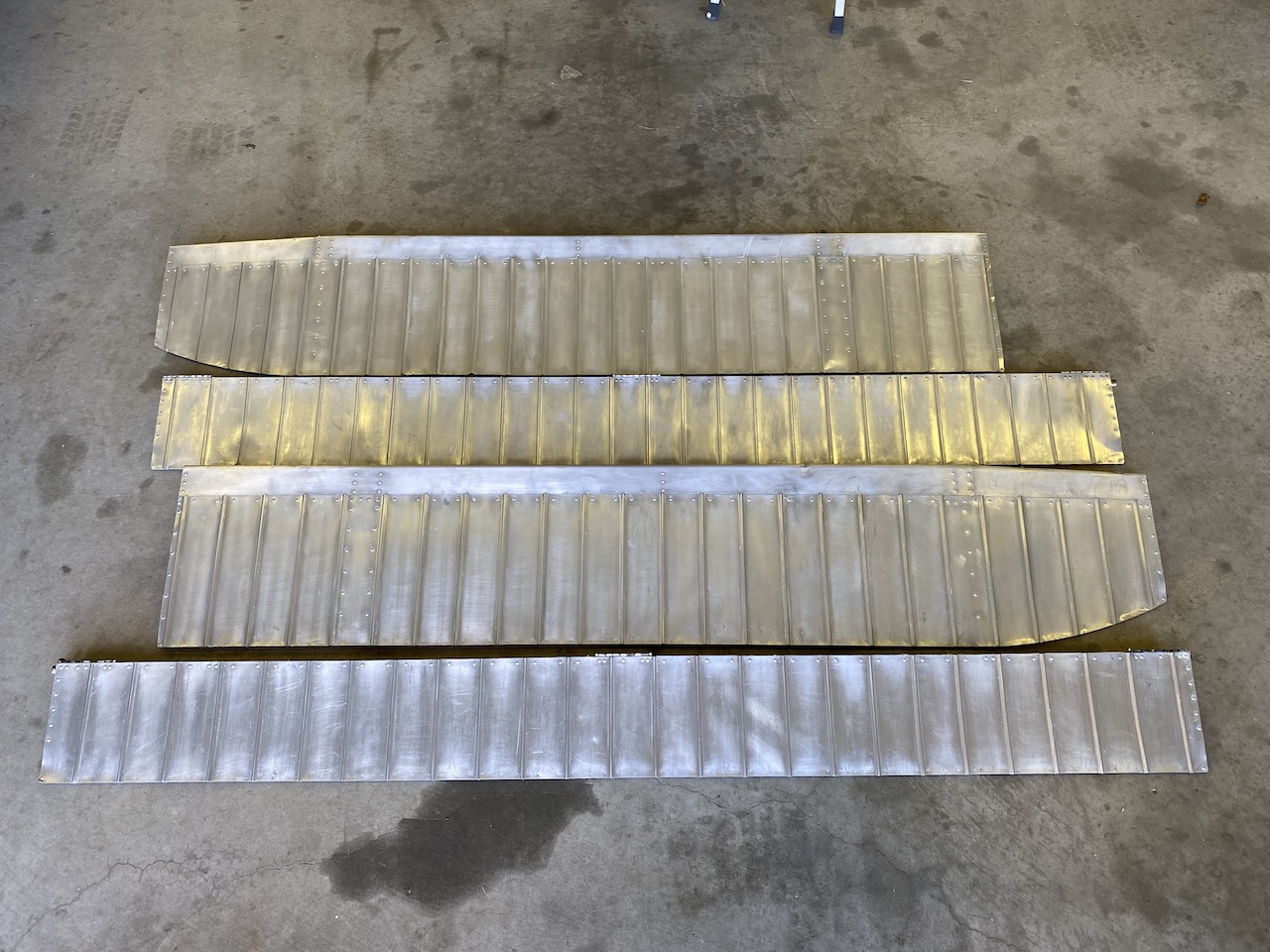

5 Sep 2020 - Finally! All the wing control surfaces are stripped. They will get a light buffing to match the top of the plane. Only the two elevators remain to be stripped, then it is wing prep and covering time. Slow but sure, Steve

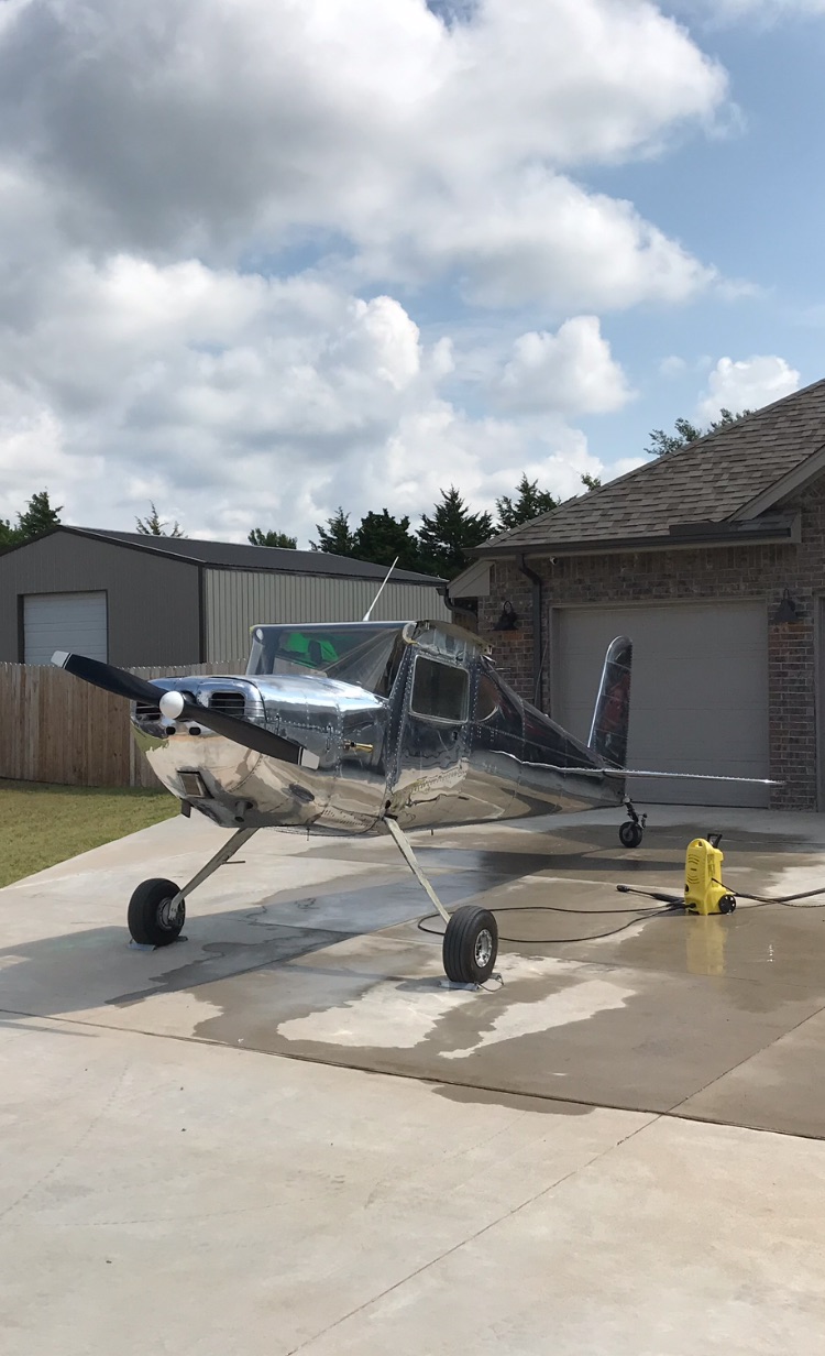

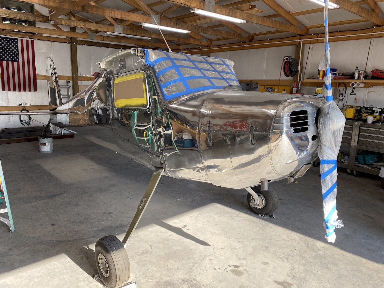

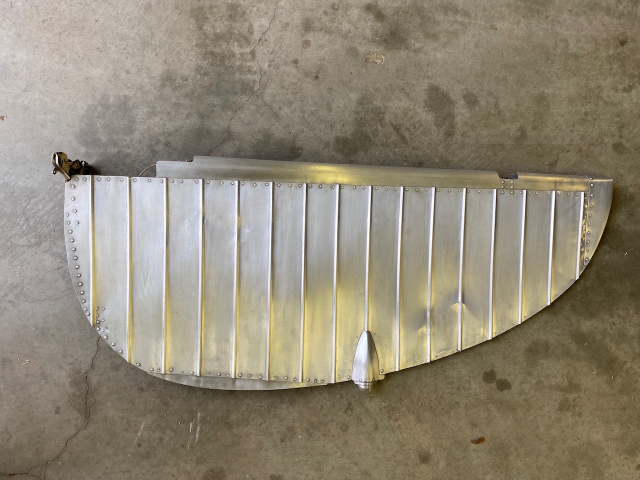

15 Sep 2020 - Matt pulled the wingless plane out for a rinse to get all the residue off. It is looking really nice. Ready to prime for paint trim.
18 Sep 2020 - Got the Rudder done. Needs to be buffed along with the ailerons and flaps. Two elevators to go then nothing exterior has paint left on it.

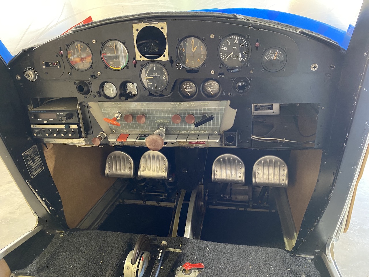

A panel question: Is there any way to remove just the knobs of the control panel? I really do not wish to disconnect every cable to remove the plexiglas panel behind them.
Am I missing something or are the knobs permanently crimped to the cables?
Thanks for any assistance. Steve

You will have to remove the entire cable assemblies. Just removing the knob will not allow you to remove the plexiglass panel.

2356 wrote: ↑Tue Sep 22, 2020 10:13 pm You will have to remove the entire cable assemblies. Just removing the knob will not allow you to remove the plexiglass panel.
Sad Face. Any recommendations on how not to mess up what was a working system of cables, controls and instruments? Steve

If possible take a lot of pictures. And make of notes of how they are run.
