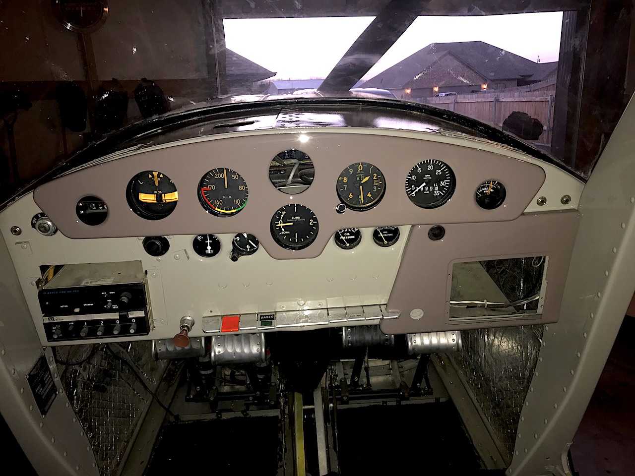

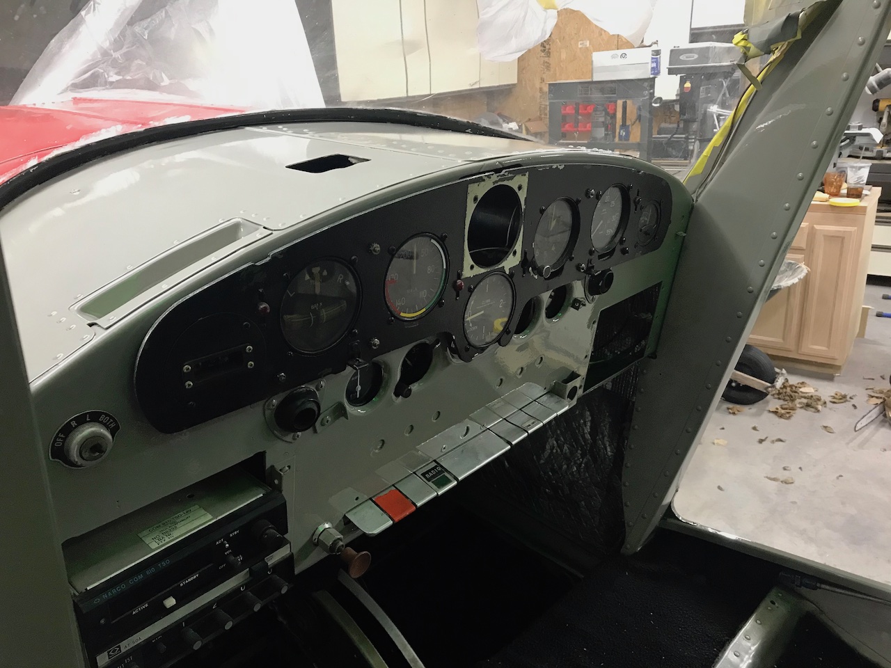

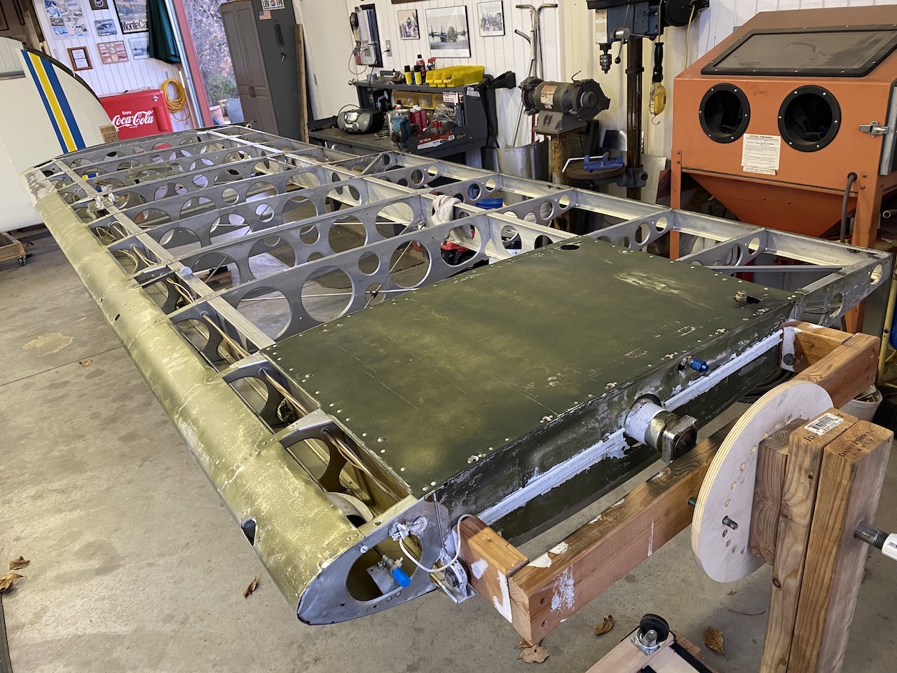

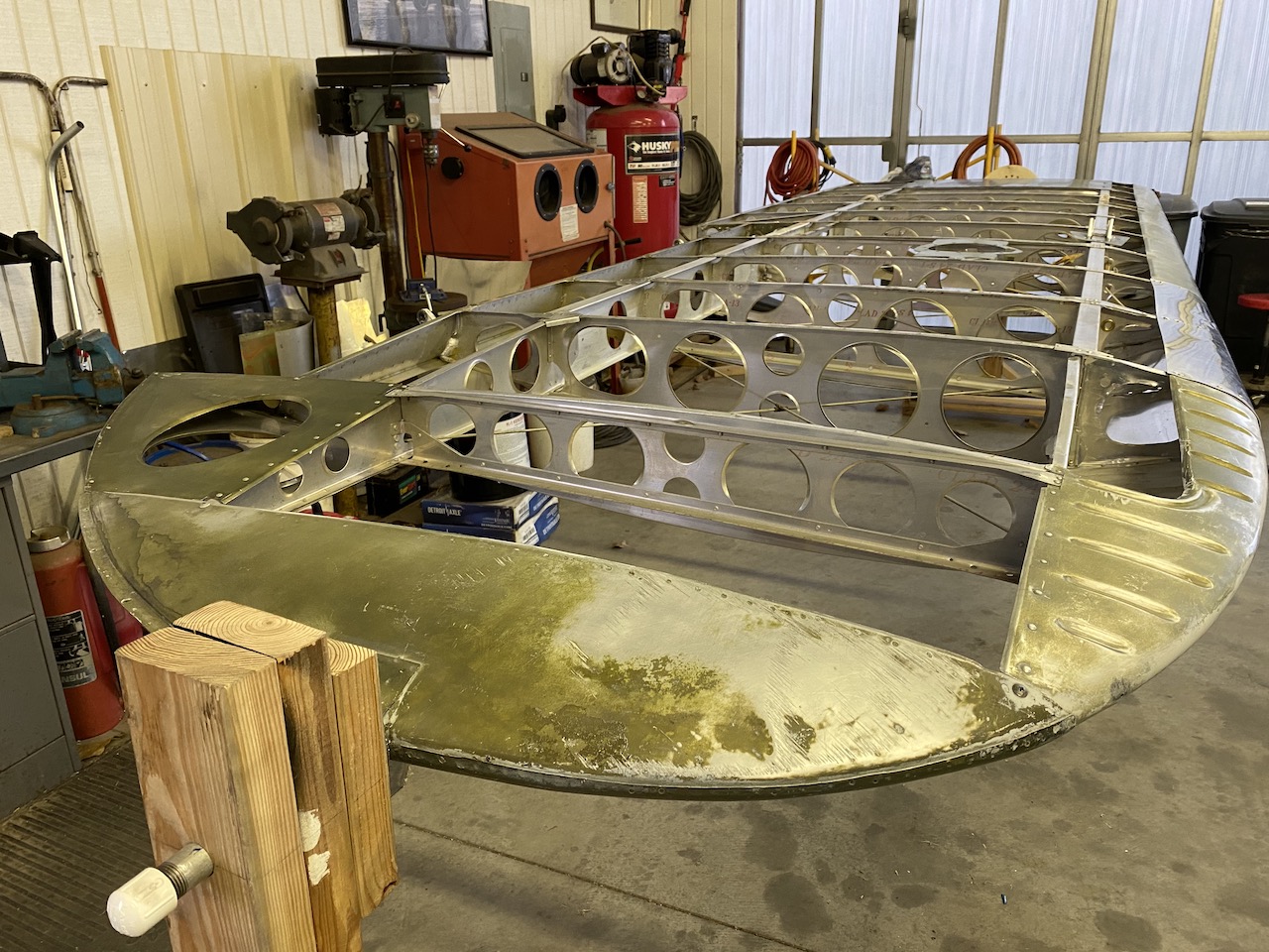

14 Nov 2020 UPDATE: - Wing work plodding along. Never knew so much old fabric bond would take so long to remove. Almost ready for the zinc phosphate spray on leading & trail edges and gas tanks (basically anything that was originally zincked).

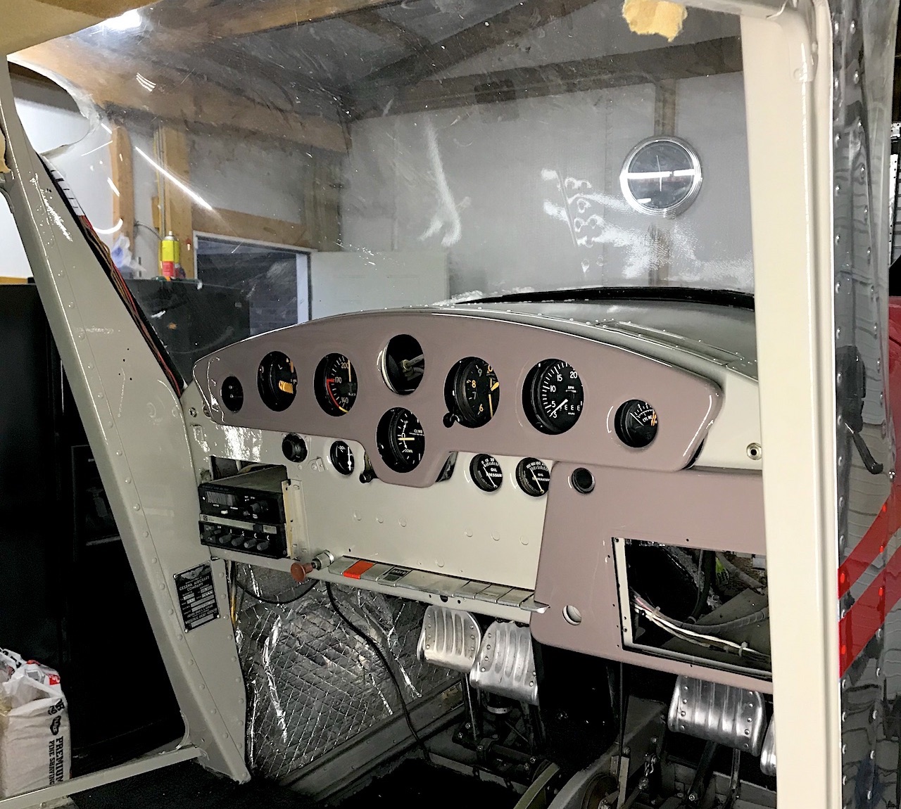

The interior is coming along nicely. Matt had a chore to find someone to mix the panel cover formula. It's a PPG formula. I guess with O'Reilley's now serving as the local paint mixer on metal paints, no one can or wants to do Pittsburgh paint formulas. At any rate, we finally found a mixer in Norman, OK. Turned out great. The gooey, rough carpeted top looks like new along with the interior sides, doors and interior frame.

....UPDATE 14 Nov 2020 continued - The panel itself is a nice French Silver Gray now. The panel covers are India (whatever that is) but once again, Lorraine Morris was a superb help in giving us the special mix formula of the scheme to match the original 1948 color. The panel covers are only only slightly tacked on rather than set in the pictures and the Plexiglas panel and cables are not installed. Still, the results are super exciting. Doesn't even look like the same interior.
Project is definitely gathering momentum. Steve
