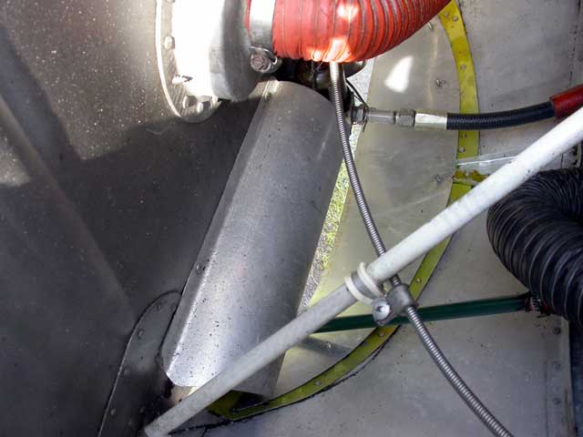

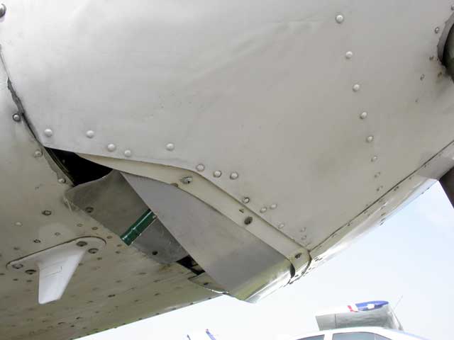

Ok, as promised here are the pics of my lip arrangement.
The first pic is from outside, and below. The second pic is from inside, and the top. There are 2 round lips as the one shown, each side of the gascolator.
I bet you never saw a 140 equipped that way ! With an outside air temp of 43 deg.F at 2400 RPM last fall, I had 140 deg.F of oil temp., EGT of 1400 and CHT of 300 (both single point) and they always seem to be around these values, only the oil temp increasing a little.
My AME kind of likes the lip but is thinking about replacing it with a more kosher one... thus my original post.
MichelC (ex-caretaker of C-GNCJ)
I find the curved firewall mounted sheet metal interesting. RV fliers round this exit on the lower firewall with a noticeable increase in speed. The sharp corner apparently provides a fair amount of turbulence and therefore drag.
John von Linsowe

Michel
That looks more like some sort of strange attempt at streamlining than anything else. The "lip" we've been talking about is a small strip of metal that hangs out in the wind to add suction at the rear cowl air exit. Your installation is very very different.
As you said your plane is harder to heat up than cool, I'd either remove the mod and not install the cooling lip, or just leave it alone if it doesn't cause any problem with Canadian regs.

Joe Mortland » Mon May 30, 2005 6:32 pm
If anyone were to ask me what that rolled sheetmetal, on the firewall was, I couldn't even BEGIN to give an answer! Maybe it's to help prevent vaporlock?
