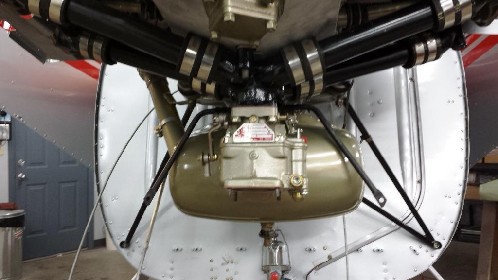

Carb
Carb

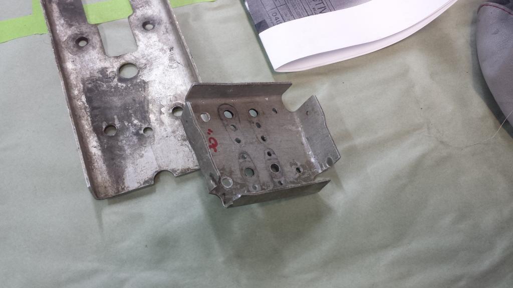

Pattern piece for rear bulkhead reinforcement AD that needs to be incorporated.

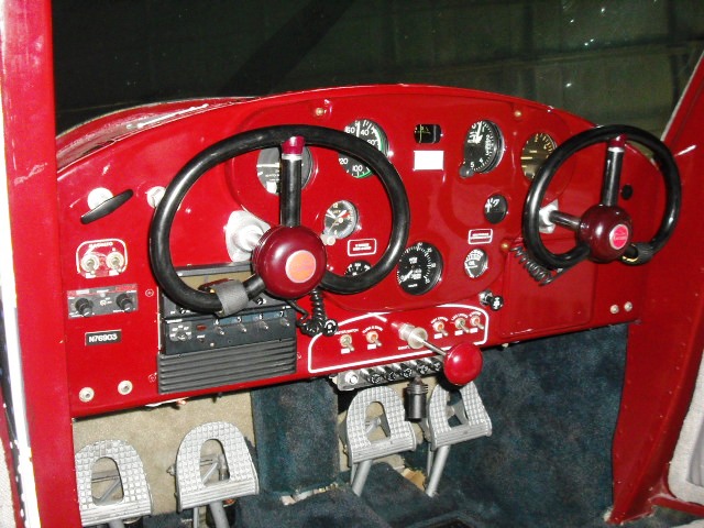

Your panel looks familiar.
5528 » Sun Dec 22, 2013 1:28 am
I turned my control wheel in the up position. Much more comfortable for me and provides more leg room. Painted the inside of the panel surround white and then installed the original back lights. They work real good and look very cool.
Panel Picture
Panel Picture

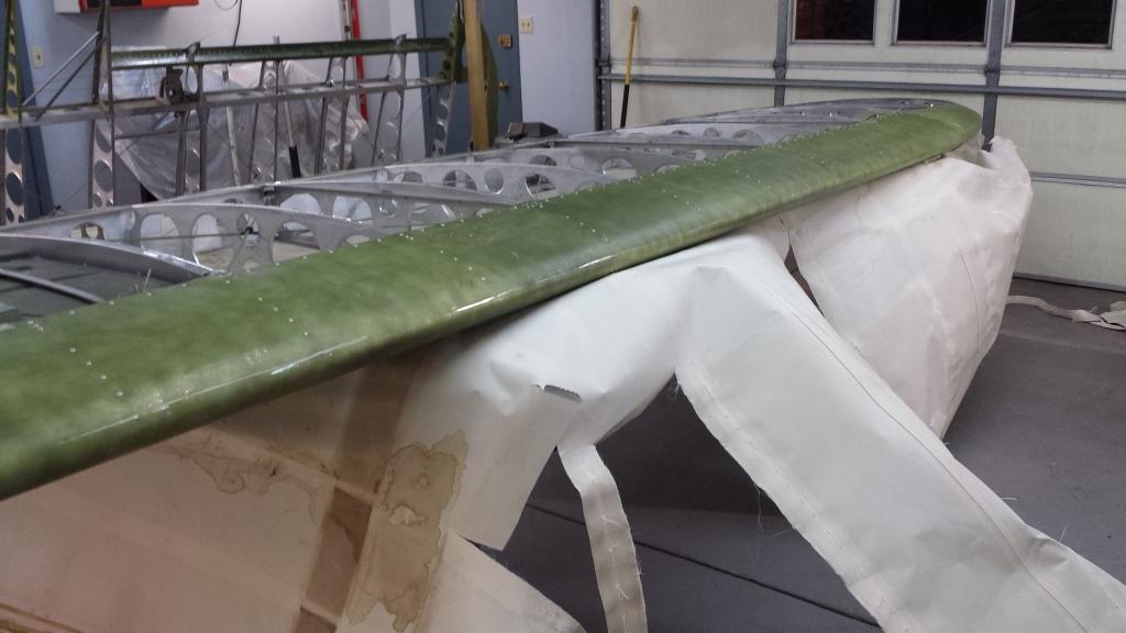

Kazoo120 » Sun Dec 22, 2013 12:23 pm

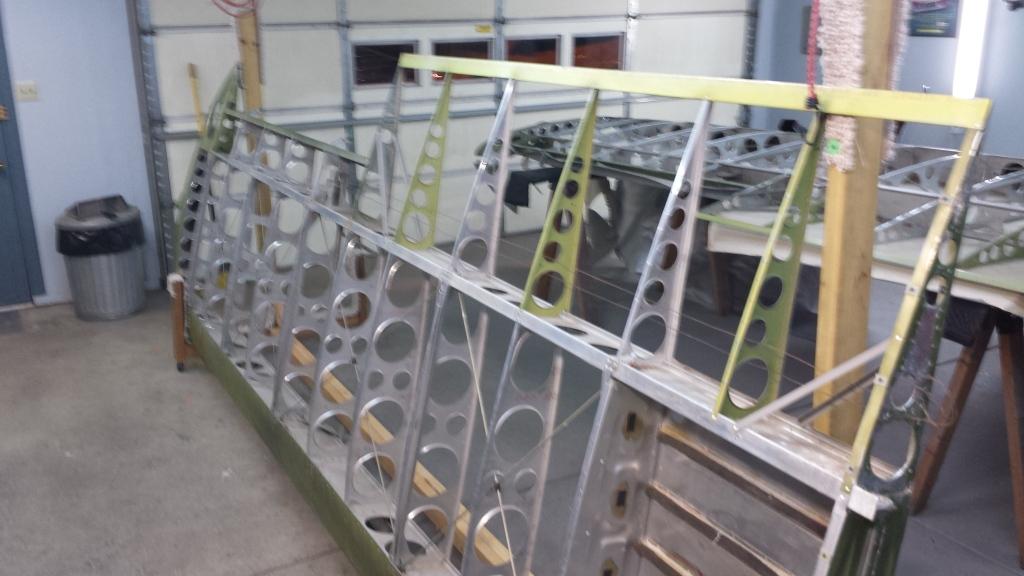

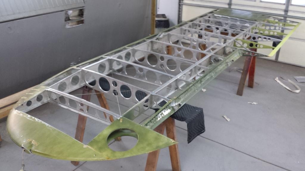

Back to the wings, removal of the old covering. It's actually a darn shame to think that this old Ceconite never saw much flight time. The logbook shows that the wings were totally re-covered in 1967 and the last annual was then 1968, and then she was parked for 40+ years. But off it comes. Structure looks great, just some AD's to incorporate, rebuild the tanks, and we'll be ready to recover and go!
In the rack.
In the rack.
Down to the frame
Down to the frame
Pulled Ailerons first
Removing in a careful manner to preserve the old material as a pattern for some inspection hole and other locations

Working to install a tail fin reinforcement piece per AD. Goes on the rearmost bulkhead. We fabricated a 2024T3 piece but the first attempt didn't catch the #6 rivets at the tail on the sides. We'll revise the piece a bit and try again.

Pattern piece we used to make the "Cookie Sheet" for reinforcement
Almost got it, sides need to be abit longer to catch the existing rivets. Should have it at the next attempt.

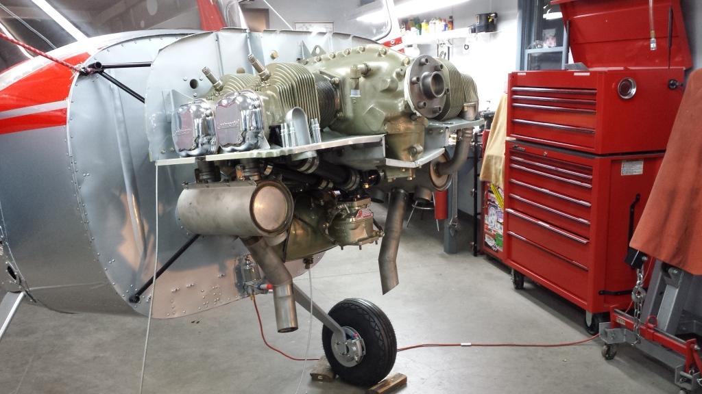

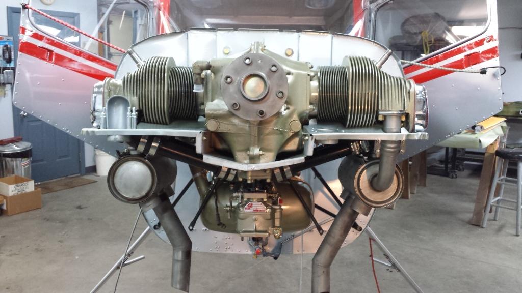

Kazoo120 » Thu Jan 23, 2014 9:46 pm

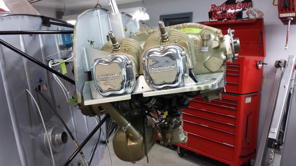

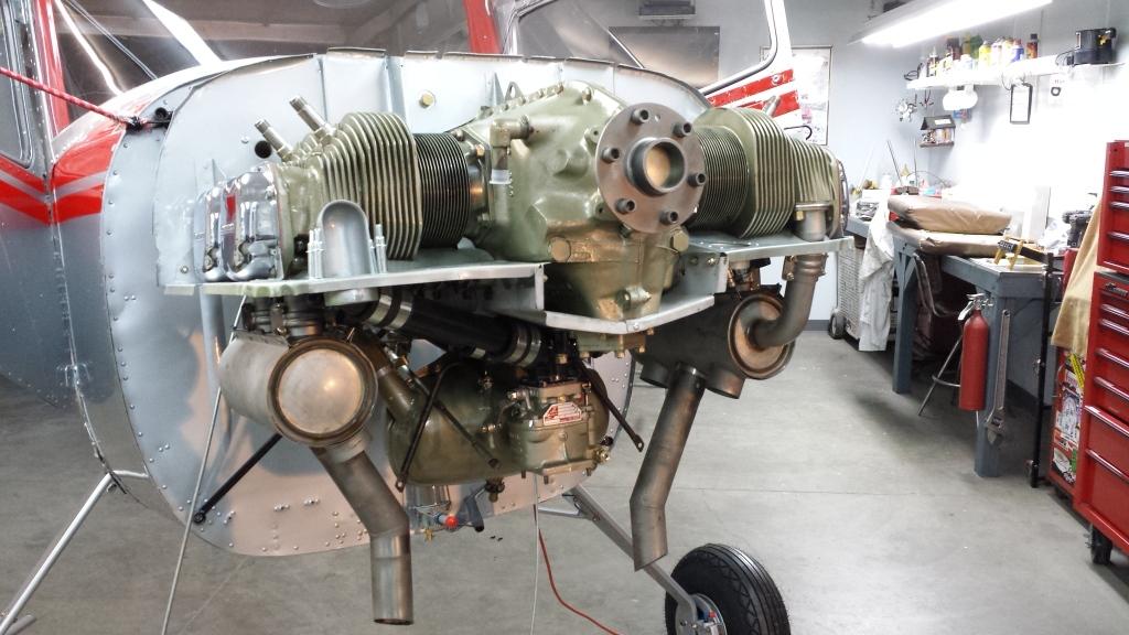

Finally some progress to report! It's been slow since the holidays and early 2014. We continued the engine assembly onto the mounts, and working on wiring. Hung the mufflers and torqued all the installation bolts etc. (Still bending up the rear fin reinforcement "cookie sheet" piece, it will be ready soon.)

Engine assy 1
Engine assy 1
Engine assy 2
Engine assy 2
Engine assy 3
Engine assy 3

Randy Thompson » Thu Jan 23, 2014 9:57 pm
Looks like an O-200.
A&P IA. Holder of STC for O-200A's in 120, 140 & 140A's. Engine overhauls on C-85's ,C-85's with O-200 crankshaft, C-90's and O-200A's
State Rep for California
Kazoo120 » Thu Jan 23, 2014 10:09 pm
It is! It's the one from the "O-200 rebuild", in this forum, Don Irving's original project, however he decided not to finish the plane it was going into. Your STC! A.

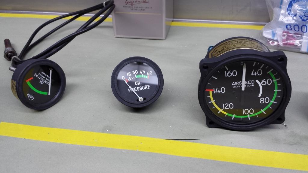

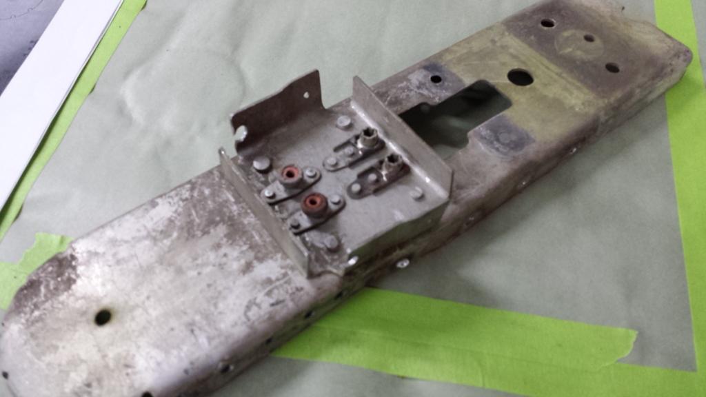

Kazoo120 » Sat Feb 01, 2014 10:02 am

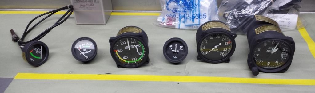

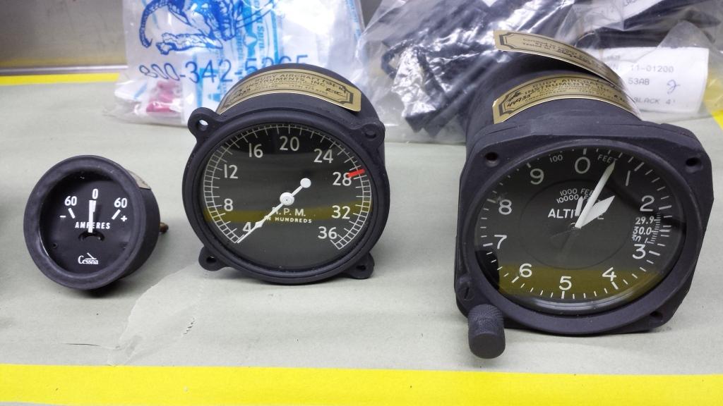

Gauges returned from refurbishment! Rudy's in Rudy Ark. did the work. Faces all re-screened, and paperwork to return to service. Still need an electric Turn coordinator, and VSI to fill in what I want for the panel. Need to do a small repair to the aluminum mount, just want to clean up the 7:00 Altimeter nob location a bit, it was carved out at some point in the history it appears, just needs a bit of cleanup.
Lots of electrical pieces on order this week, planning to move ahead soon on that.
Winter remains in full force this weekend, 4-7" coming today. Perfect to work on the 120, in the warm shop!
6 gauges restored
6 gauges restored
close up
close up

Just a little repair needed.

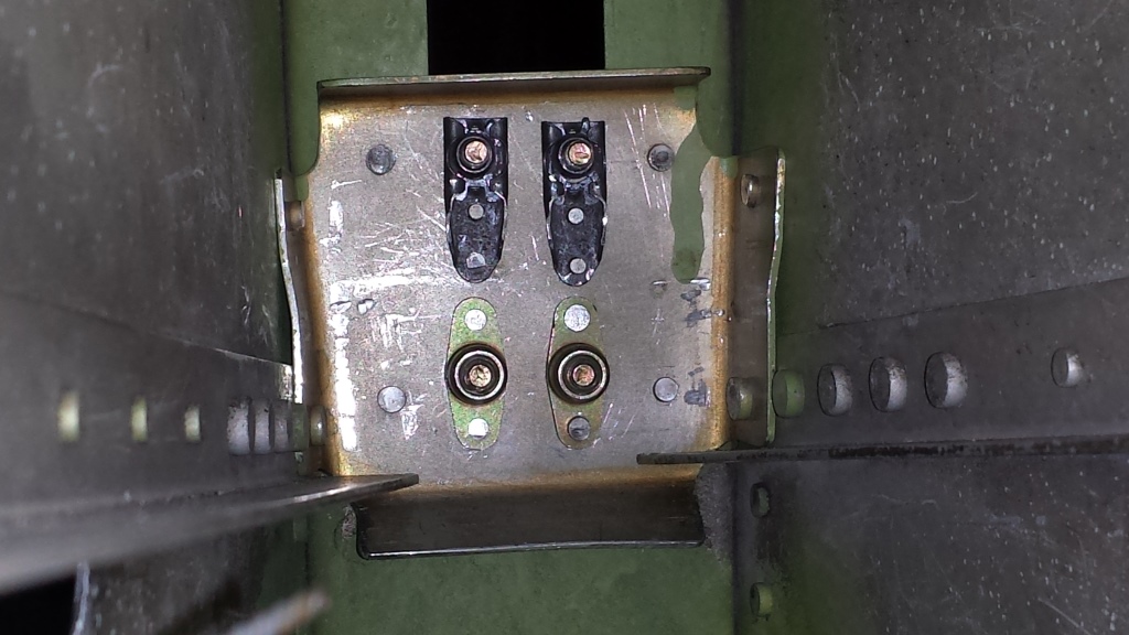

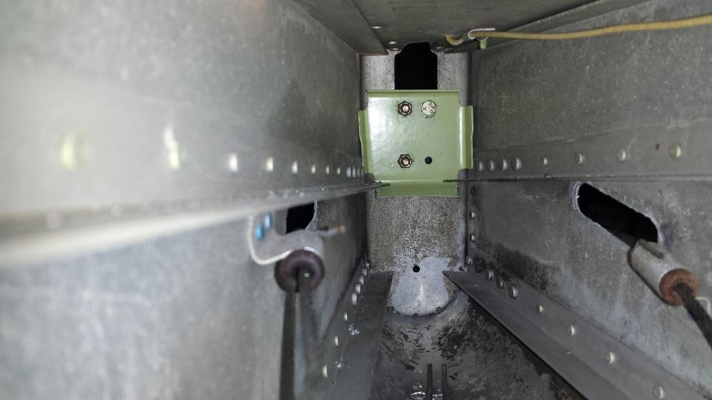

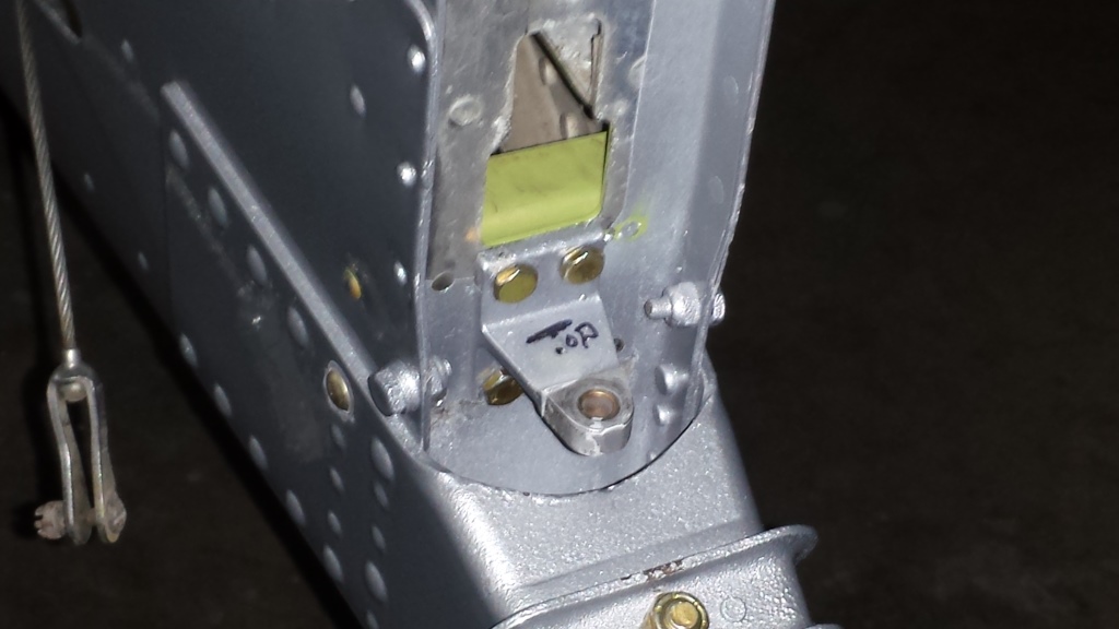

Finally some more progress! Finished the installation of the rear bulkhead reinforcement.
4 bolts now
4 bolts now
View looking aft
View looking aft

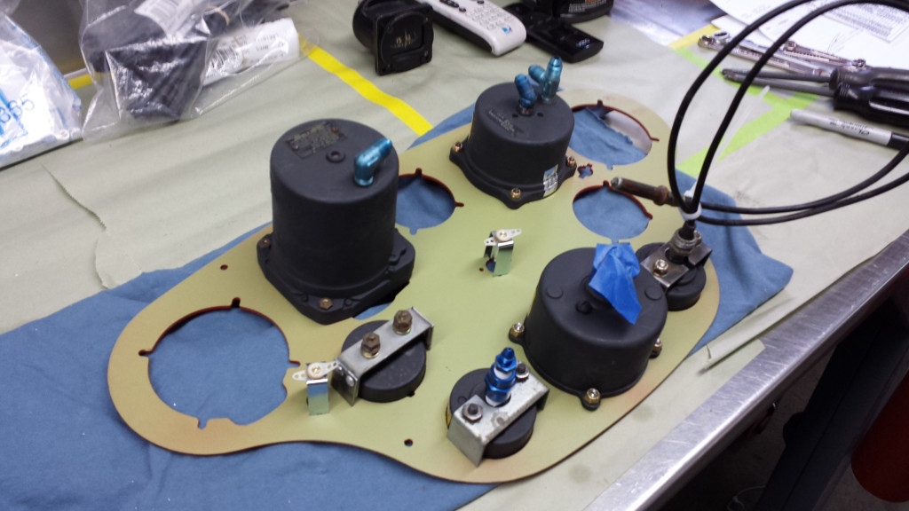

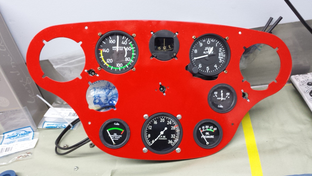

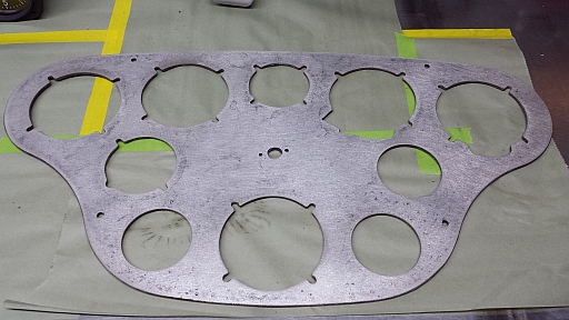

Working on the gauge panel, this is fun stuff, gives "Visual Progress". I still want to add a VSI, Turn Coordinator, and clock to round out the optional gauges for the 120.
Also have the light sockets in place now, only had one light in the center as I found it, for some reason.
Panel rear.
Panel rear.

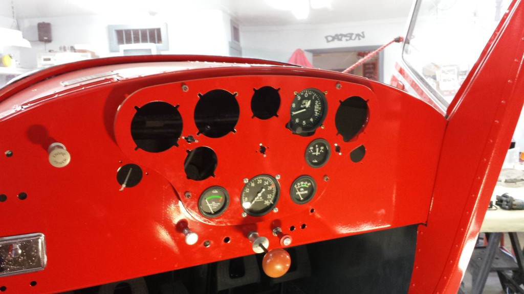

Panel front
Panel front

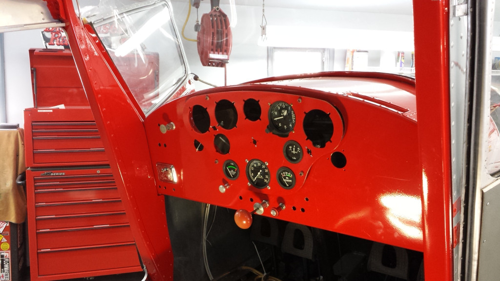

Temporarily in place, just to stare at.
Another view
Another view
