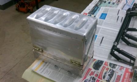

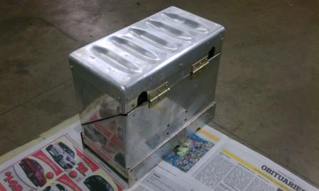

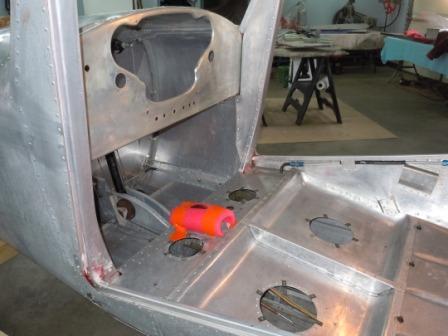

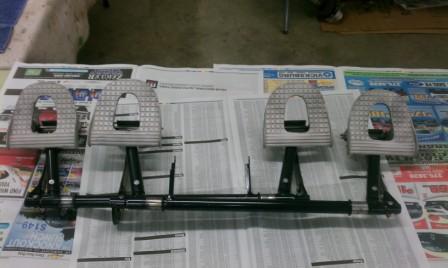

Pedal assembly is rebuilt. All new fasteners and painted. much freer than it was and turned out pretty well. Also finished stripping the battery box, and wondering what it was painted with from the factory,,,
The weather is improving up here in Michigan, may soon be able to begin some etch work on the fuselage.

Pedal assy completed
Battery box stripped
Battery box other side

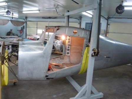

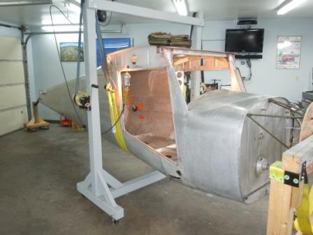

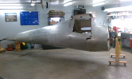

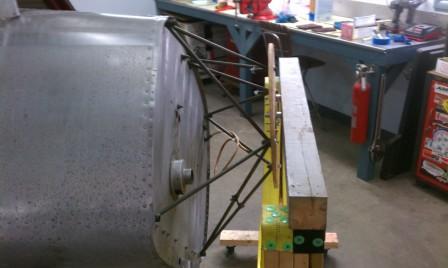

Built another piece of fixturing over the Holiday weekend. I was needing a way to move the fuselage out of the shop for further cleaning and something to hold it for painting. I adapted the smaller fixed sling that I had previously built, and made a rolling wheeled tail cart. This moves very easily now and I can tilt the fuse up to about 90 degrees ( I have fixed stops at 0, 45, and 90). As I mentined before, I seem to like to build fixtures! This one is cool, can now easily get to the top and undersides, and this will work very well for painting.
The weather is back to snowing this morning, no accumulation but a high of only 35 degrees today. So won't be moving outdoors for any etch cleaning for awhile again. Funny to walk outside while it's snowing, and hear the birds chirping in the morning, sounds like Springtime, looks like winter!
Front mount
Front mount
45 degree tilt
45 degree tilt
Fuselage "Rotisserie"

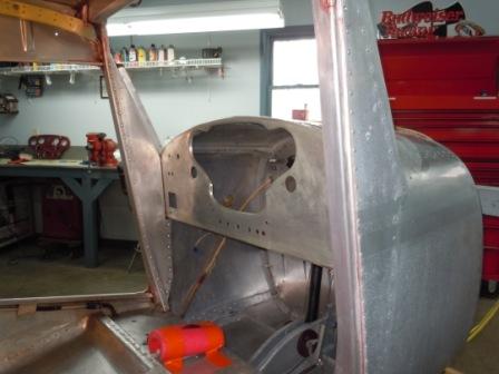

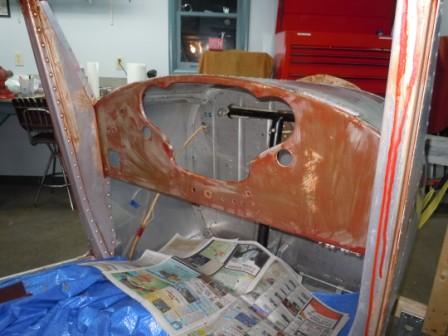

Working now to strip the paint from the interior. Not many sections are painted, just the pillars and panel etc. I believe from my reviews, that although it is a 1946 plane, it was painted in "Cessna Reddish Brown" in the interior as listed for a 1947 120. I see that the 1946 callout was for Cessna "Sumac Red" for the interior, which is what the stripes on this plane appeared to be, so I may put the interior back to that color (I like it better). Anyone have an interior picture, in Sumac Red?
Setup to strip paint
Primer is stubborn,,,

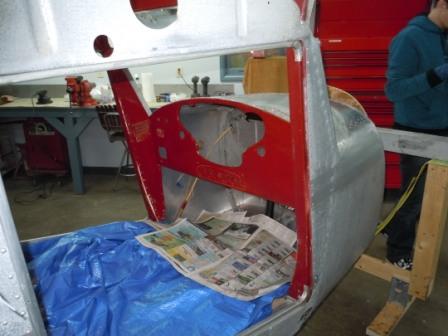

Kazoo120 » Sun Apr 21, 2013 12:21 pm

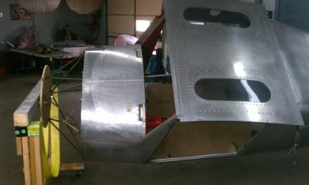

This week's work focused on finish stripping of the interior paint, I think it's all complete now. Took some extra time to get the last of the primer off of the panel. Looks pretty good now. I'm ready to etch clean and alodine, then move to the paint booth to paint the firewall and interior.
Thinking about making some more fixturing, a set of "Plank's" to scoot down the inside of the fuse, that will distribute the load and provide a way to enter, have not been able to crawl down the inside to the tail to clean,,, I've got a sketch and will see about working that today.
other side
other side
Sling supporting the fuse so we could sit inside to strip paint
Another view
Another view
Interior finished stripping

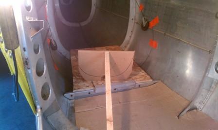

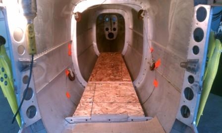

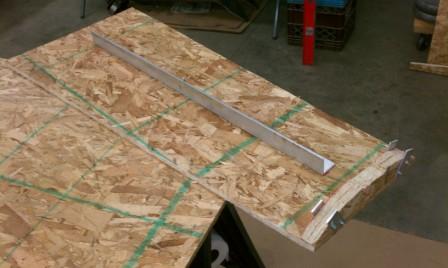

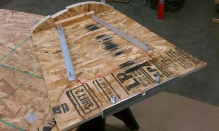

So as I threatened, I got into making some more fixturing! I've been wanting (to send young helper Greg) down the fuselage to affect some clean-up on the grease and dirt etc, that had accumulated further than I could reach. Fabricated some "Planks" to allow access.
Started by making tracing's of the frame outlines and cut forms to match, then heavily padded the contact areas. Worked great for him to scoot down the fuse and do some long awaited cleaning.

Section 1
Section 1
Section 2
Section 2
Tracing the frames, had a magic marker on a long stick also, to draw the curve

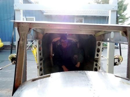

Kazoo120 » Sun May 05, 2013 10:41
We did some pressure washing inside the fuse this past week. Put a raincoat on young helper Greg and sent him down the plank with a pressure washer. Still amazed at what he'll do for money, and he's liking it!
If you look hard, you can see him in there!
