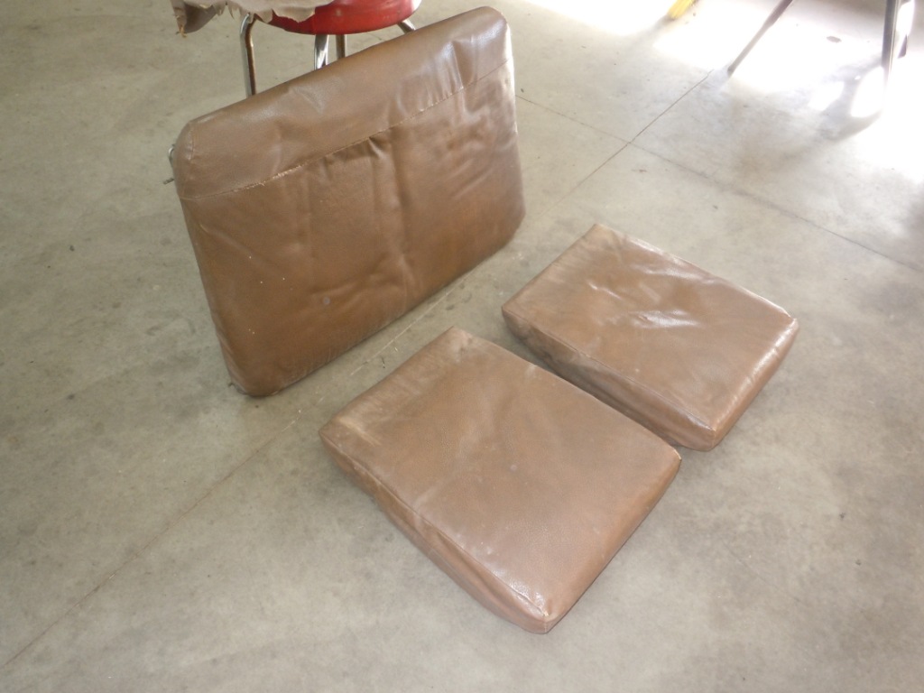

Visited Ken and Lorraine at Taildraggers a few weeks ago, what a great operation they have there. Saw a 140 that they have in-work that will be brought to Oshkosh Lorraine said, to demonstrate propping at the Red Barn. Will look forward to that. Worked with Lorraine to choose some materials and left the seats for her to reupholster. She believed that they were original, right down to the horse hair filling.

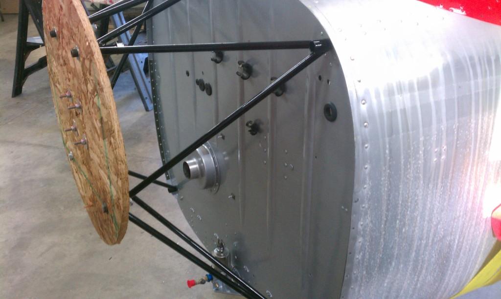

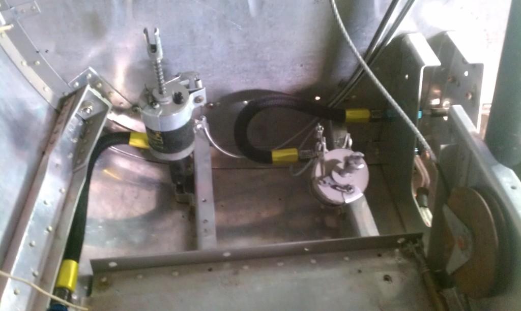

Continued to re-assemble some items. I rebuilt the Gascolator and Primer, two easy tasks. Both were in great shape, just needed gaskets and O-rings etc..
Also installed the brake master cyl's.

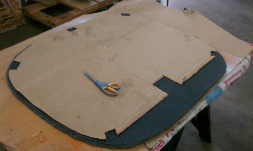

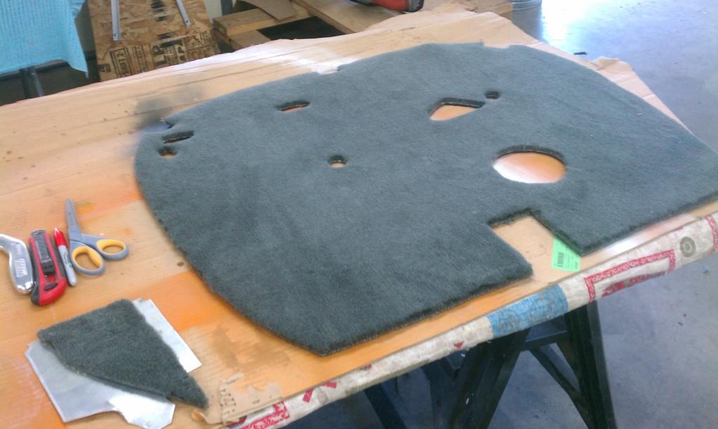

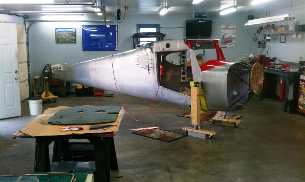

Working on firewall covering. Lorraine at Taildragger fixed me up with some material and glue, and drew the basic pattern on the piece for me. I made a cardboard final pattern to mark my specific needed openings, and used scissors and carpet knife to final cut the firewall cover. Ready to glue in.

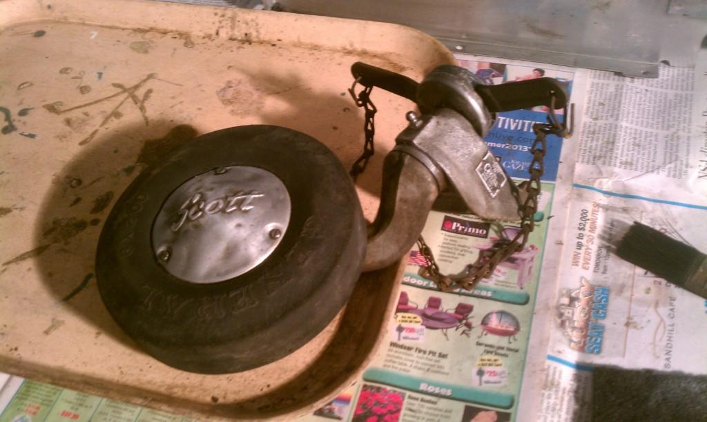

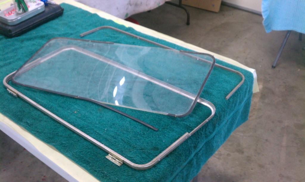

A&P Ray removed the door glass pieces. .060" Lexan will be cut to replace them. And Helper Greg cleaned up the original Scott tail wheel, will get some new parts for it and rebuild.

flyingdakota » Sat Jun 29, 2013 10:34 pm
Hey Kazoo120,
DON"T use Lexan! Use acrylic! Lexan is soft and hard to repair and very easy to scratch. Acrylic is harder, easier to polish and repair and in the event of a roll over you can break it to get out.
Trust me, I thought the same thing on the thought that Lexan (polycarbonate) would be better. Now i wish i would have listened to the ole' timers and put acrylic in.
Cheers!
Tim

Randy Thompson » Sat Jun 29, 2013 11:39 pm
Lexan also degrades when gas is spilled on it.

Kazoo120 » Sun Jun 30, 2013 11:07 am
Acrylic sheet instead of Lexan, thanks for the tip, I will do that!

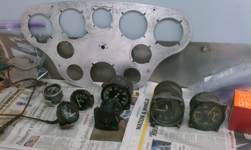

Disassembled the gauge panel yesterday. Someone made a pretty rough cutout to put a 7 O'Clock altimeter in, so will have to figure out a way to fix the appearance of that. Planning to add a rate of climb/descent gauge and a turn coordinator to what was originally installed by the factory. And replace all but the tach and compass with new I think. Wondering what gauges look most like the original..?

Martin S. » Sun Jun 30, 2013 8:42 pm
I need to replace this section of my panel with a new one.
The old one is badly cut up.
Will you do this yourself?
Do you know anyone who does panel cutouts?
