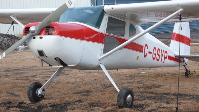

by John Smith » Tue Aug 17, 2010 1:21 am
Here is my 140A. I like the bright cabin and great view with these doors. I plan to be in Spearfish this fall so come and poke and prod all you like.
