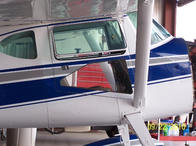

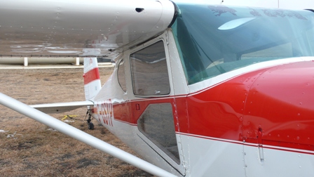

by John Smith » Tue Aug 17, 2010 1:21 am
Here is my 140A. I like the bright cabin and great view with these doors. I plan to be in Spearfish this fall so come and poke and prod all you like.

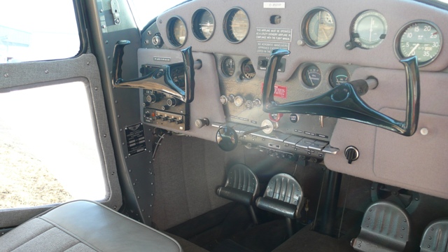

by John Smith » Wed Aug 18, 2010 12:12 am
Jake,
This is what I have for now. The inside is really a picture of the dash but you can see a corner of the door. Hope this keeps you going until I can get some like you want.

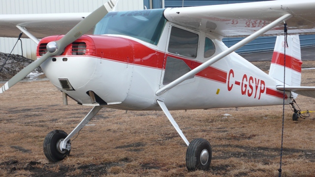

by jakedunn » Thu Sep 23, 2010 11:32 pm
Almost done.
