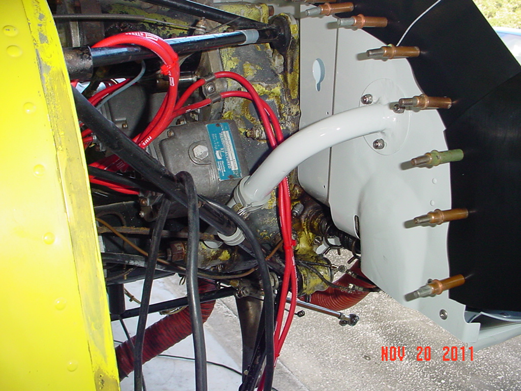

I am putting new baffles on my plane.
According to the parts manual, the rear baffle is held by two spring loaded wires that connect around the rear cylinder on each side.
I got new baffles from the place in AK, but they only drilled one hole.
Since your airplane is so low in time, could you see if you can take a pic of where those spring wires connect to the rear baffle and post it?

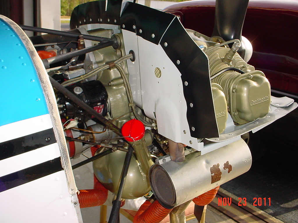

Steve Rose » Wed May 01, 2013 6:59 am
Martin,
Here is a photo taken during the fitting stage of our baffle rebuild. The holes for the rear cylinder spring retainer are visible. they worked out very well. I hope this helps.

Martin S. » Wed May 01, 2013 11:27 am
Steve,
Perfect!!!
Thanks, that is exactly what I needed!
Thanks so much for posting those pics.
