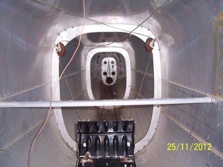

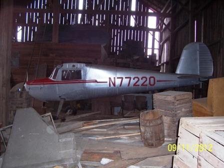

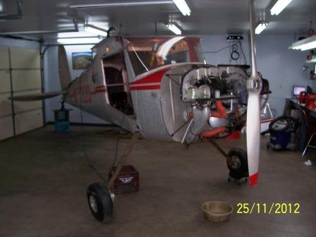

Thought I'd post a few pictures of the project. I began the disassembly this weekend, removing the interior, seats, headliner, etc, and getting access to the inspection panels. The landing gear and mounts are in great shape, apparently owing to a repair done in 1948 "in the Cessna jigs" after what must have been a hard landing, and the fact that the plane did not accumulate many hours after that (only several more hundred). No cracks or corrosion visible.
Then I removed the top plugs on the engine, and put some oil in each cylinder, and pulled the engine though rotation, and it feels very smooth. Other than 1 mag out, it looks ok, with not even any carbon build up on the cylinder tops. The engine logs show 11 hours SMOH, when the plane was stored....

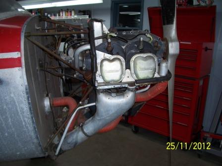

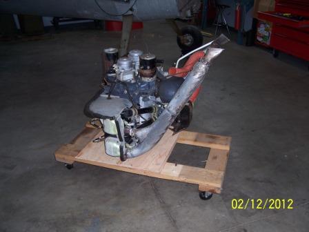

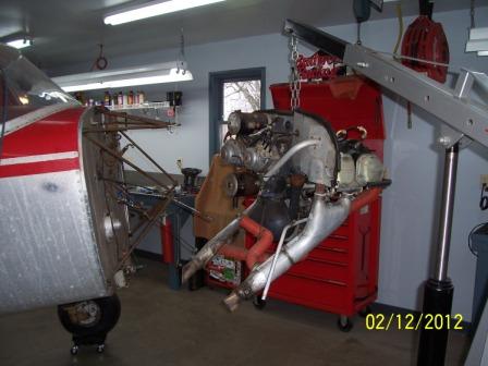

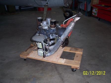

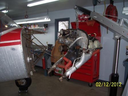

More work today, removed the engine.
Big thanks to Victor for a visit to the shop yesterday and we decided not to try to run the engine until it's been gone thru.
Next will be to remove the tailfeathers, and work on aluminum clean-up and polishing.

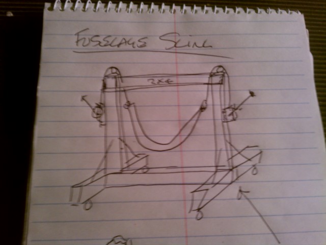

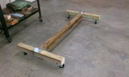

Working to build an adjustable "Sling" to lift the fuse to remove the landing gear for clean-up. Will be able to lower the fuse then for easier access to the cockpit for clean-up and for panel work. Using 4X4's for the sling frame and crank winch's and straps for adjustability. Base is complete, working to finish the rest of the sling frame.

Kazoo, that looks like one sweet time machine you've found there. I have a suggestion if I may; The sling plan you've drawn out is, in my view, kinda unnecessarily complicated. I had the engine, wings, gear, empennage, etc, off my fuselage not long ago, and I simply made a plywood saddle for the fuselage to sit on. It was narrow enough to fit between the gear attach slots, and once I had the wheels off, I could take the gear legs off and put them back on without interfering with the stand. I padded the stand, of course, and it fit directly under the gear box, shaped to fit the curvature of the fuselage. I found the fuselage easy to work on at that height, and you can elevate the tail (or not) to suit your needs. Just my two cents, but it might save you some effort.

Chris thanks for the notes, and I had seen some cradles that guys used but was having trouble figuring out how I would reproduce the curvature of the fuse. I didn't think of making one narrow enough to fit between the struts.
I got the idea for the sling from an airplane mechanic, sitting at a restaurant one night having dinner, who overheard me talking about the plane. I had all the 4X4's needed and the strap and some crank winch's came from Harbor Frieght, I think I really won't have too much time in making this fixture, and it will be able to lift the fuse up to get the struts off, then lower to whatever working height seems to work best.
I have considered that it may also be nesessary to have some sort of cradle though, to stabilize things if they tend to swing, but overall I think the sling won't be too much work to complete, I'll post pix when I'm done, and any regrets if this approach was too stupid.

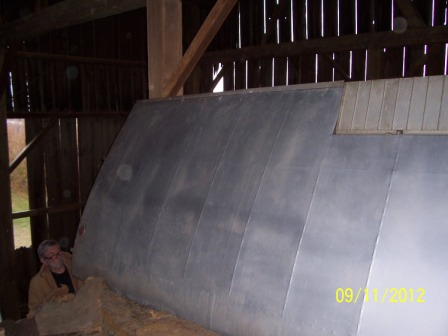

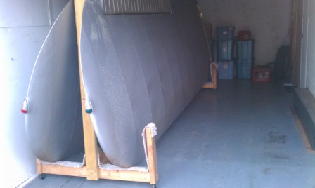

John I do not know fully how the wings look inside. They had been recovered in Ceconite in late 1967 I believe the logbook entry said, and the last annual was in 1968, the wings had very few hours on that recovering job anyway. There were some birds nests in the areas of the wings that are not full closed off, but in general they appear straight and complete. Same with the wing struts. I don't plan to begin to work them for awhile, and will remove the old covering and check them out fully.

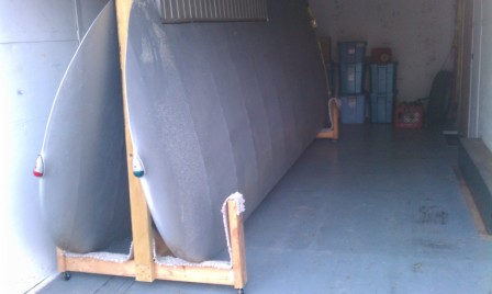

Stored for now
Stored for now

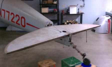

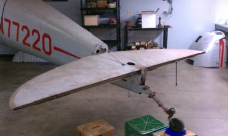

Working to remove the tail surfaces. Rudder came off first, then the elevator, then the fin. I stopped short for a bit to make sure that I knew how to remove the trim tab stuff from the stab. I'm working to be sure I can reassemble it in a properly rigged location, i.e. noting where the actuator shaft is etc, so I can reinstall.
Removal is to be able to check all the surfaces out, and for incorporation of AD"s related to the stab. And to make the fuse a bit more manageable for upcoming aluminum cleaning/polishing.
So far all parts look very good, even very little wear on the pivot bushings etc,. Have to make some interesting tools to get to where nuts are located behind bulkheads,,, Doubling my knowledge every day on how these planes are constructed!

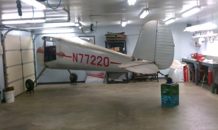

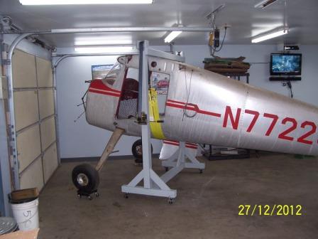

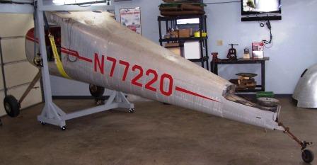

Tail removal was completed. I studied the trim mechanism and figured out a way to mark the exact removal, for re-installation later. Took lots of pictures. Then I completed build of a sling to be able to lift the fuse to remove the landing gear struts. The sling works great, but I still need a cradle of some sort to keep the fuse from swinging. It won't have to be much, just enough to stablilize things. In the end the sling is a "nice to have", but I can see that if you had a few friends to lift the fuse into a cradle, that would be all you'd need. In the end the sling didn't cost much, some wheels, a 3" tow strap, and 2 hand winch's from Harbor Freight, I had the 4X4's. Its main advantage is being able to adjust the height to whatever I want, which will come in handy for polishing.
Sling
