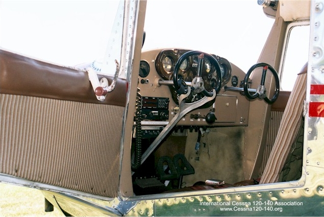

I managed to find an original Cessna control lock for the 140's (see the parts manual). It basically locks the rudder pedals and control yoke in place. and work perfect. I have seen people duplicate this somewhat with PVC pipe from both rudder pedals to just in front of the seat pans. It seems to work pretty well.
Found this photo of an original (haven't been down to take a picture of mine installed)...
- Rudder lock.jpg (175.14 KiB) Viewed 62726 times

If a gust lock were a frequent need of mine I would be finding a way to lock controls externally at the flight control themselves like carcreationz did. IMHO using an internal lock such as the one pictured or worse yet a seatbelt around the yoke like I do presently is inadequate for elevator and ailerons in frequent high wind conditions because cables can be stretched and pulleys unevenly worn by continuously changing tensions over long periods of time along cable drives to lock the controls. Locking controls externally prevents any tension along the cable drives.
