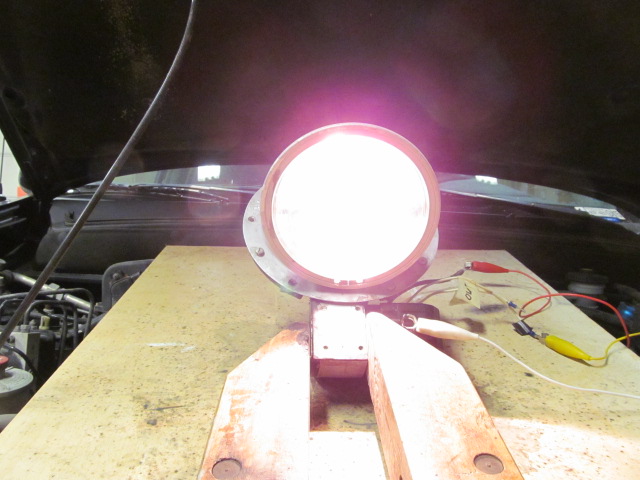

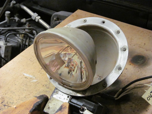

I have the Grimes landing Light that I removed from my '47 140.
Connected to 12v battery and it all works as advertised. Full extension and retraction and lights up my garage great.
Cheapest I found them on the internet is $700. $350 + postage and it is yours. Includes the 2 mount plates I removed from the wing.

The only things in the LE lite kit from AC Spruce that is usable are the bulbs and the switch. essentially nothing in it is in compliance with the STC. Even the wire appeared to not be approved a/c type.
