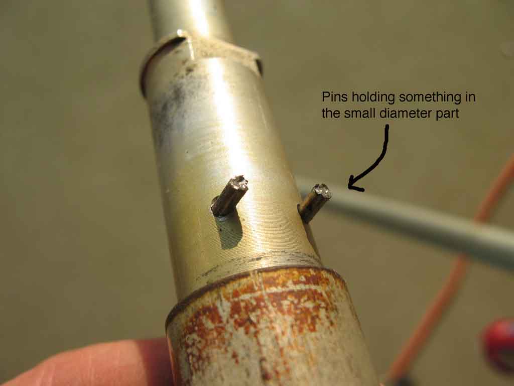

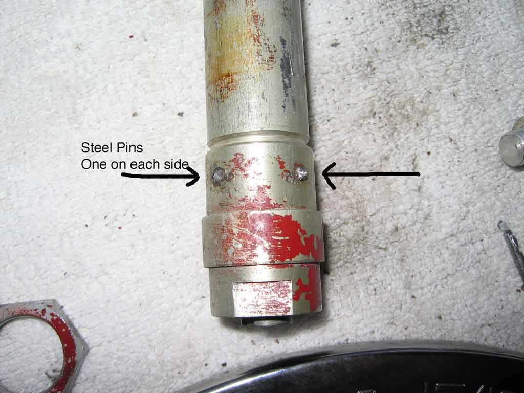

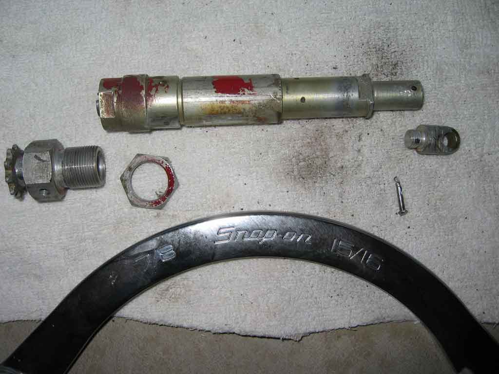

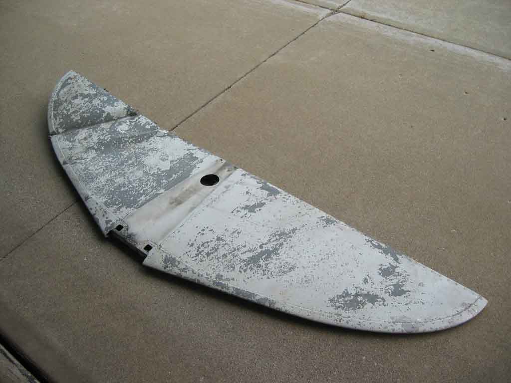

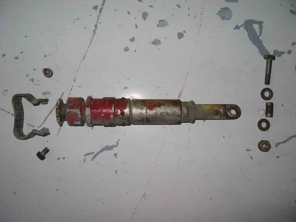

Tye Hammerle » Mon Jul 16, 2007 11:50 pm
Some pictures. I think it can be re-assembled easy enough. You'll just need either some solid steel or roll pins the right size.

- One banged up h-stab
- thedonor_207.jpg (37.11 KiB) Viewed 92336 times

- Partial disasembly
- assembly_559.jpg (45.54 KiB) Viewed 92336 times

- The chain drive end. The large barrel end comes off when the lock nut is loosened.
- chainend_314.jpg (37.41 KiB) Viewed 92336 times
- Shows the pins on the large end. The small end has similar pins but to see them you need to extend the small barrel. At first I thought the holes were grease holes.
- largeendpins_172.jpg (50.79 KiB) Viewed 92336 times

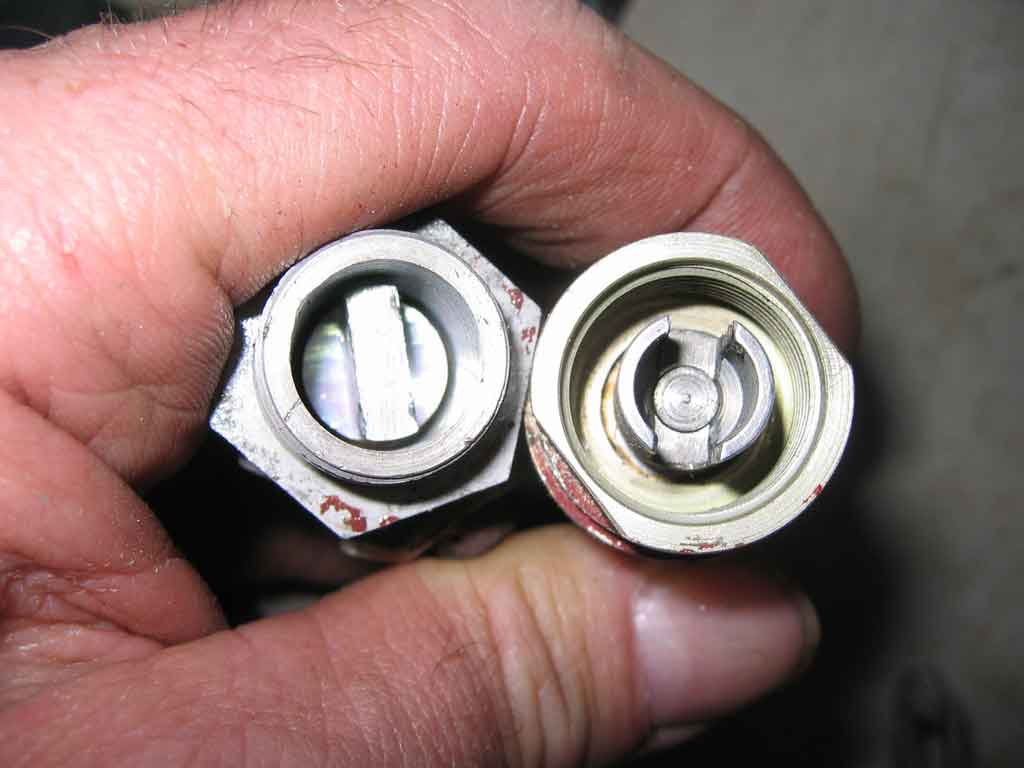

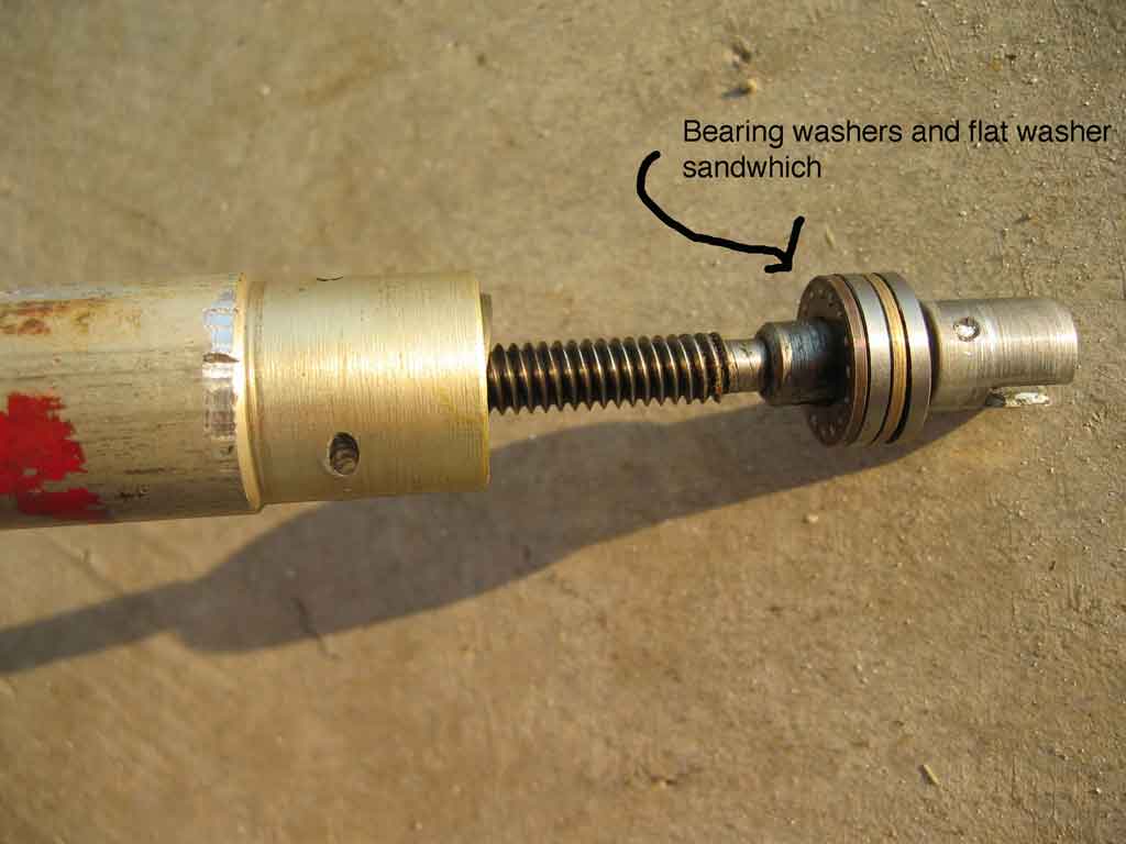

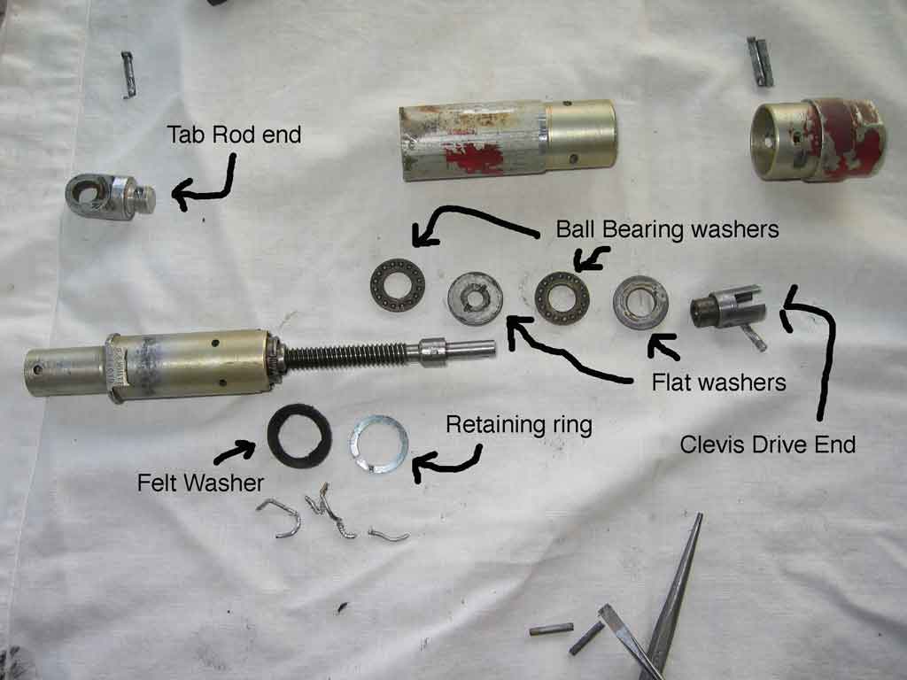

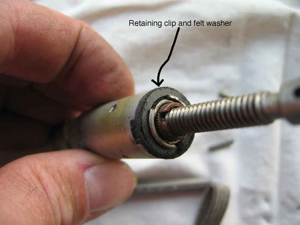

Some more pictures of where I'm at now. I have it just about down to parade rest. The last bit seems to be a press fit.
Tye mbr#6449

- lastpart_199.jpg (26.94 KiB) Viewed 92335 times
- lastbit_306.jpg (37.54 KiB) Viewed 92335 times
- allparts_133.jpg (35.69 KiB) Viewed 92335 times
