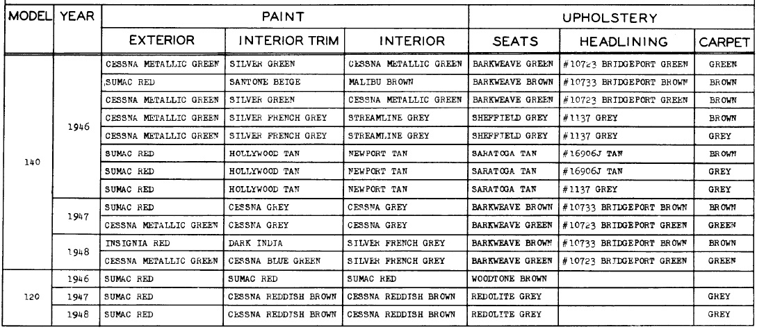

This is a compendium of information on original colors from the old forum. As any new information becomes available I will endeavor to add it here.
To start, the color chart from the Parts Catalog:
"The colors did not have standard number codes as they do today." - John von Linsowe
Color chart.jpg (243.03 KiB) Viewed 72239 times

by John von Linsowe » Mon May 30, 2005 9:27 am
In 1947 the interior was either Cessna Grey (140) or Cessna Reddish Brown (120). As far as my research concluded there are no identification code for these colors. I think Loraine Morris may have some information however. She has done interior work. I have seen a small sample of the original Cessna Grey and it looked like a brownish grey to me.
