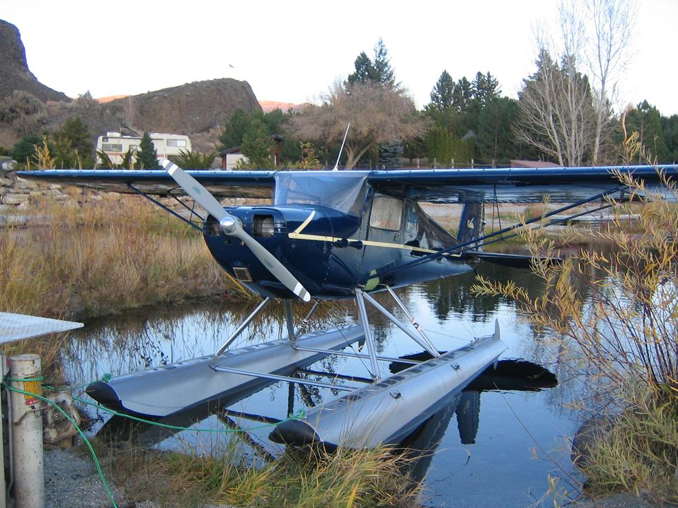

I thought I would put this up as I have been contacted over the years about performance on floats. I'll attempt to put some You Tube links and a picture or two. This site and its members have been extremely valuable to my efforts. Thanks for the help!
-1946 140 w/ metalized wings
-85hp Continental up until now
Just put a Dream Machine on with 0200 conversion. It's really going scoot now.
-Edo 1400 floats w/ 337 for 85hp vs 90hp
-Takes 30 seconds to get off the water.
HOWEVER it doesn't take that much distance! This was a big revelation. A 185 takes twice the distance to get off in 22 seconds. I've always heard "You got to get off the water quick!" Less wear an tear on the floats and fuselage yes, but if you can find short little bays with protected water, also less wear and tear.
https://www.youtube.com/watch?v=BTs3zbPl9o0
https://www.youtube.com/watch?v=k0mepEfVujY
https://www.youtube.com/watch?v=psr_Om_0wt0
Not bad on floats

That's beautiful! What are you using for a prop?

Awesome!!!!!!
Thank you for taking the time to post this and link the videos.
Looks like you've got float experience. Impressive.

Hi ''6781"!
I saw on your youtube video:
''Take off and landing on the Columbia River. First flight after the float conversion. The plane had never been on floats before. Parts were chased down for over two years between California and Nova Scotia."
Can you please shed some light about where did you get the parts & the drawings to be able to do the conversion on your 140.
I want to do exactly the same thing.
Thank you for your time!
Cheers,
Mat
Cheers,
Mat
