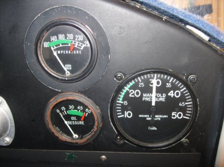

i have a manifold pressure gage installed and one see's ice sooner than a rpm gage
6597
Posts: 565
Location: Vancouver WA KVUO
Aircraft Type: '46 140 0-200A
Re: New airplane and carburetor icing
Post by 6597 »
Now I know what to do with mine, always wondered why a previous owner put it in, been using it to set cruise rpm with mixed results...seen here pre-restoration-
5-27-11 041.jpg (84 KiB) Viewed 23520 times
