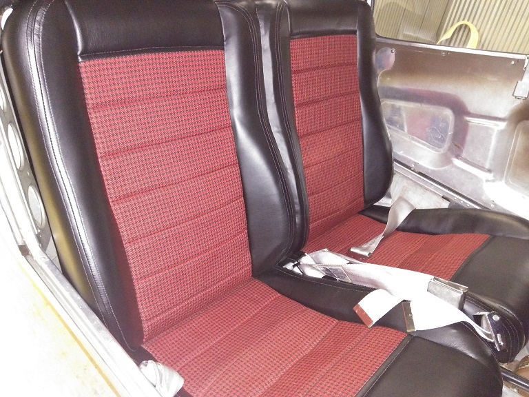

My original seats were truly mostly horsehair and I think maybe some cotton batting, covered in old vinyl. I used 2 lb density foam, which is std upholstery foam sourced from Airtex to get FAA certs. In the bases the first 1-2 inches was a stiffer Minicell foam because I didnt want to sink into the cushion too much and to stiffen the bolsters, also 2 lb density. I think the bases ended up about 4 in thick total, backs maybe 2 in thick. Covered with ultraleather fake leather bolsters and cloth center panels. Considered real leather, but it weighed quite a bit more. and the cloth is probably cooler, at least till the AC gets going (you do have AC right??). I also considered tempurfoam, but its also a lot heavier (6 lb density if my memory is correct).
I'm 6 ft so didn't want too much bottom thickness. As it stands when I look sideways my eye-level is just below the top of side window.
I'll see if I can get a picture.

Old Bottoms 5.75 lbs, new 2.75 lbs each
New back 8.7 lbs, old back was 12 lbs I think but couldn't find my note.
Happy to PM you all the details.

WoW! they look like VW GTI 337 Recaro seats ;)
You did a great job!!
