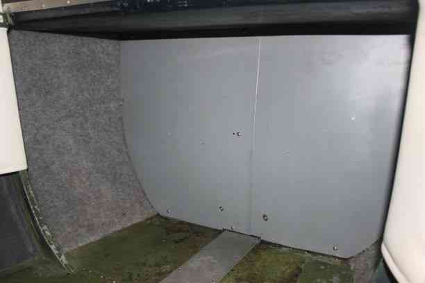

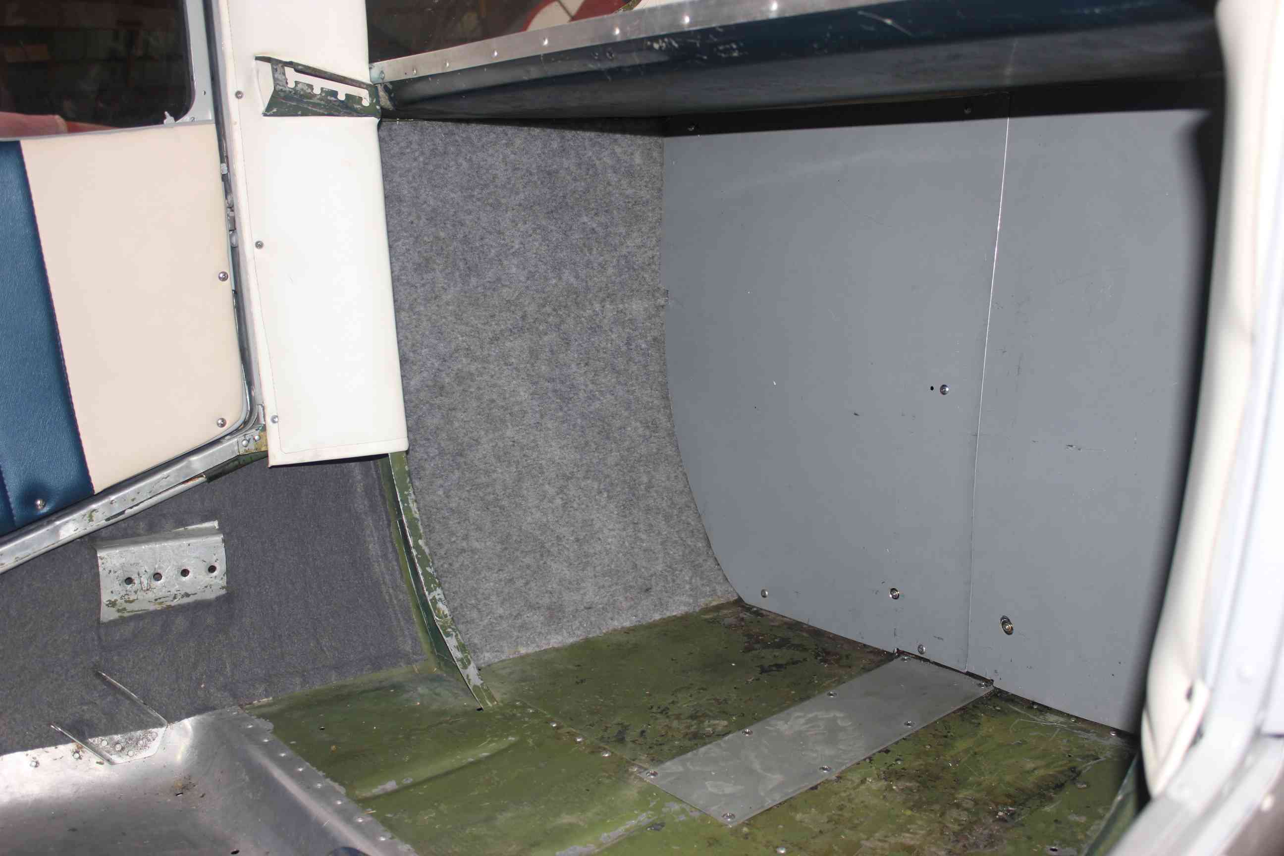

Good afternoon everyone,
Can any of y'all shoot me a photo or two of the 120/140 baggage area, and or/the dimensions? I have flown one, and looked at several at fly-ins in my area, and have yet been smart enough to remember to get a good look at this area. The 140 is on my shortlist for a future purchase and I really like airplane camping, so just want to get an idea of the area I am working with for packing/planning, etc. I understand weight limitations, etc. Luckily, primarily a sea level pilot (say 10' to 2,000' elevations typically) and fly solo most often.
Thanks for whatever you help you can provide.

Hi Drew.
Here's some info on the baggage area measured from the floor to the hat shelf.
Hat shelf to floor: 21 1/2".
Floor width: at rear bulkhead 24"; behind seat 31".
Floor depth: between bulkheads: 14 inches; from seat back to rear bulkhead 22-25 inches depending on position of seat back bottom.
Top width: 34" at rear bulkhead; 38" behind front bulkhead; between seat and front bulkhead; 33".
Top depth: 16-19" depending on position of seat back top.
My son and I flew our 1st 140 from interior Alaska to Oklahoma with the baggage packed full (no hat rack) with survival gear, food, baggage, etc. It will hold a lot of stuff!
Hope this helps.
Awesome, thanks!
