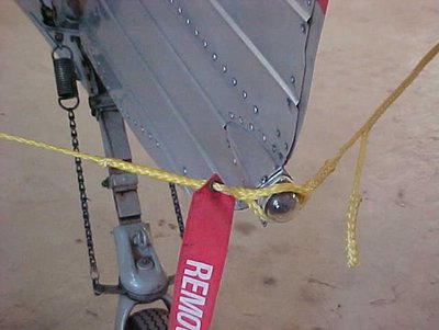

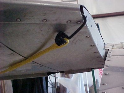

I made my rudder gustlock using woven poly rope, two bungee-cord hooks (one on each end) and a “loop” installed using a mariners’ “FID”. (Inserts rope into itself.) On one end, using the FID, I returned the end of the rope thru its’ center, which allows me to adjust the total length like a chineese finger-puzzle…. but that’s actually unnecessary because once the proper length is achieved, I hook the ends into the openings at the outside ribs of the horiz-stab, pass under the elevator, to the other hook and do the same…then lift the middle into position around the nav light. Just enough “stretch” in the rope …so no need to often make any adjustments.

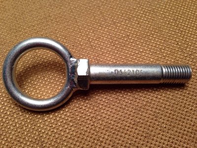

I adapted a PN: 0642105 “eyebolt” (used on L-19s) to attach my Scott 3200 to my C-170-B tailwheel mainspring.
Cessna L19 PN:0642105
I didn’t install it “eye” down… I installed it reversed, with the “eye” UP, and use it for tying down the tail.

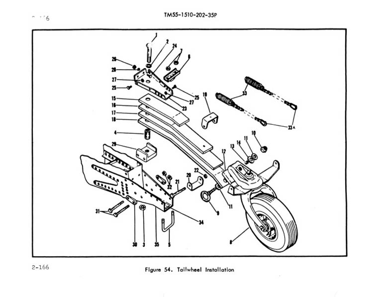

Here’s the illustration catalog figure from the L-19:
From L-19 IPC
From L-19 IPC
The PN 0642105 is used on the L19 ….which also uses a thicker tailwheel mainspring than most other Cessnas, so a washer (or maybe more) will need to be added to assure the self-locking nut doesn’t torque up onto the grip / shank of the eyebolt. I’ve used this method for over 20 years now.
Air Repair, Inc in Cleveland, MS is the source I used for the bolt. 622-846-0228
