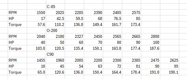

Get your HP vs RPM chart for the O200 out. Torque=(5252*HP)/RPM
Re: Max RPM Max torque curiousity question
Posted: Sun Mar 10, 2024 2:17 pm
Ah, yes, HP=lb-ft x rpm / 5252 or Torque=(5252*HP)/RPM
John, my overhaul and engine TC docs don't have a hp/rpm chart unless I look at the fuel flow charts and extrapolate (or I'm just not seeing the obvious).

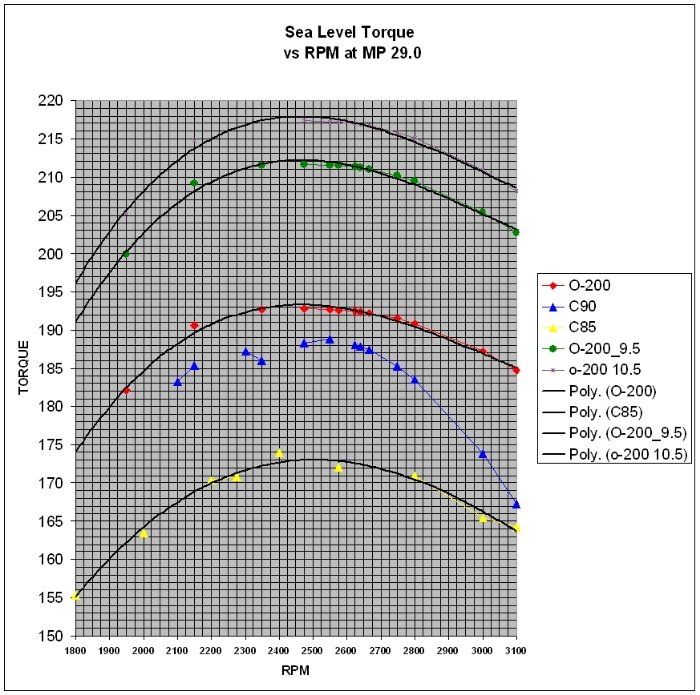

I found this chart on the Supercub forum with various engines and pistons. Curiously the high static rpm on my 0-200A with the 337'd prop is 2400 which is near the top of the torque curve on this chart. Someone in the distant past was doing some homework.

This is what I came up with:
C-series torque.jpg (71.77 KiB) Viewed 10471 times
Note that the C90 is the only one where the torque and HP don't peak at the same (rated) RPM.
[Edit] Actually, these numbers are a lot like the charts in the previous post.

Well! The seat of my pants is definitely wrong on this one. I will say that i never turn my C90 as fast as it can go, but I do like the C90 numbers.
