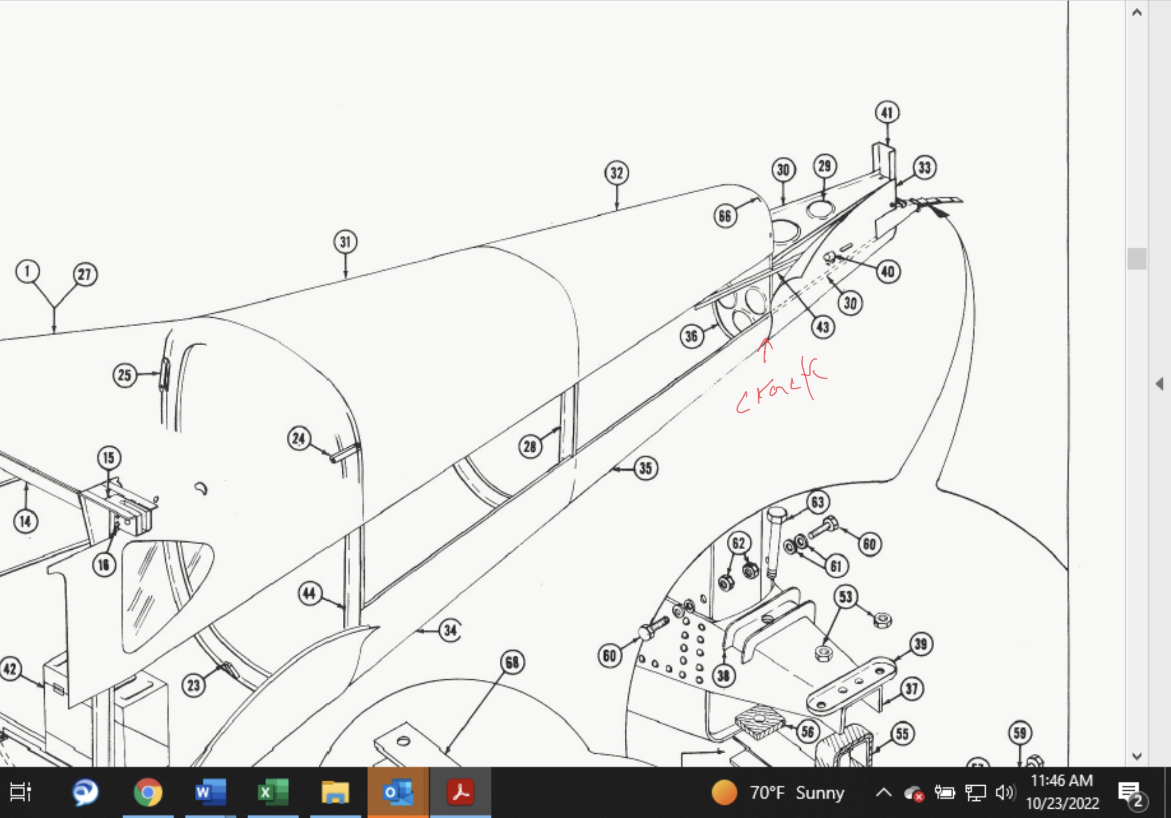

Would anyone know what the thickness of panel 35 in the technical illustration. I want to order sheeting that replaces that panel.?
- 799911F1-8F7F-4B46-AD16-E3499BD01382.jpeg (343.61 KiB) Viewed 2759 times

That skin is .032 2024-T3

If you look down the tail cone you can probably see the original markings on the sheet, something like "24ST .032 Alclad"
