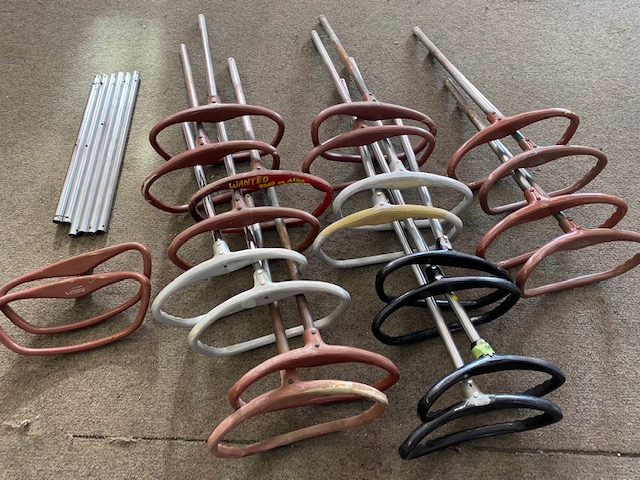

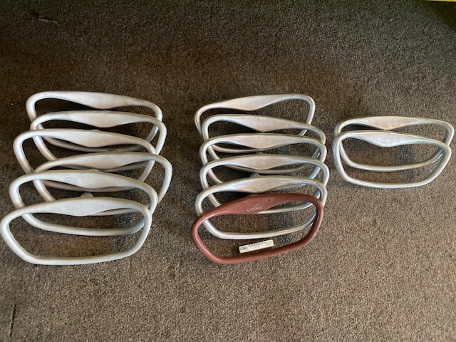

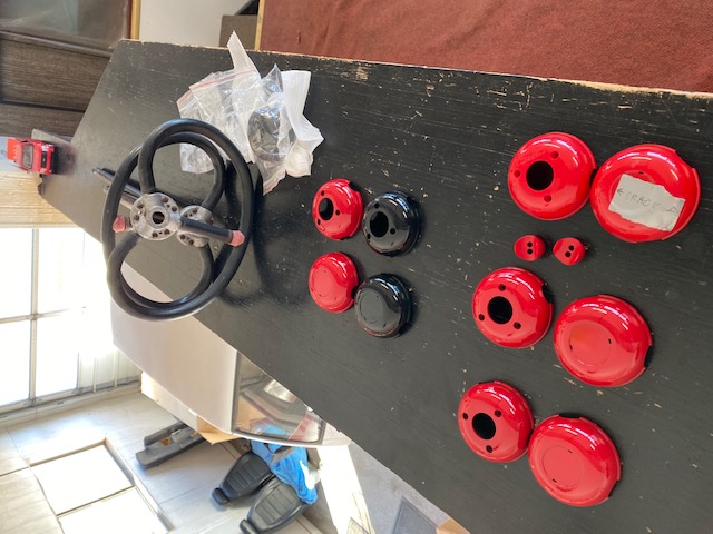

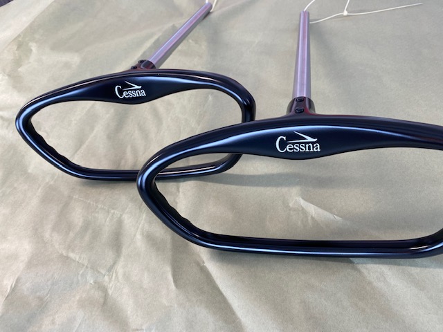

Anything can be restored I'm doing a set with John C's parts now but it is a procedure. We also have "D" style yokes that would work for you?
- YOKE6.jpg (93.92 KiB) Viewed 2288 times
- YOKE5.jpg (148.08 KiB) Viewed 2288 times
- YOKE4.jpg (141.64 KiB) Viewed 2288 times

Re: Yoke Change

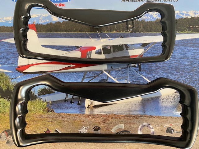

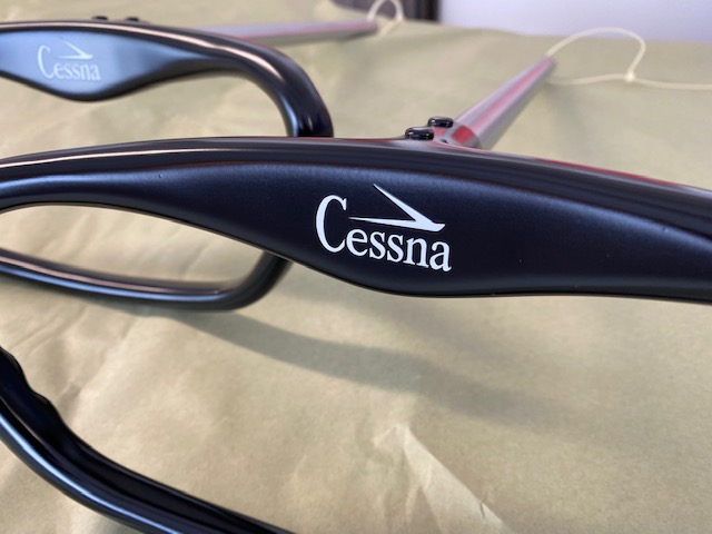

Some Finished ones
- YOKE3.jpg (123.9 KiB) Viewed 2287 times
- YOKE2.jpg (58.95 KiB) Viewed 2287 times
- YOKE.jpg (77.29 KiB) Viewed 2287 times
