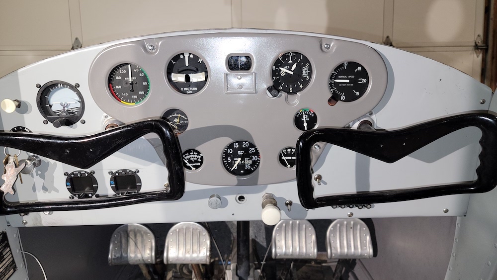

Instead of removing the panel for replacement in its entirety you may want to consider refacing it. I refaced mine with .050 by after removing all the instruments and then scribing from the backside the positions for instruments I wanted to keep. Brake bend a 90 on the bottom and cold form with a soft hammer the rolled edge on the top.
No structural changes are made so a 337 is not needed depending on your AI/AP.

Truly outside the box, and looks great & "new". Nice work. ...curious -- what's the effect on weight and balance?

Less than a 1/2 pound I would think. We will be doing a new weight and balance soon as new lighter radios were added.

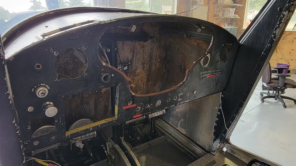

Here is the before, I removed everything and made sure the front was flush with no protrusions. Then cut a .040 sheet to fit. While holding it in place with a couple celecos I scribed from behind the holes I wanted to retain.7757 wrote: ↑Sat Mar 04, 2023 11:22 pm Scott,
Do you have a few more photos of the panel overlay you made? I'm working on a fairly involved rearrangement of my own panel. Do you have some before-and-after photos? Or some photos of how the overlay interfaces with the original panel? Maybe a few shots of the edges? Thanks in advance.
-- Chris B
