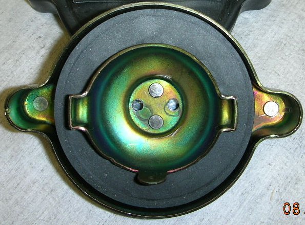

My IA came up with this solution, put rivets in like original and drill 2 holes .125". I think we had some concern that the electrowelds might be compromised so added the rivets. Looks and functions as original.
I cannot tell what the Spruce product really looks like. You may want to converse with your mechanic. Proper venting is a big deal with our birds.
- Untitled.jpeg (74.98 KiB) Viewed 7392 times

We ended up getting an aircraft spruce vented gas cap (https://www.aircraftspruce.com/catalog/ ... lange2.php) and boring out the single hole to 1/8 inch then adding a second 1/8 inch hole beside it. It works like a charm!
