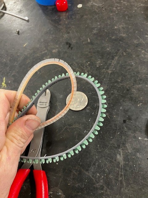

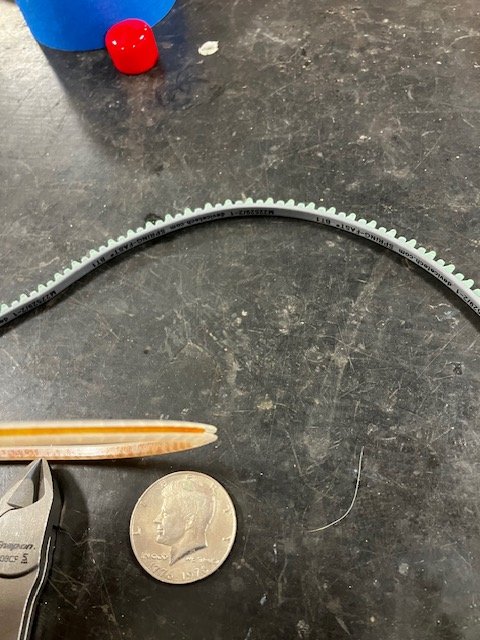

Here's a better pic of the stuff at the shop. Set of side cutters and half dollar for reference.
Personally I prefer the clear plastic as opposed to the green metal band,
The differenct is the clear plastic is easier to install.
The green metal units are "sturdier" and will hold up better for more severe conditions.
- tracks 2.jpg (81.51 KiB) Viewed 134 times
- tracks 1.jpg (100.73 KiB) Viewed 134 times
