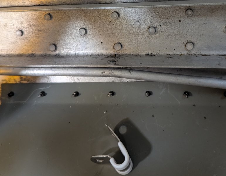

I am trying to figure out how to re-secure the brake lines to the engine mount stringers.
The parts catalog shows it on 24-3 and 24-5 as A3048A-6 "Clamp - Tube" held in place with a PK76XZ-8-8 screw. I searched around a lot and found that the closest equivalent seems to be NAS1715C4K, but it seems to bulky to fit underneath the stringer.
I also have some MS21919-WDG4 that is a bulkier clamp that definitely doesn't fit into the space.
Does anyone have a picture of what this looks like on their planes?

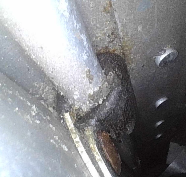

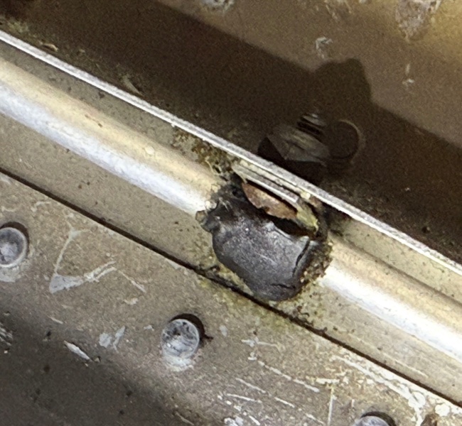

Looks like the attached pics. Much smaller than the one you pictured.
Brake Adel Clamp.jpeg (107.15 KiB) Viewed 1814 times
Brake Adel 2.jpg (152.53 KiB) Viewed 1814 times

Use the cushion material off the new one and make a strap that fits. Easy-peasy.
