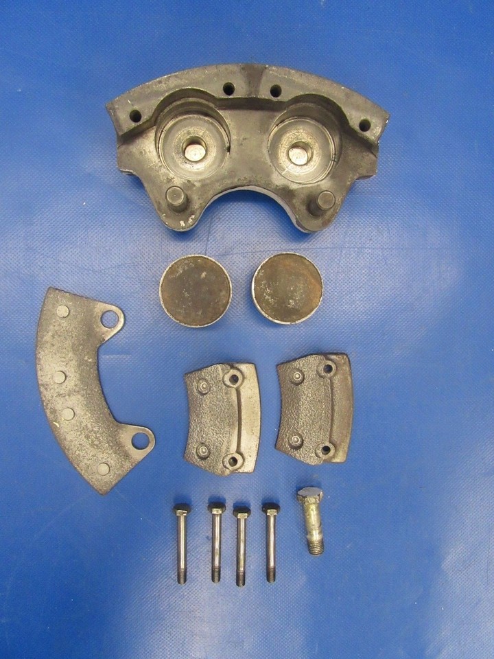

The 30-52 is a double puck. The 30-52 is not on the Cleveland approved list for the 120/140's as far as I can see on their website. I know the big tire back country guys like double pucks. (EBay pic)
