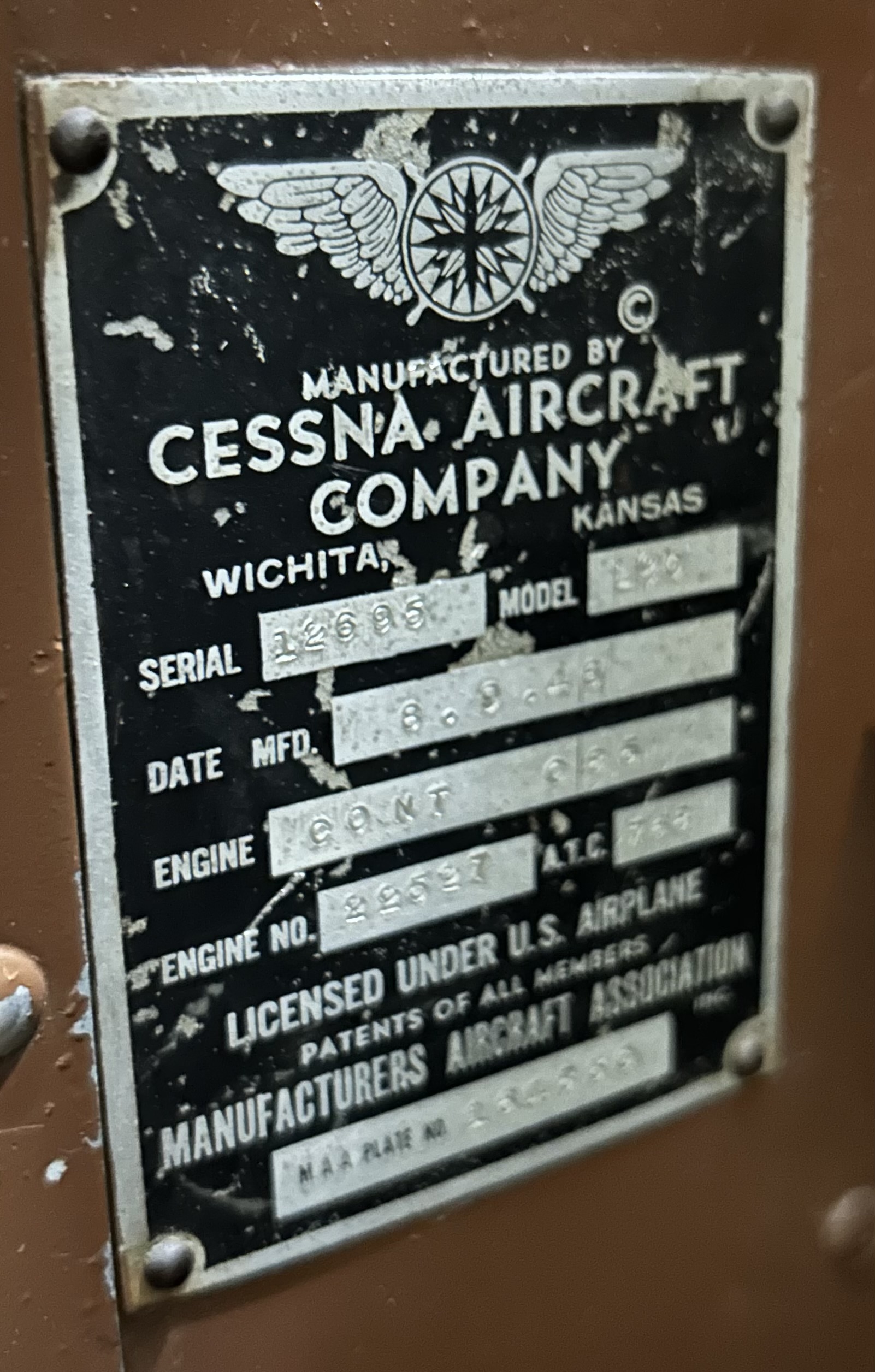

Do the SN and registration number on the ACA-309 both match your records? Could your data plate be a replacement? Post a picture of the plate.
8014
- Posts: 19
- Name: Tony Becker
- Location: KFBL
- Aircraft Type: C-120 NC2442N
Re: Build date on data plate vs. factory paperwork
Data plate attached. Every bit of paperwork, and the data plate, says S/N 12695. I guess it could be a replacement data plate, but it looks legit.
