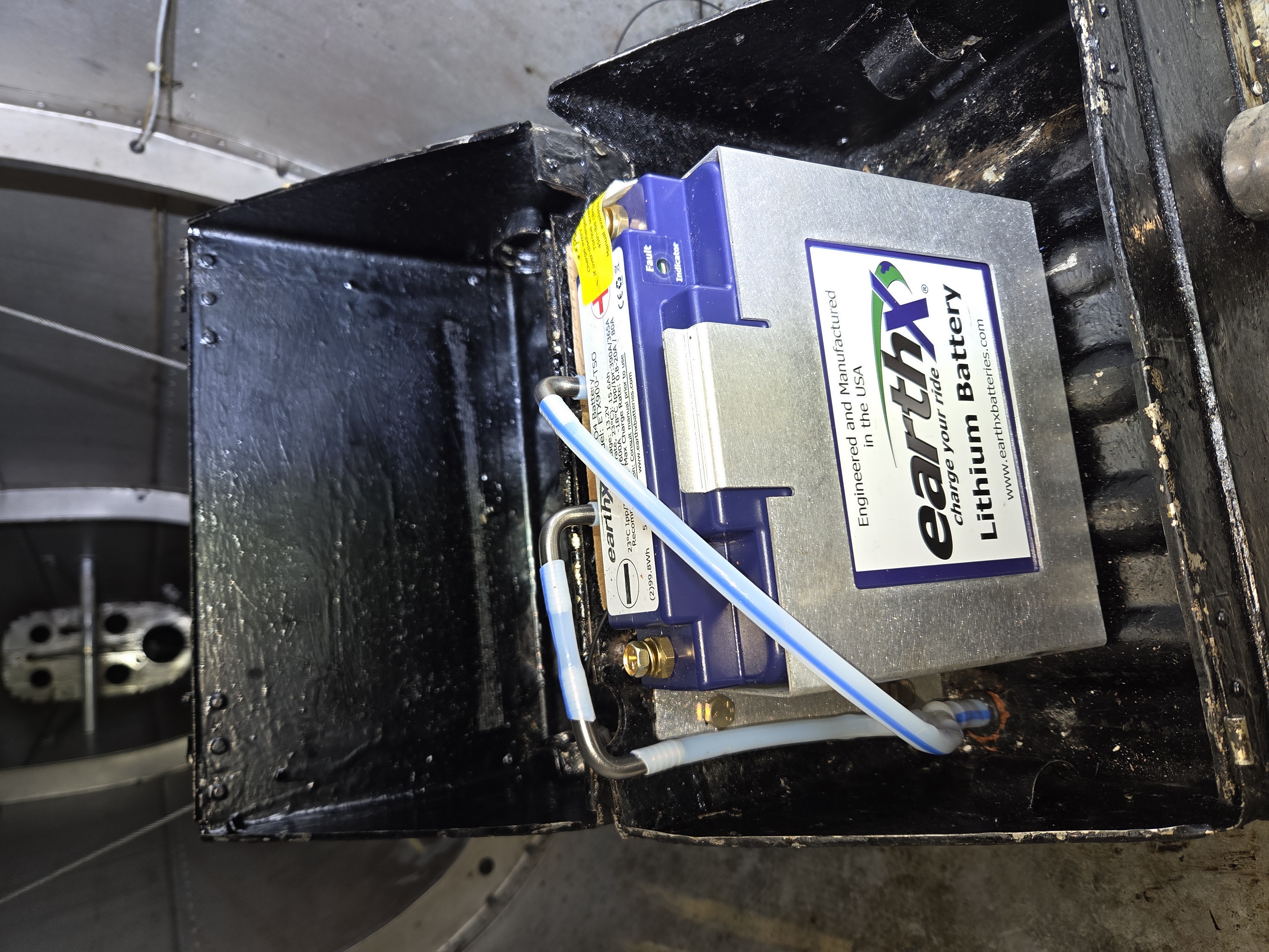

tonycondon
- Posts: 111
- Name: Tony
- Location: Wichita, KS
Re: EarthX
I put the EarthX in last fall. 18 lbs lighter. I used one of the EarthX mounts mounted inside the battery box. Had to rewire the leads to the solenoid. The terminals ended up oriented 180 degrees from the old Concorde RG25. Ran a wire along the routing of the main cable for the warning light in the panel.
- 20251121_175452.jpg (3.24 MiB) Viewed 3553 times
N2395N
