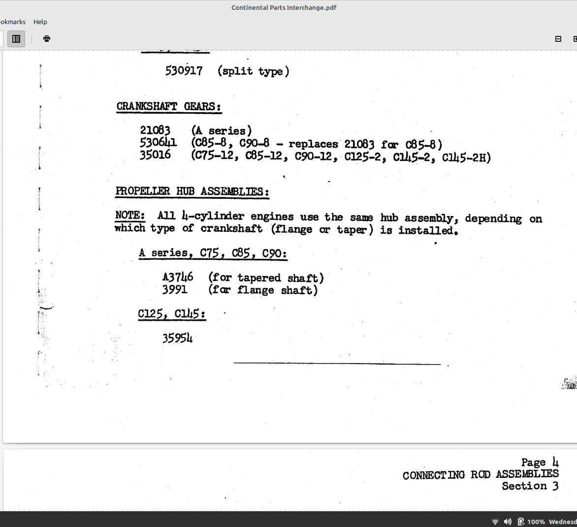

The hub from any C75 or C85 with a tapered crank will work. I think one from any A-series will also work, but you should confirm that before laying out any cash.

Post by 6597 »
Screenshot from 2026-02-11 17-58-17.png (167.53 KiB) Viewed 2513 times
