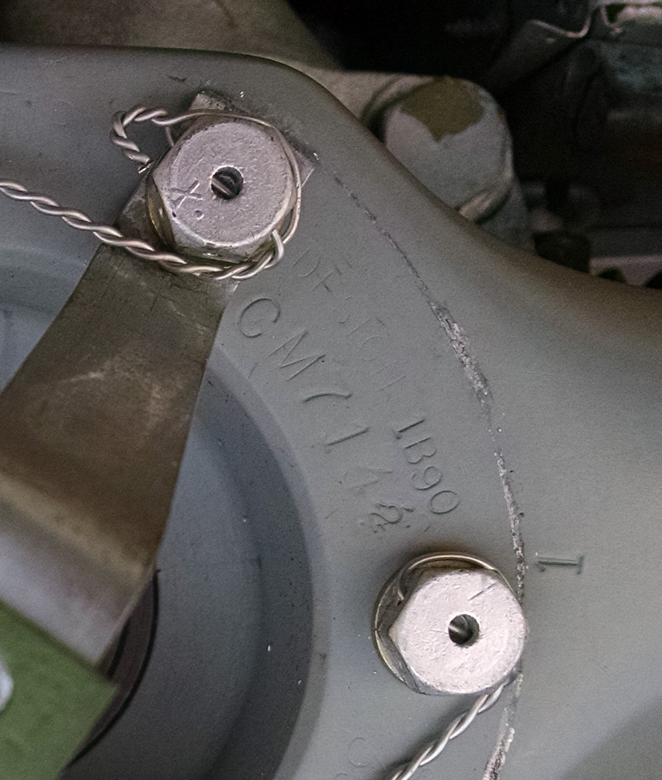

Is anyone using a 1B90 CM pitched at 44 inches for a land based airplane?

According to my logbooks, I am. Static is around 2250. I’ve never had the prop measured though, so can’t confirm it personally. I’m guessing @flybuoy already knows that about my airplane though. ;)
