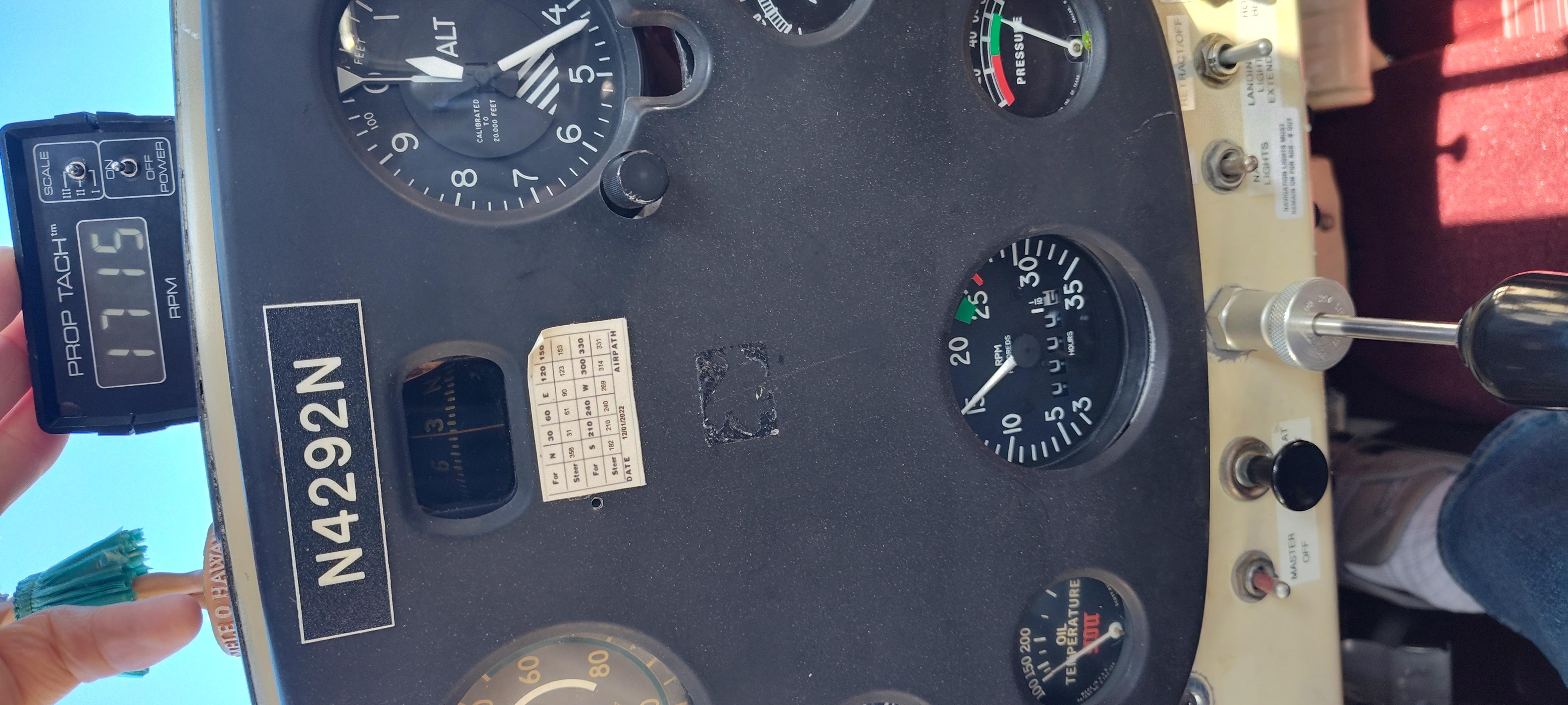

Forgot to mention ... I used a PROP TACH (visual RPM counter placed on the glare shield) and it showed 1,715 when the RPM indicated 1,500.
Do tachs require any adjustments? Could it be installation error?
