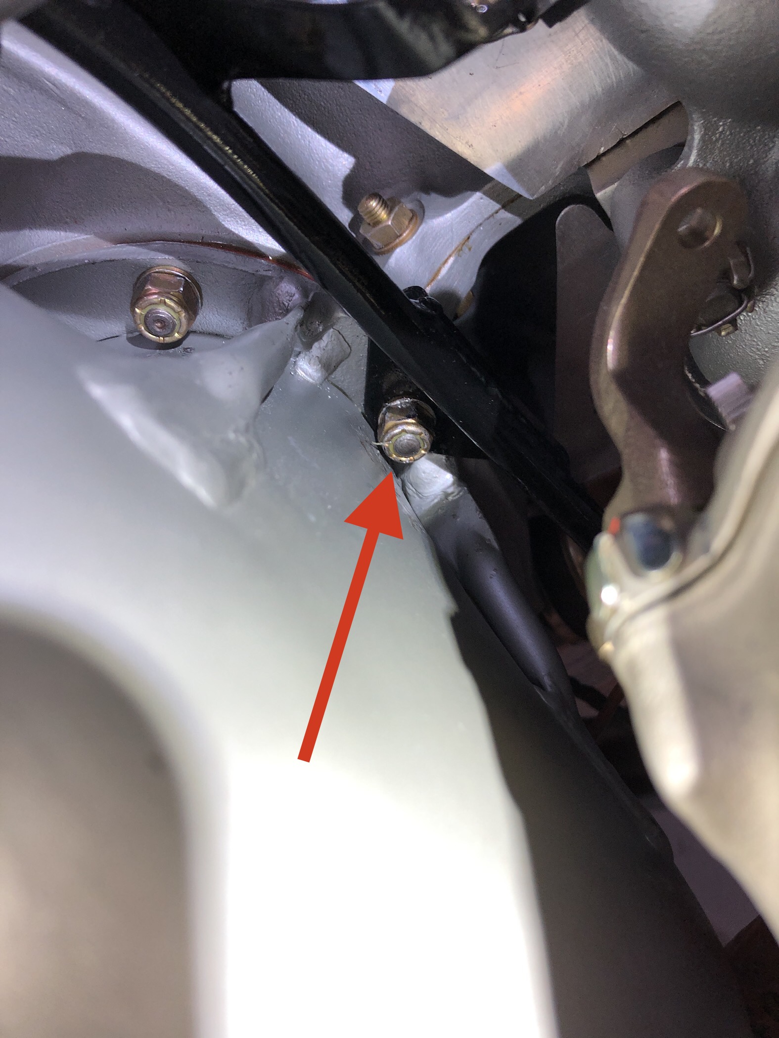

Hi,
I just got my engine back from overhaul. My mechanic and I had to remove the oil sump to install the 150 exhaust bracket under the front sump nut. We have turned down a 7/16" socket almost paper thin and still can't get it on the nut to be able to tighten it fully. The sump nuts are MS21044N4 nuts. It seems like when I removed the exhaust bracket prior to the overhaul that the nuts were lower profile than the MS21044N4 nuts seems to be. Is there an acceptable lower profile nut I can use? My mechanic had all kinds of specially modified tools and none of them will work due to the super tight working space the exhaust bracket creates.

- IMG_3859.jpeg (553.54 KiB) Viewed 916 times

For the sump I prefer MS21042-4 nuts. They're all metal stop nuts and have a reduced size hex for easier installation in tight quarters.
Technically, nylon stop nuts shouldn't be used on an engine.

Thanks John! That will make installation so much easier!

The MS21042-4 nut worked great! A standard (no modifications required) 5/16" universal drive socket did the trick. Thanks for your help John Cooper!
