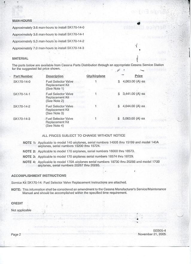

Attached is Cessna's solution back in 2005 I think, not cheap and I wonder if anyone actually bought one of their 'kits'. Appears to be for the L-B-R-off valve. I think I saw how this was done and it was rather Rube Goldberg...So, yes, it was hard to swallow the cost, but now I have great confidence in my fuel selector.

And, apparently, not applicable to the early planes without "Both". Makes the ACS/Univair solution seem downright cheap!
$4063 in 2005 is about $7000 today...
