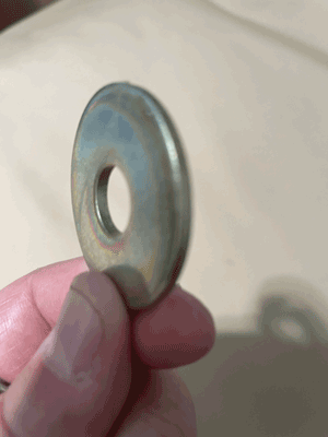

John, I measured the continental 21530 washer (which is specified in the continental parts manual but not the Cessna parts manual- the Cessna manual specs 2 AN970-6 washers). The 21530 measures exactly 3/32. So I infer that, one could substitute that 21530 washer instead of the 2 AN970s at the front of the engine. As far as the "spacer," I'm not sure what to do with that. When I removed my engine there was no spacer there and the Cessna parts book does not specify a spacer.6643 wrote: ↑Fri Jun 19, 2026 9:05 am Not to diminish Marc's hard work in any way, but, here is the drawing from the Continental Manual section on installation. Note they spec a "spacer", really an AN970-6 washer, quantity "as needed" to adjust the CG of the engine. The Cessna spacer is noticeably absent. Also, the washer on the front of the engine lug is spec'd at 3/32" thick. One AN970 is 1/16" thick.

I see no reason it wouldn't work, and I can't imagine anyone catching it during an inspection, much less writing it up! Again, it may be a carryover from an earlier plane.I infer that, one could substitute that 21530 washer instead of the 2 AN970s at the front of the engine.

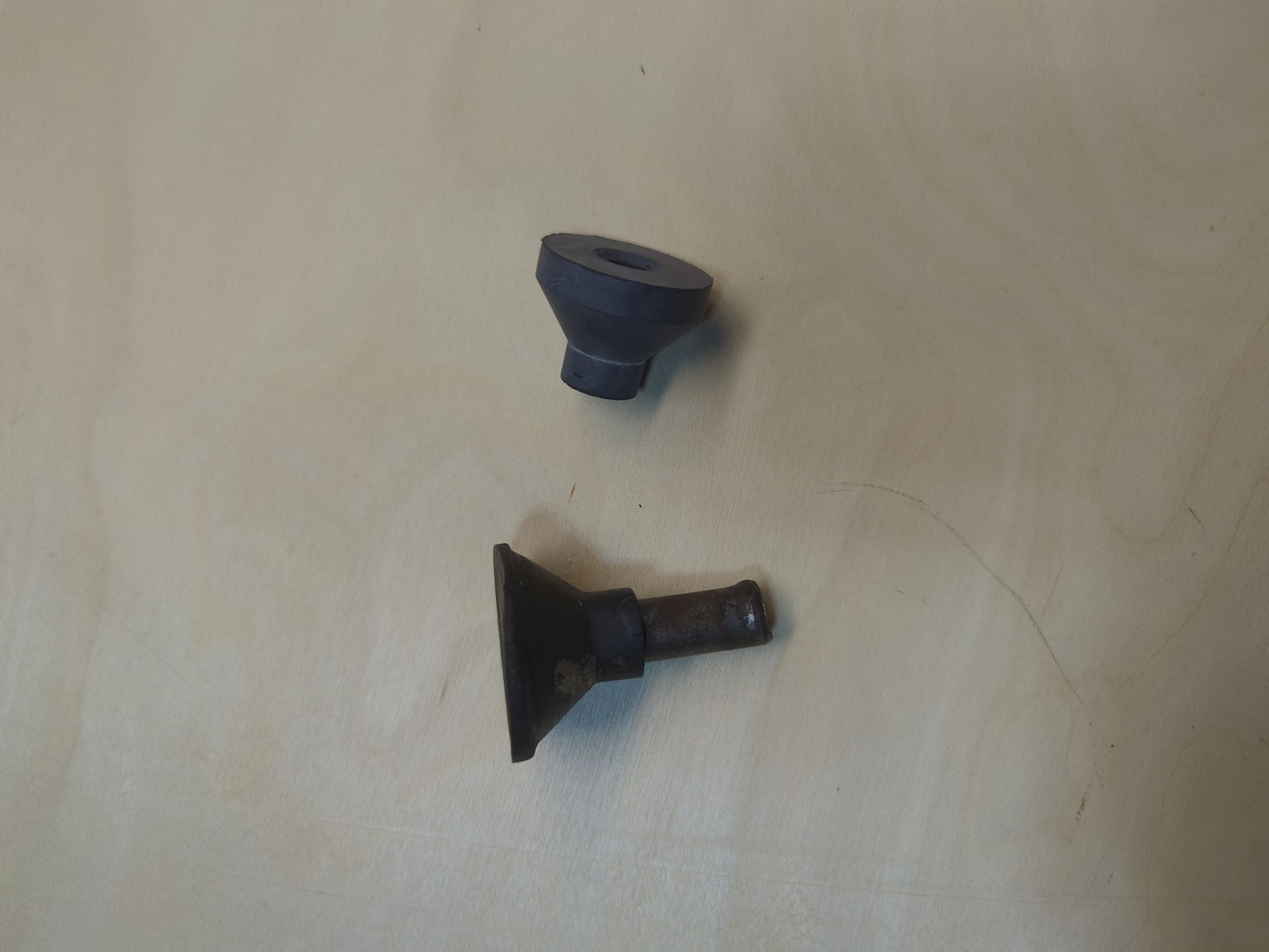

I need four of those 0450195 spacers as all of the ones I have are crushed or mangled in some way. I contacted Textron about https://ww2.txtav.com/Parts/PartSearch/ ... il/0450195 and got a quote of $1,226.79 EACH. I've been looking for them on eBay, but no luck so far.
I can measure the ones I have and likely fabricate them on the lathe out of 4130 tubing, but there seemed to be debate about if they are needed. What do people think?

The rubber mount cushion has a "straight" section that fits the inner bore of the ear on the engine case, and the ID fits the AN-6 bolt. The "wall" of the rubber tube is 1/8" thick. How much can you compress that to fit the spacer??chriscrewdson wrote: ↑Fri Jun 19, 2026 6:16 pm I need four of those 0450195 spacers...What do people think?

Those spacers are definitely made of "unobtainium." The second thing is, they are a BI%$# to fit into the rubber bushing. People on this forum have used talcum powder, silicone grease, engine oil, and cussing. I dont think any of them made it easy. Ive been trying to get one of those in to the bushing for the better part of 2 days. What a nightmare.
The spacers are in the Cessna book but are not used by other airplanes that use the C85 (or C90). It seems to be only a Cessna-specified part. The continental parts manual is silent about that spacer, and you'll notice that the drawing that John Cooper posted in this thread makes no mention of a spacer (other than the one that looks like a washer near the bolt head). So do with that what you will.
The hex-head bolt youre referring to is outdated and is part of the AD that John noted. I would instead opt for the diagram I made, noting that those 2 front AN970 washers could be swapped out for continental engine washer 21530.

I know these spacers have been talked about a lot Engine mount bushings (2019), Engine Mount (2022), and engine mount spacer (2023).
Here's a picture of a new rubber conical bushing and an old conical bushing with a (crushed) spacer in it.
