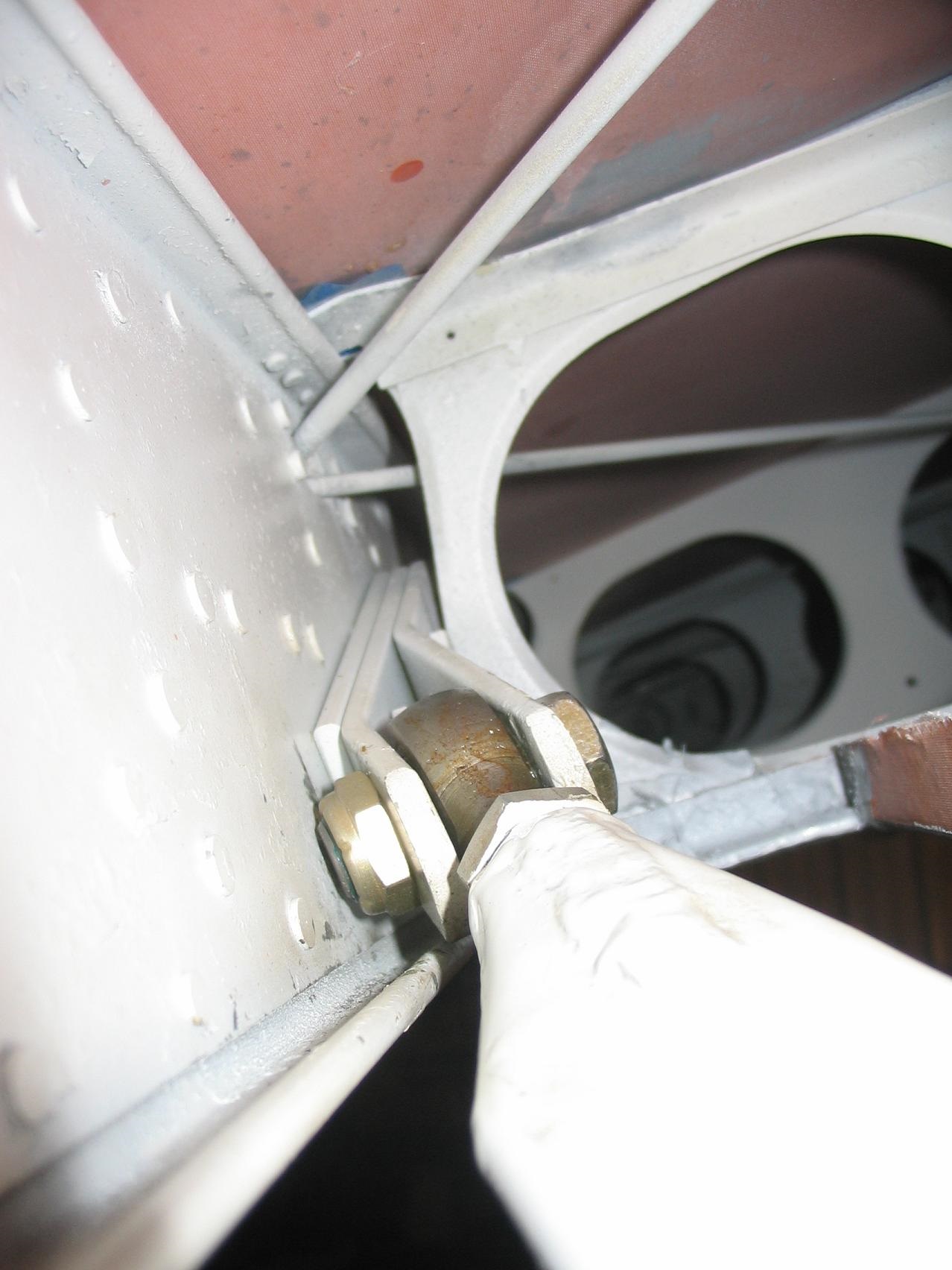

I’m about ready to put wing back on. All three strut attach bolts had washers on both ends ( except for nut side rear attach low profile nut). The IPC does not call for any washers here ? I’m thinking put back the same way , new hardware,
A&P helping says follow IPC …. I have read elsewhere that the IPC sometimes isn’t entirely correct
Thoughts……

- Posts: 545
Re: Wing removal question.
I don't have a washer there. The trick is to make sure that the bolt grip fits to the 'forks' area and that you use the correct bolt and nut. Ham handed mechanics use bolts that are too long with a few washers under the head and then threads are bearing on the rearmost 'forks' area.
That bolt is nothing more than an AN bolt with the threaded area cut back.
