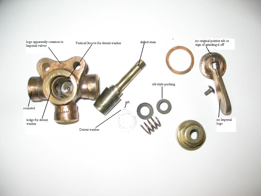

Assuming it's the old brass on brass valve, left-right-off, then all you can try is drain all the fuel and remove the bonnet of the selector, clean and dab/smear just a little EZ Turn fuel lube on the truncated cone. Re-assemble. If the brass cone/seat is really scored you'll need to look into another valve (check UNIVAIR). There is a packing under the bonnet where the valve stem comes through. An M83248/1-109 o-ring is what I've been told. One member used a fat fuel injector o-ring Napa # 2-12085.

Here's an example of an original fuel selector Left-Right-Off so you can see what you are dealing with. Pretty simple. You don't need to remove the valve body from the aircraft to do the basic maintenance.
