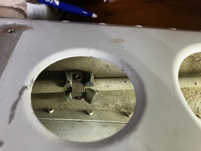

HI Chris,
Sorry for the late response!! I took a look at my airplane. Mine still has the original clamps and they are holding fine, so I must have been thinking of another aircraft I worked on in the past.
Two thoughts. 1. if the fuel line has enough "spring" to it, to be able to shift it slightly to the side to accomdate the adel clamp, that should be fine.
2. if it's too rigid, then I would just drill another hole, either above or below (obviously offset) to accomdate the Adel clamp. that way the two holes aren't next to each other. The rear door frame doesn't hold near the load the front door frame does, so one more hole shouldn't affect it's strength.
- fuel line.jpeg (96.91 KiB) Viewed 1530 times

Thank you for the reply, picture, and ideas. I'll talk to my A&P about the options.
