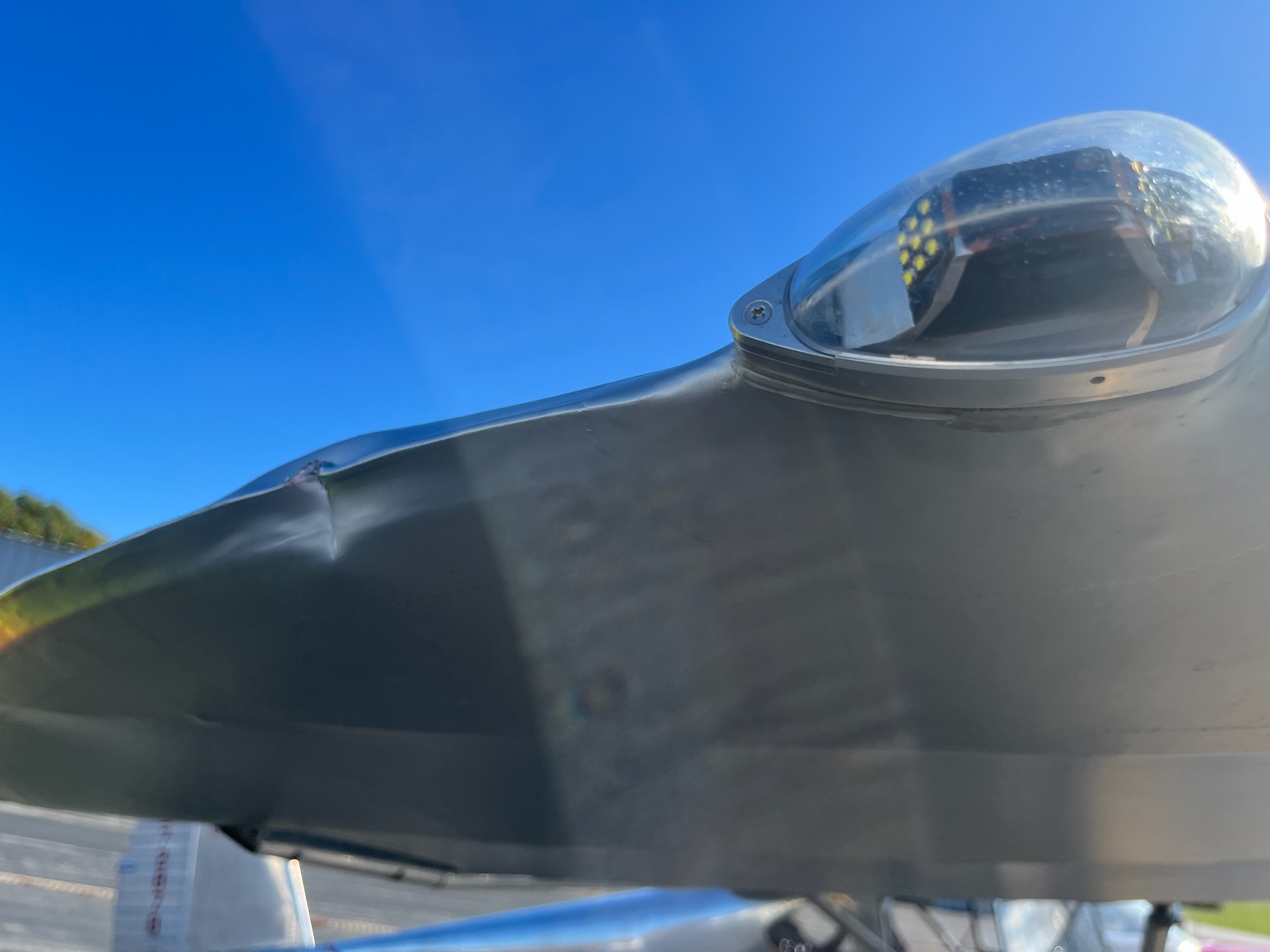

Got run into while sitting on the ramp and dented wingtip. The crease is about 1.5 in tall and 1.5 in deep. 1946 140 ragwing.
First question is whether this is anything more than cosmetic. The spars stop 1 or 2 bays inboard of the tip, so I dont see how this would be structural given the location and size. The surfaces of the wing over spars aren't distorted, no fabric puckers, controls move smoothly, etc. I think it is just cosmetic-- If someone has a good reason to think it might be opposite I would love to hear it. I plan to open up the inspection covers and do the drag wire inspection and boroscope.

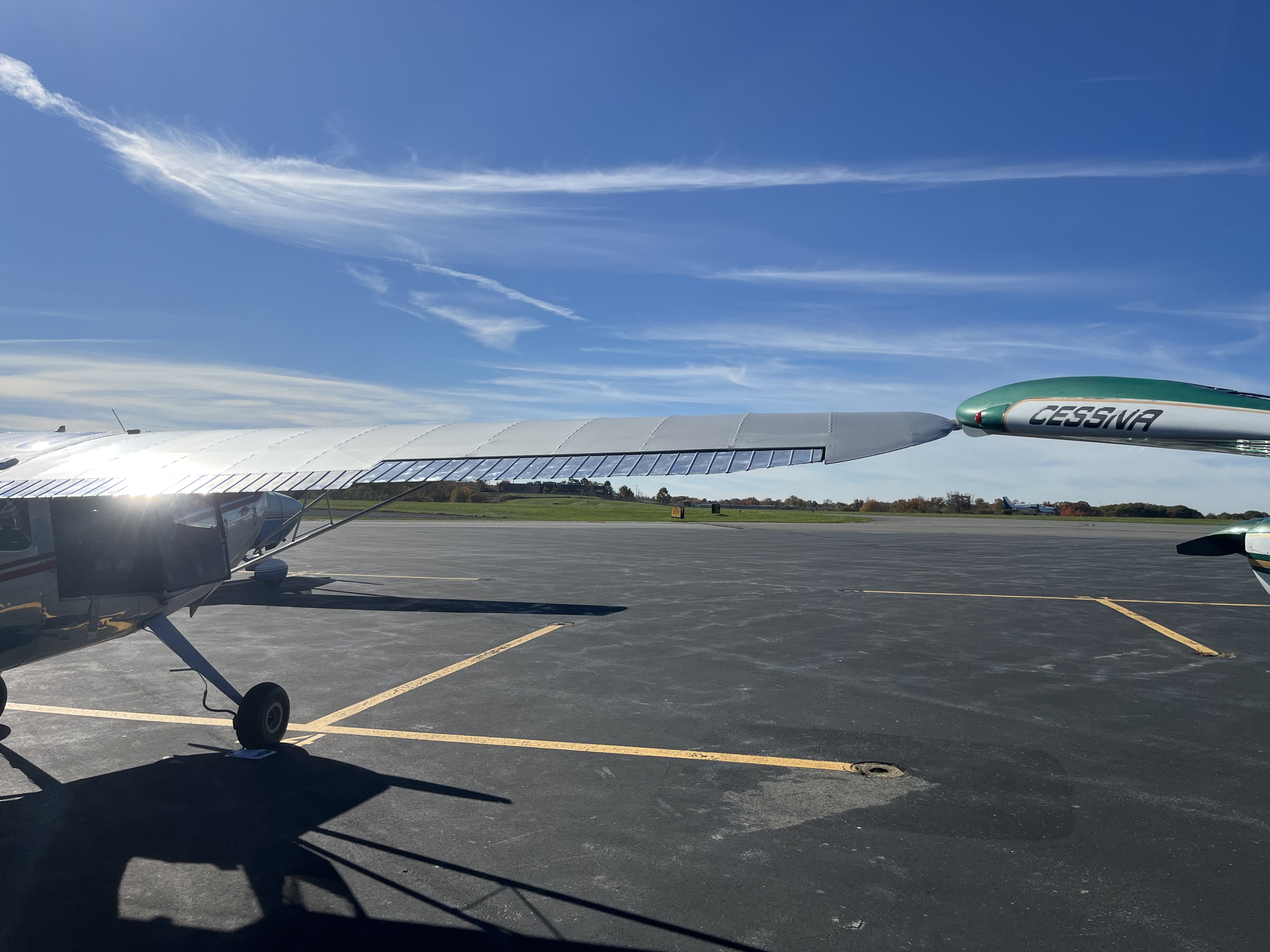

The damage was caused by another plane taxiing into it. A vertical stall strip on its wing hit us at about a 45 degree angle and made the crease. Impact speed was probably something like walking/taxiing speed.
If it is just cosmetic I guess the options are:
1) Ignore it and keep flying.
2) Pound it out and cut to get the surface below the original contour and add a patch over the outside (to AC 43.13). Then add fabric over and refinish.
3) Buy a new tip, strip the fabric back one bay, replace, recover and refinish.

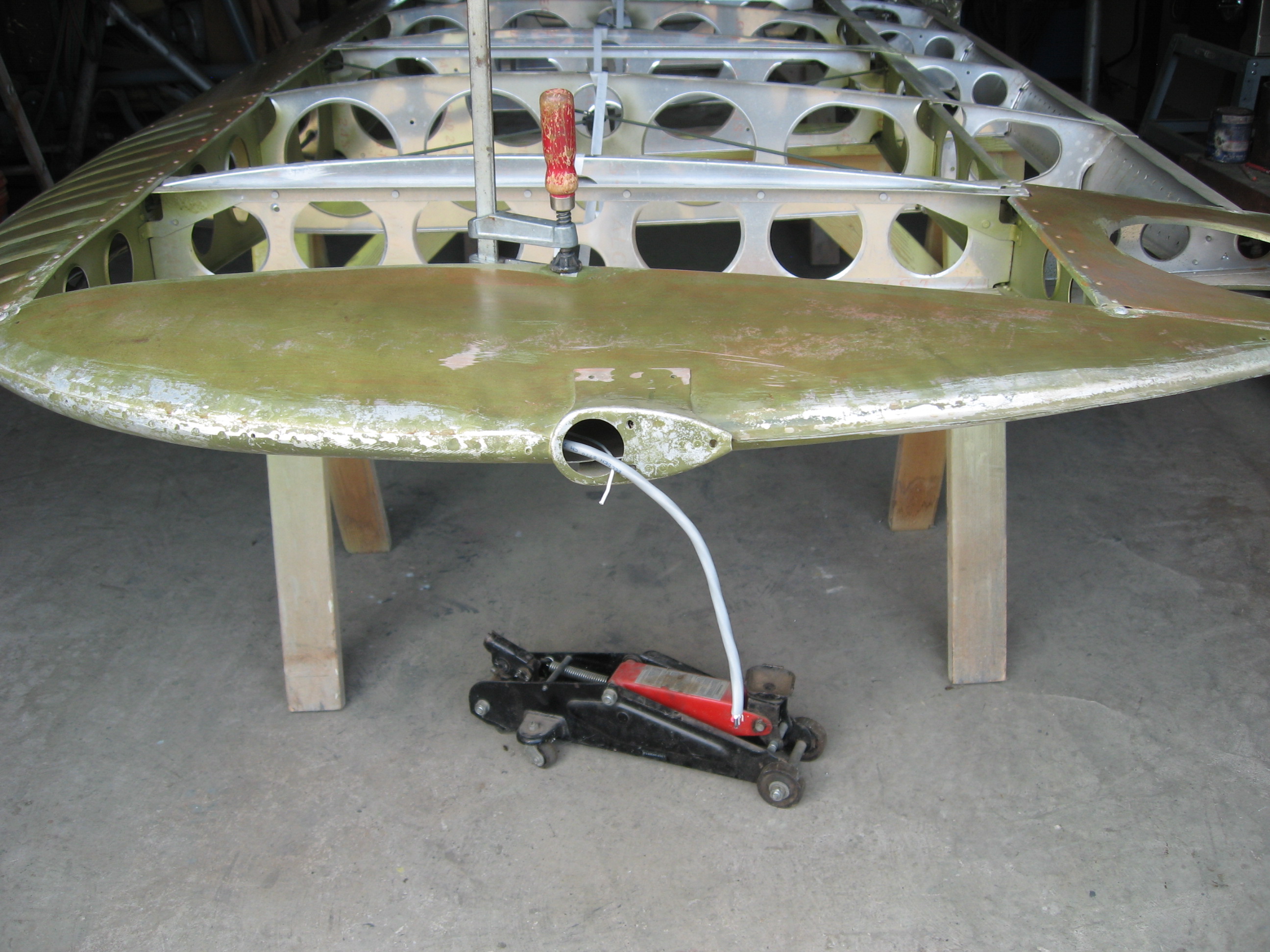

The picture of uncovered wing is old, but shows whats inside. Univair doesnt seem to have the tip part (quick search only).
