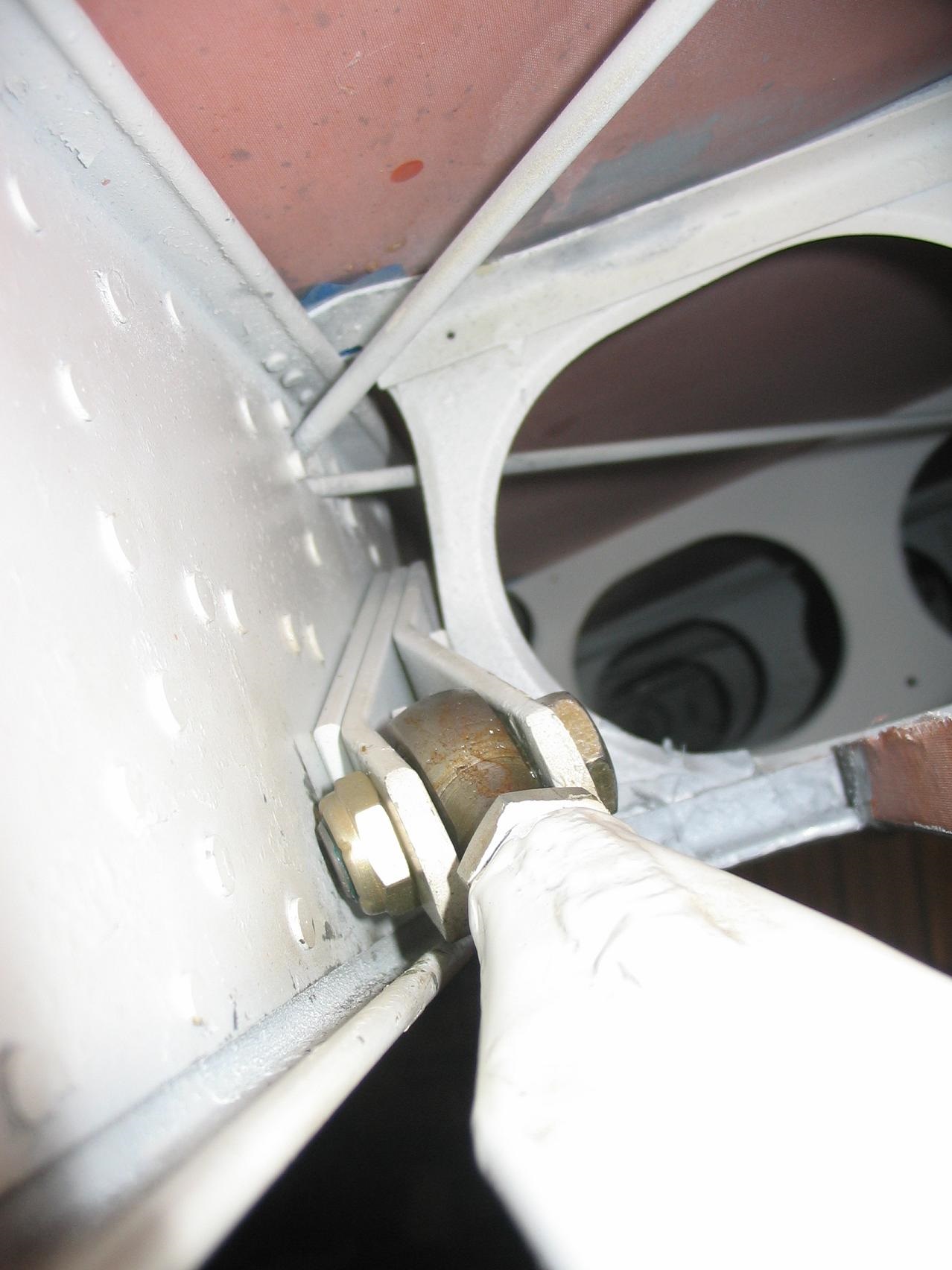

3. See attached photo of rear strut bolt attach, this bolt should not be digging into the rear spar and it's a painfully close fit. The grip of the bolt should remain in the attach arms, don't let bolt thread take the load. Let us know if it's the correct bolt, some past discussion in the Forum on making one from standard AN bolt.

- strutreartierod.jpg (276.72 KiB) Viewed 6236 times
