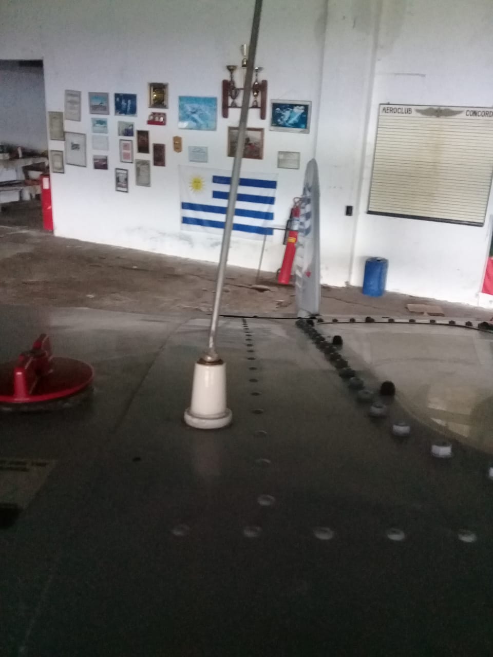

LV-NGL has the same antenna installation that was in place when I got the airplane, twenty years ago. Is time to upgrade.

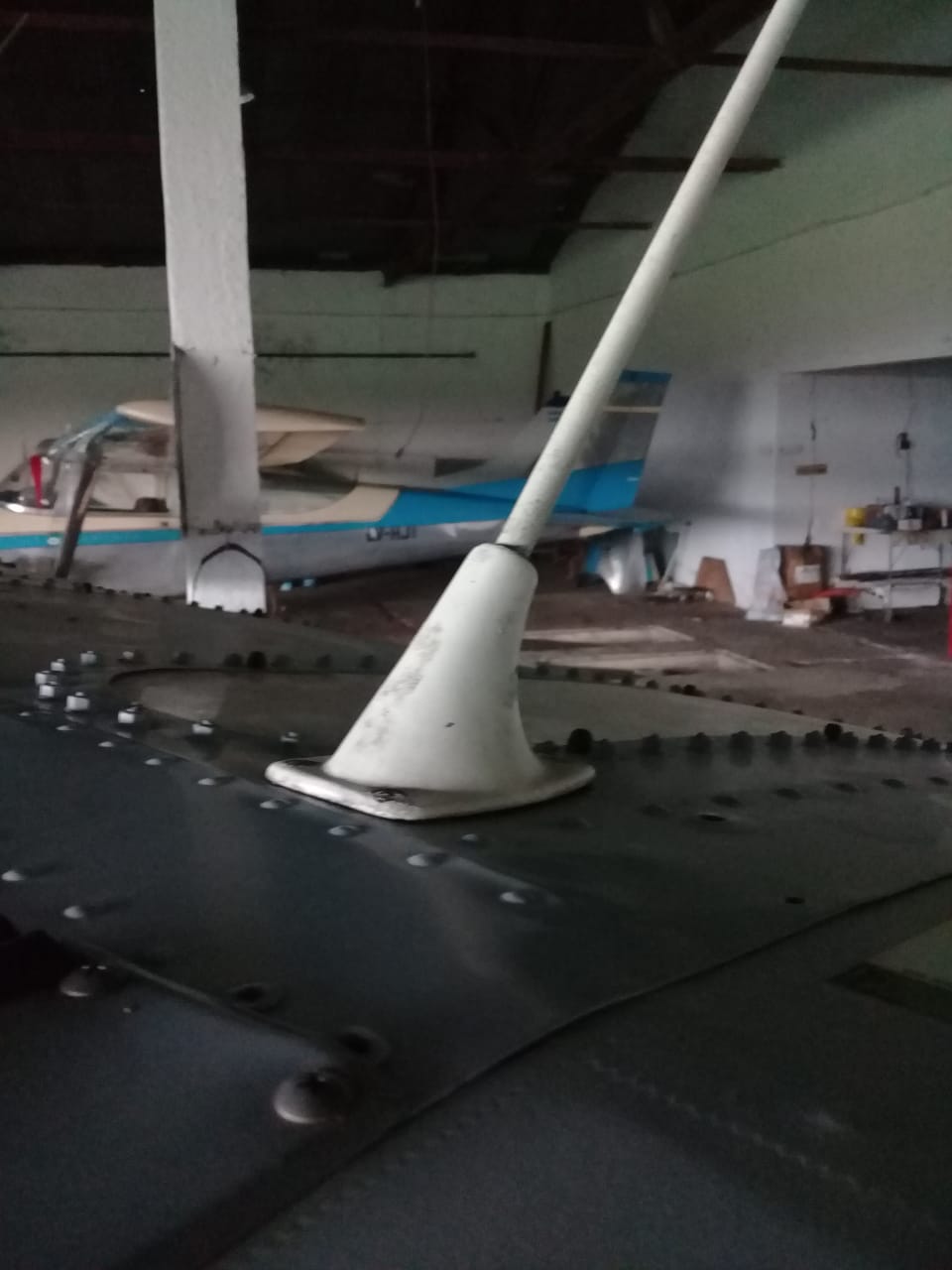

One existing antenna is certified, services the main radio, a King 175, and is mounted via three screws on the left side. See pic OldLeftAntenna.
The second one is home made, services the auxiliary radio, an Icom A21, and is mounted via one central hole and porcelain isolators. See pic OldRightAntenna.

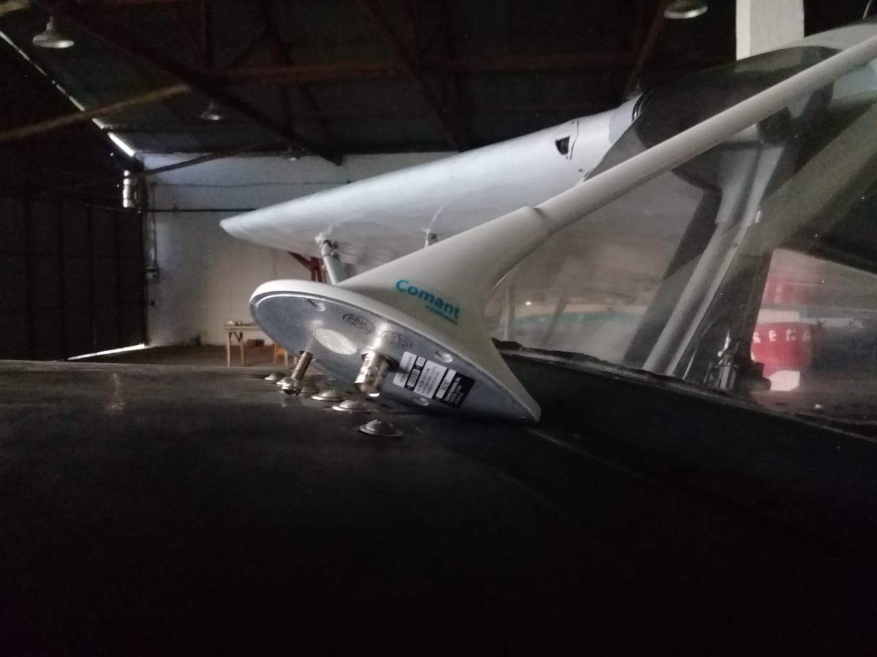

1. Install the new Comant Antenna on the right side, to service the main radio.

When I look at the actual mounting I notice that the left antenna, that seems to be original, is mounted close to the upper window line of screws.
This antenna is locked and serviced from within the cabin.
But the right antenna is mounted, as you can see, some three inches far from that line.
Is unreacheable from the cabin, must be fixed and serviced from the wing, removing the aluminium skin close to the right door.
Now the question is:
To fix the new Comant to the right wing I see two options.
6. Drill the four holes near the place where the old home antenna is now, and service from the exterior of the airplane,
7. Drill closer, service from the cabin, and close the hole of the home antenna some way.
If I proceed as 6, the installation will remain asymmetrical, but one hole is saved,
If I proceed as 7, the installation will remain symmetrical, but one circular hole, about 3/4 inch needs to be closed. How ?

To actually answer your question. I believe that the existing antennas are OK. The performance of the one on the right will be improved with the new antenna. It performs better than the wire antenna. If you can put the three holes where they are accessible between the fuselage and the wing, that will work fine.
