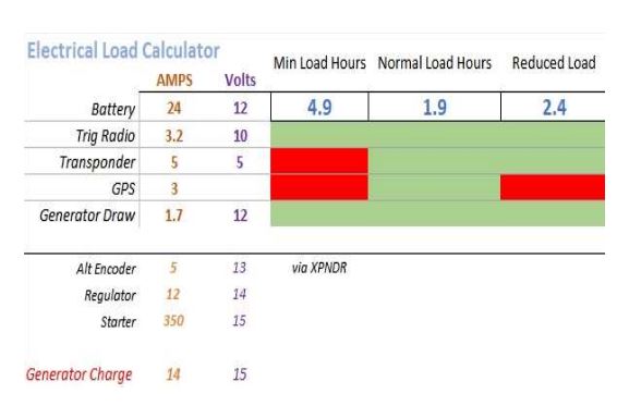

Re: O-290-D Alternator Conversion
I was wondering what my battery life would be in an emergency and did a little calculation of draw on the battery. Generally - once the engine is started - our little beasts don't have huge amounts of power hungry kit. I think that most have perhaps ( if the IPAD / Tablet ) is not connected to the battery something like this - although I am no electrical bod so I may be barking up the wrong tree...
But what ever is the correct answer even with most of the kit on I think am drawing quite a lot less than I thought I was. Certainly enough less to mean that I would have more than enough juice to wait 20 -30 mins at less than the 1000rpm my generator needs to start charging.

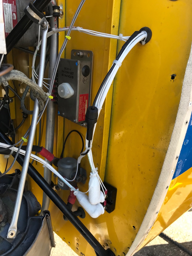

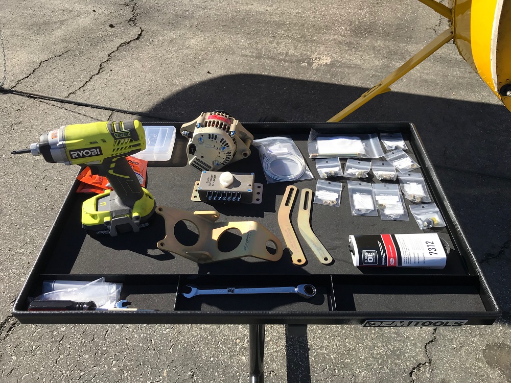

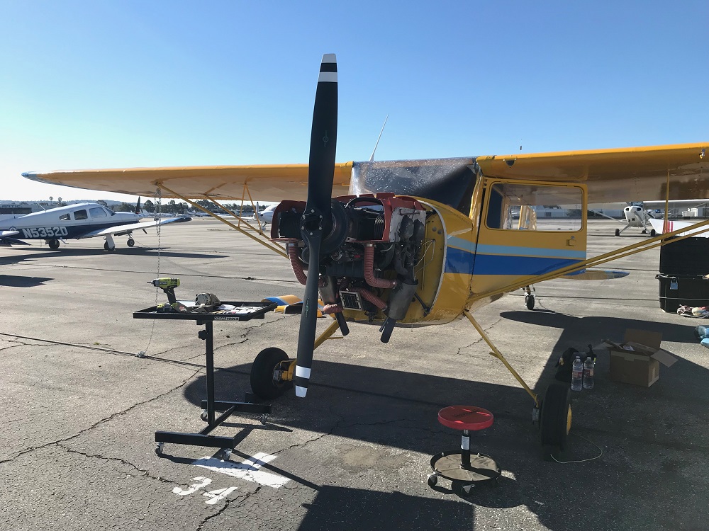

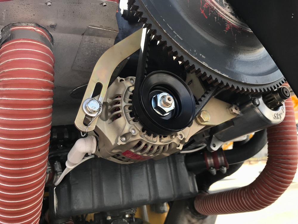

Unfortunately I didn't do as good of job verifying the kit contents before we started. B&C sent us the wrong mounting bracket. However it was close enough to let us test fit and start the wiring. Nothing but good things to say about B&C customer service, they overnighted me the correct bracket an hour before their last UPS pickup Friday afternoon.
Got the bracket on Saturday morning and got it installed, it's a perfect fit with the Sky-Tec starter. My A&P has a little more re-wiring behind the panel to get everything cleaned up, I'm hoping to be airborne again by the weekend! After being grounded for over 2 months this is very exciting for me.

- Posts: 700
Good looking install. Wish I could work out on the ramp.........(well you can, if you're a Polar bear and insulated)
8359
- Posts: 232
- Name: Tamer A
- Location: KSNA
Thanks! It turned out great and I'm getting a rock solid voltage at full load at idle!
I feel your pain, I grew up in Kalamazoo, but don't be fooled by the sun, it gets pretty windy out here, makes working outside difficult. I would kill for a hangar!
