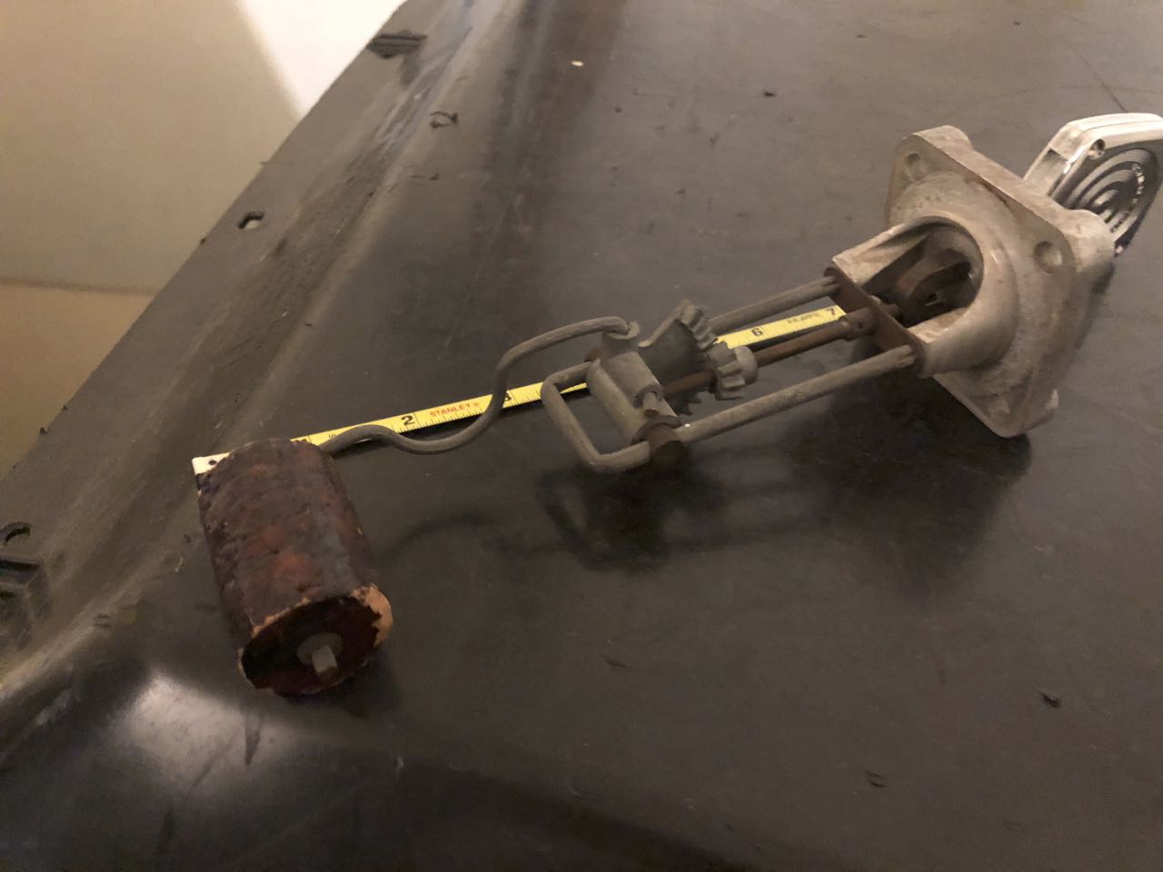

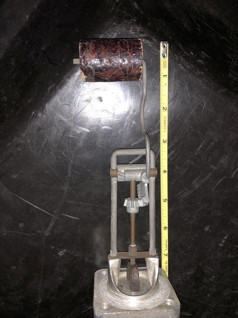

Re: Fuel Gauges
I took a couple of pics of the old ones. I assume I need to mimic this with the bends on the float arms?
- IMG_0422.jpg (81.83 KiB) Viewed 10247 times
- IMG_0424.jpg (185.55 KiB) Viewed 10247 times
David Freeland - CFII
- Posts: 2771
Re: Fuel Gauges
Yes, assuming the gears are the same, the distance from the pivot point to the center of the float needs to be the same. (Looks like 3 1/2")

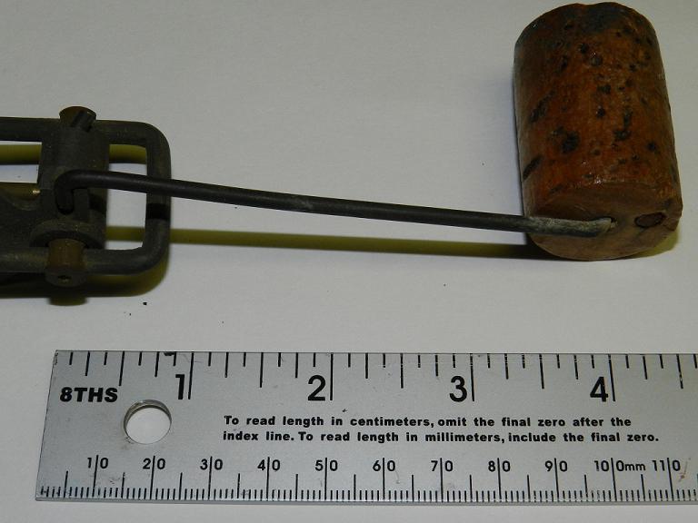

- Posts: 549
Re: Fuel Gauges
About 4" on the example I have
- 2-1-15 067.jpg (63.95 KiB) Viewed 10213 times
