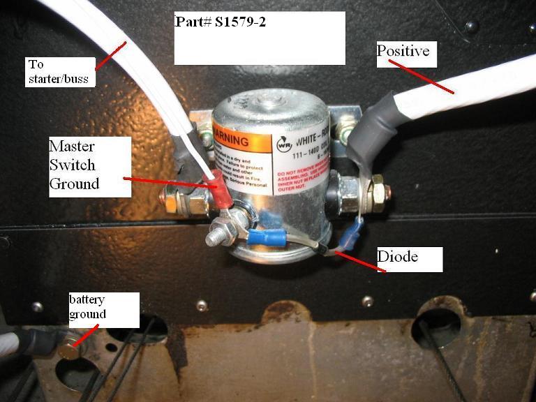

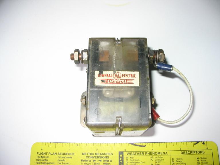

Re: Master switch on but no power
This is the old style solenoid and it's on the back of your battery box, it should 'click' when you turn on the master switch. If you don't hear anything then check it for corroded contacts. It's fairly simple.
- GESolenoid.jpg (44.44 KiB) Viewed 8081 times
Thank you gentlemen. We did that and no luck so we (me and my A&P) have concluded the selonoid needs to be replaced.
Thayne
Thayne
Happy flying.
- Posts: 552
That's what I ended up doing....make sure your master switch ground is working first but it's a pretty easy install for the replacement.
- solenoidnewSmall.JPG (69.81 KiB) Viewed 8073 times
- Posts: 2775
Me too. After all, the original is over 70 years old...
