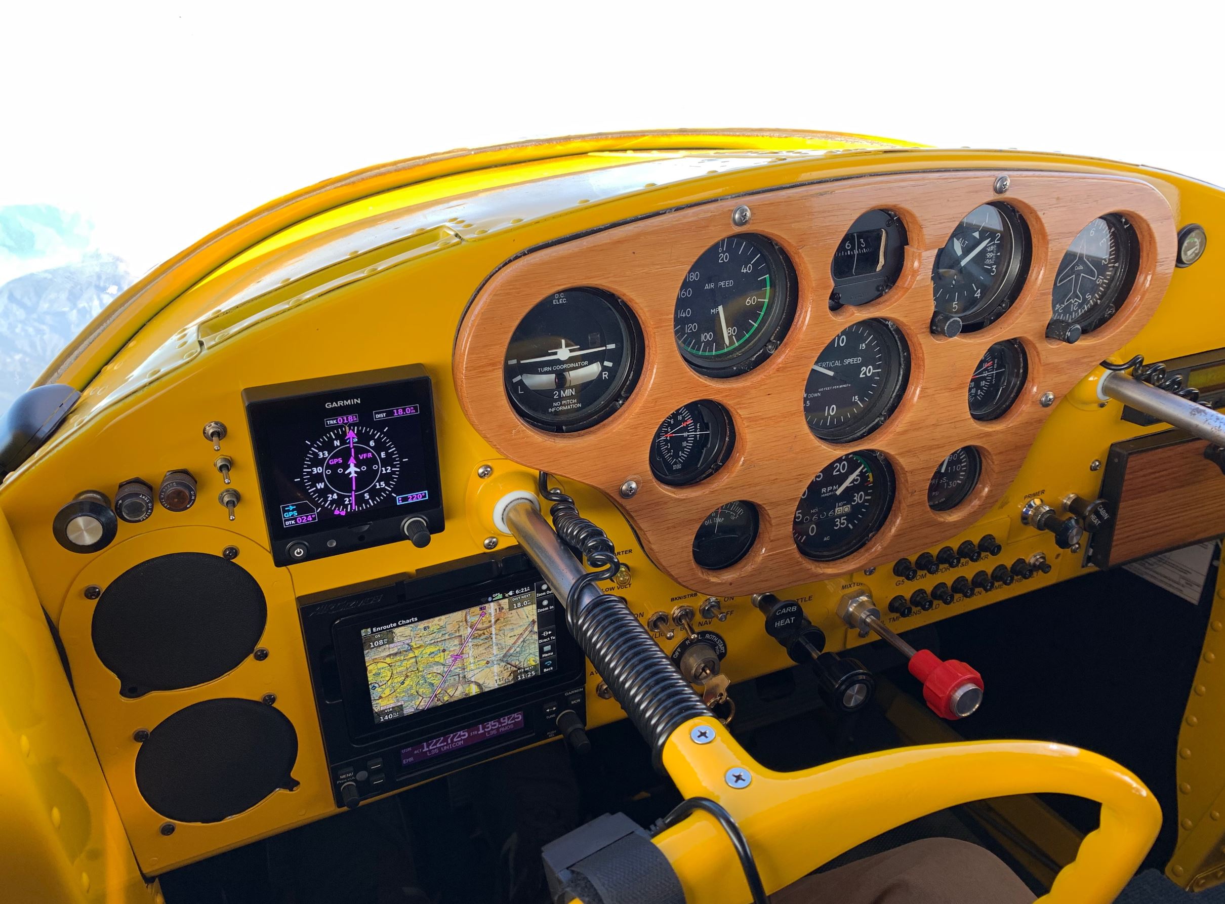

I kept the velcro switches, just wrapped the coil around the yoke shaft then behind the panel. It works great and keeps the wire from dangling all over the place.
I recently installed a GTR200 and just cut the wire and wired the PTT switches directly to the radio. Easy peasy. Here's a photo of mine:
viewtopic.php?f=7&t=496
viewtopic.php?f=7&t=638

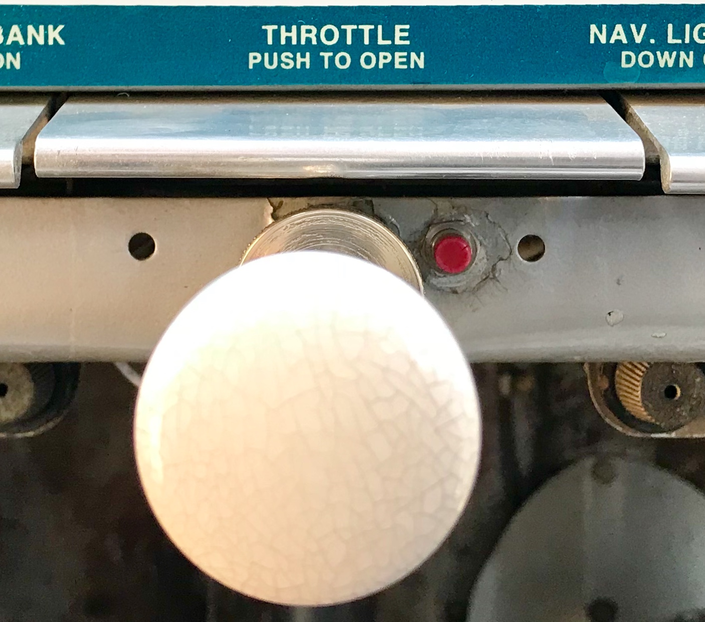

The little red button.
Randy Thompson A&P IA Pilot
Overhaul small Continentals
6298

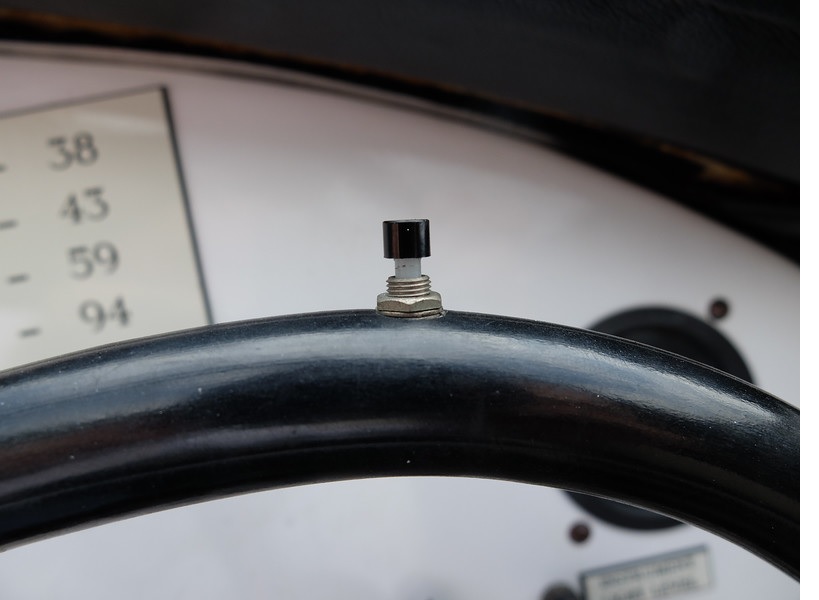

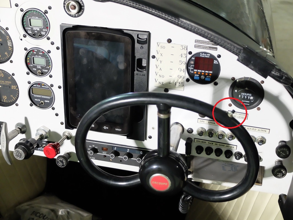

Re: Push To Talk button location
I posted a picture. Took me a while as I had to downsize it a few times.
