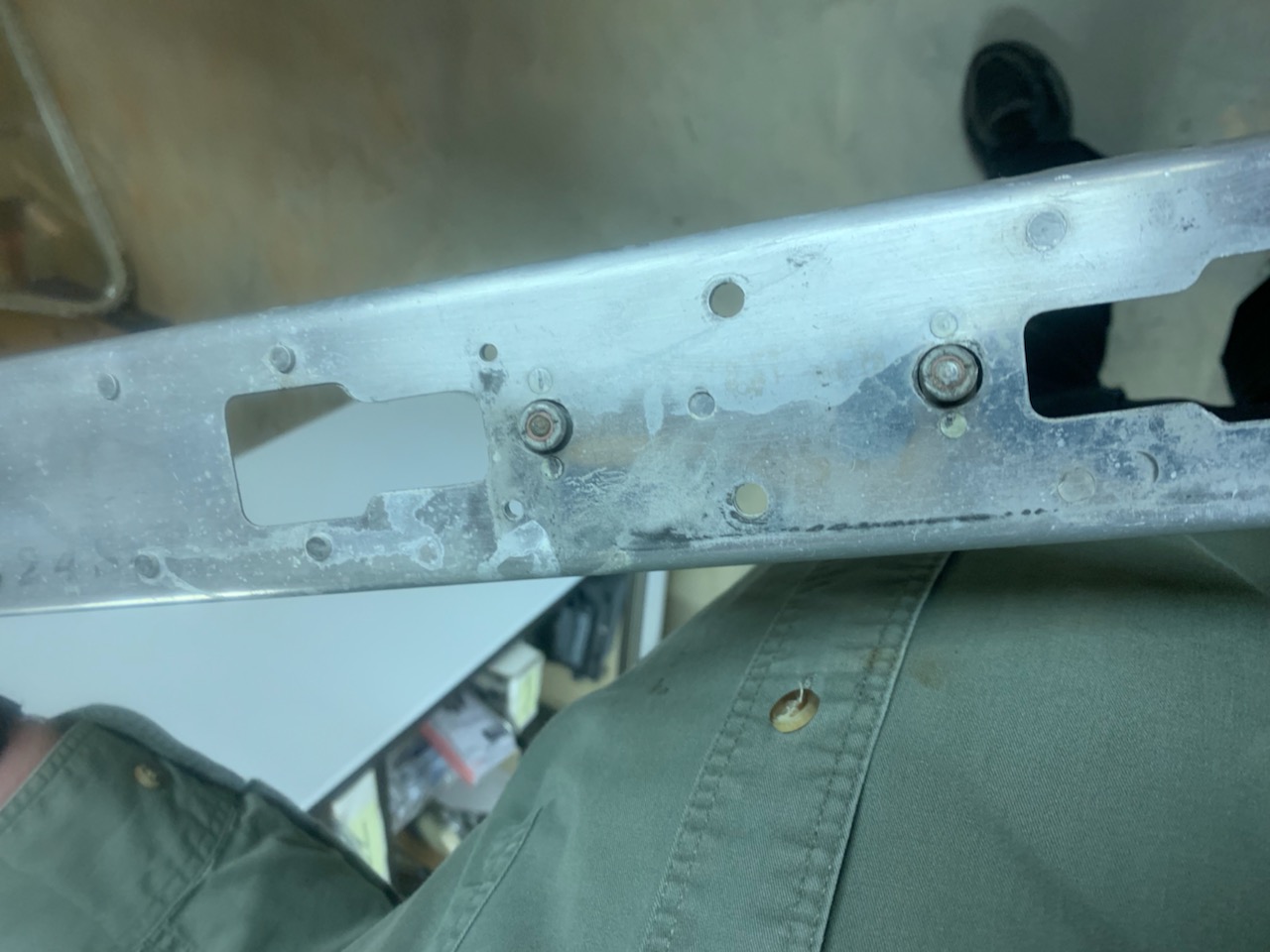

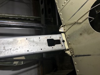

Top one should be accessible with the faring off. Bucking bar through the hole the bell crank ends go into for the bottom one, or, remove the fin and they're both accessible.
That said, I don't see why cherrymax rivets wouldn't be acceptable, if you can stand the ridiculing...

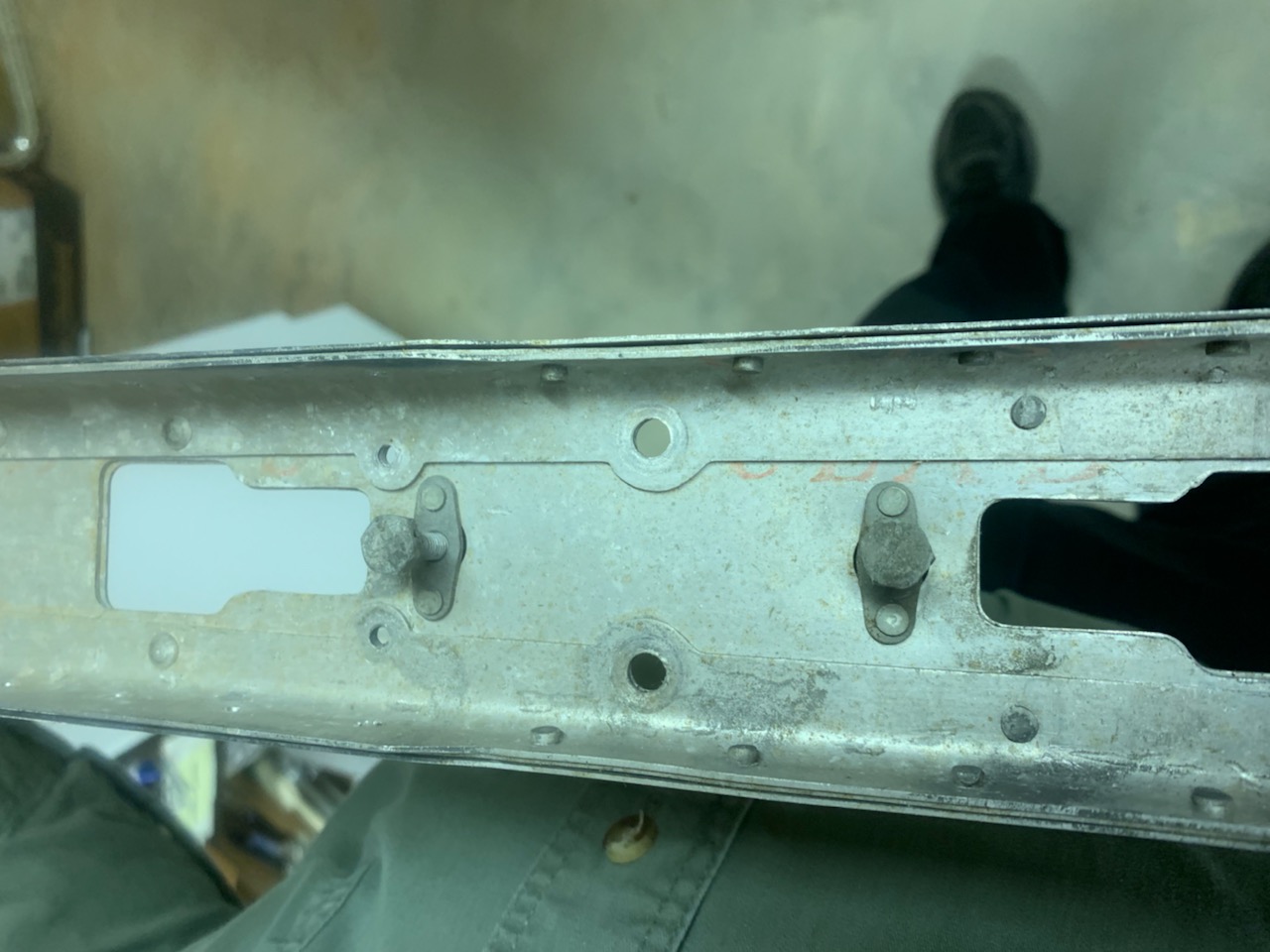

Hey everyone, wanted to followup since it's been a week.
First off, thanks so much to everyone who responded, I'm constantly amazed at how helpful the folks in this group are!!
Last Wednesday, I completely removed the bolt from the up stop so the only thing left is that nut plate that's turned backwards. I now get 15 degrees of up travel on the elevator. It's obviously not book-spec, but it's enough to land tailwheel first. I'm probably going to leave it that way until annual since the rudder will have to come off to remove and reinstall those nutplates. The heat has finally broken here in NC, so it's time to go flying!

Re: Elevator up-travel
Now that you have the problem nailed down, you really need to fix it correctly.
The rudder comes off very easily and the fix will not be hard at all with a rivet squeezer.
I would replace those nut plates with new too.
A couple of hours work and it will be as good as new.
