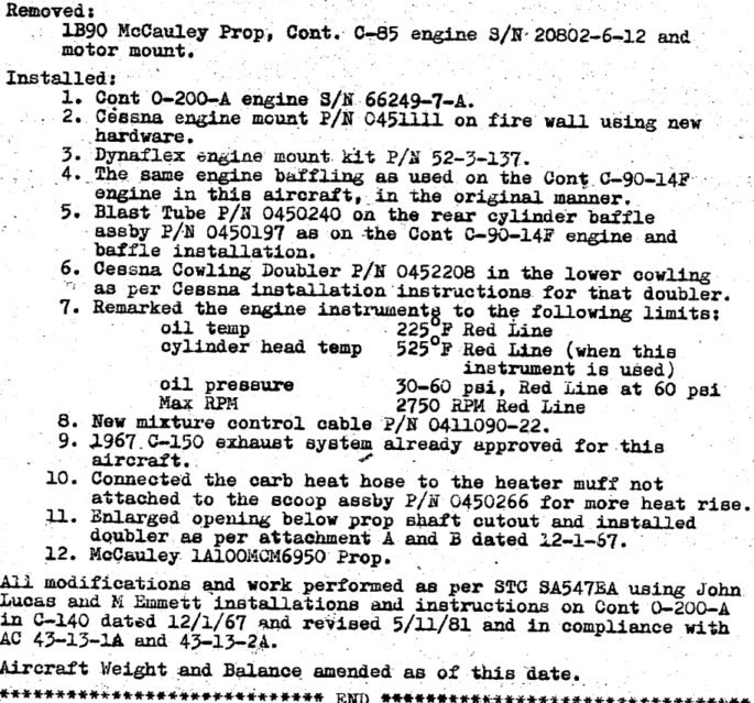

The old 0-200 STC on my bird has a similar requirement for 225F
Lucas Emmett 0-200 stc.jpg (147.68 KiB) Viewed 5971 times
That being said the TC does have a notation for the higher temp. I believe the STC rules....

Steve and David, thanks to you both. I hadn't considered checking the O-200 STC, but I will. The 225 red line on my temp gauge now makes sense assuming that's the case.
