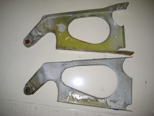

Can anyone provide a picture of the old 04223142 aileron support rib to compare with the newer 0422200-3 rib? No record of my ribs being changed.
Posts: 2775
Re: AD47-43-06 again
The broken one is the early one...

Thank you. Looks like I have the newer rib. It does however have a crack that was previously stop drilled in the curved reinforcing flange in the arm going down to the hinge.
