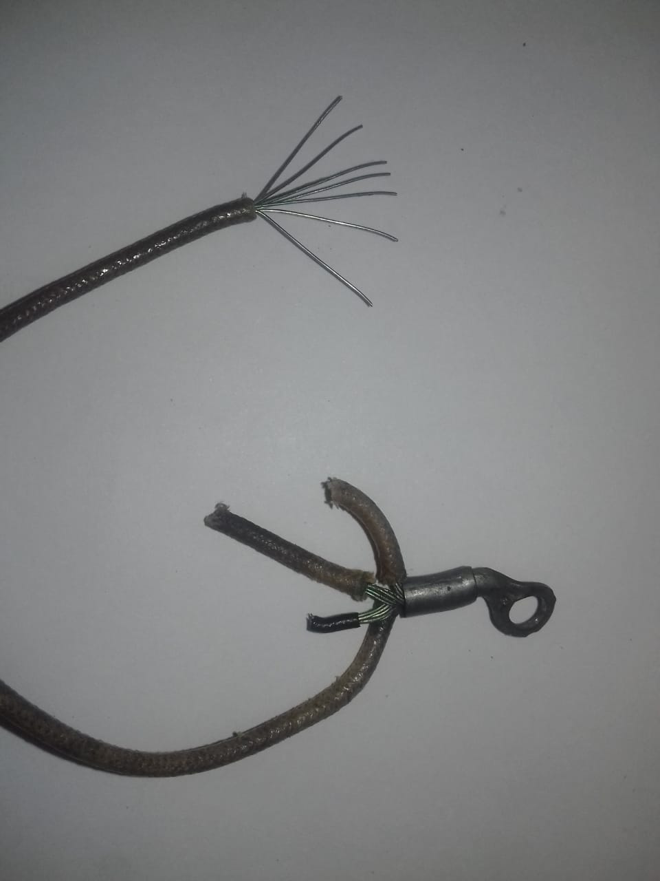

Re: Re-wiring wings
Hello Jason,
I found the box with the cables that have been removed and marked for reference.
I attach a pic of the terminal that was connected to the NAV Lights Switch.
You can see the 4 cables connected. Two for R and L wing Wheelen lamps, one for tail lamp and one for the two small lamps in the panel.
All cables are old cloth covered. Strands of 7 wires, each 0.40 mm diameter.
The cable had 0.8792 mm2 cross area.
That is very near to a 18 AWG, that has 0.823 mm2.
For my rebuild I selected AWG 16 in this wiring, using MIL-W-22759/16-16 from Aircraft Spruce,
Have a nice day,
Have a nice day,
- navLightsCable.jpeg (42.16 KiB) Viewed 4518 times
